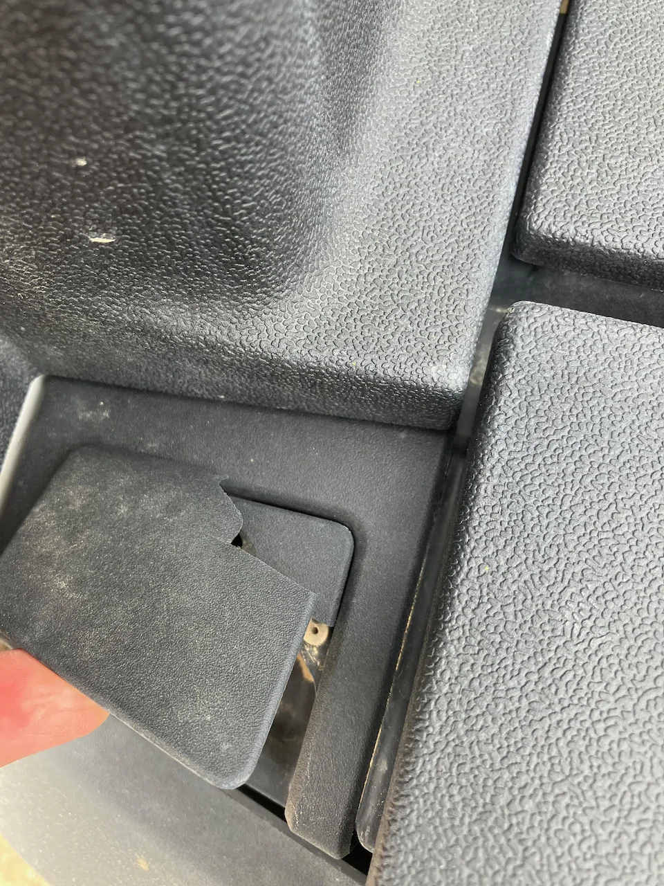

In my case the latch would not operate or budge in the typical motion.
I'm certain the latch does not operate to directly push the lid, but rather to pull a cable-actuated mechanism that would release lid-latches (or some such).
That being said... shit broke when it shouldn'ta.

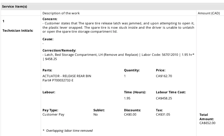

Well, I have an update so I'll post it for those still following and interested.
I went in for my drop off appointment hoping Rivian would have approved the warranty repair, but they had not. My service rep was apologetic and offered to significantly reduce my out of pocket expense on the repair - total cost would have been $250 or so; down from $650.
He also explained the service was extensive, requiring removal of rear bumper and significant rear-end disassembly to access and replace.
To me, it seemed the wrong decision to move forward with the repair, considering the replacement latch handle would just snap in the cold again (likely) and the underlying issue of frozen mechanism would not be addressed or investigated since it's warmed up (above 0 C) now.
Also, I have fear of causing more issues by disassembling factory work during the repair. Mis-alignments, rattles and other unforeseeable problems will suck my time and patience.
In the end, I offered to bring the Truck back when the temp drops again, should Rivian wish to investigate (on their dime). I explained (in email) that my hope was for Rivian to provide me with a warranty repair for the latch when they can approve it, but in the meantime I will continue to expect that my hatch is inaccessible in cold weather, given all I've learned.
For the time-being I'll opt for needle-nose pliers or custom repair solution (credit card-fix??) and keep my $250 on principle.
