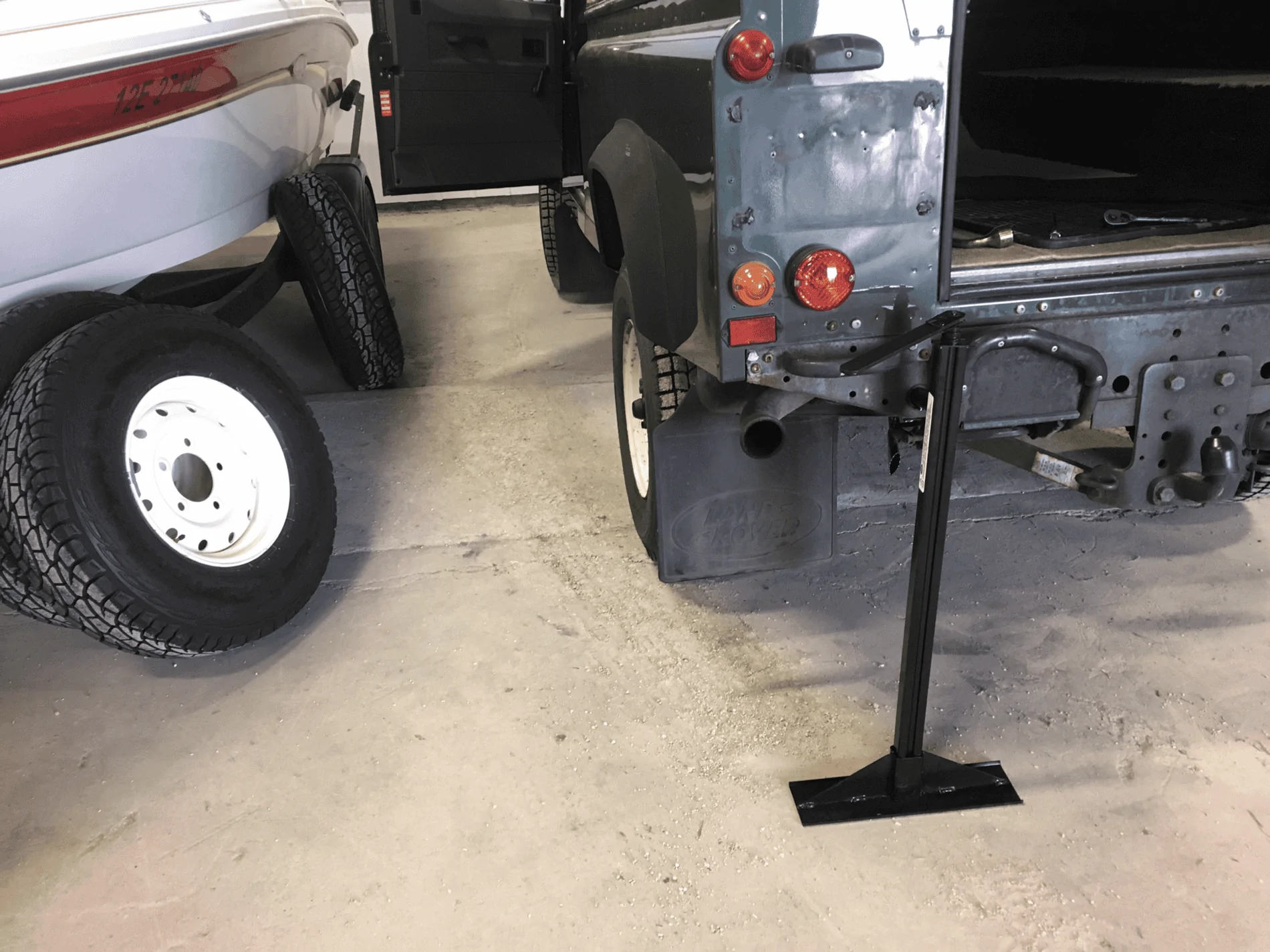

as far as I am aware the rivian suspension is hydro pneumatic, like Citroen, or more recently Mercedes ABC. Allows control over each wheel.
There are airbag jacks for the offroad community, I had one for my Xterra. They typically inflate from vehicle exhaust, but that obviously won't work with the Rivian. One with the ability to connect to an air hose seems feasible. The major downside would be time to inflate (they are large volume) and that they take up a lot more storage space than a manual jack.
Not like the giant balloon-like exhaust gas filled ones.
This kind:

Pneumatic would be nice, but having a manual mechanical jack is still a must, imo, as the onboard air could fail.
This is my concern, too. If we’re off-road and without mobile phone coverage, I don’t want a compressor issue to leave me stranded. Our Land Rover has a notoriously-bad scissor jack so I keep a bottle jack in our off-road kit.
if Rivian had a jack which could be used to raise the vehicle manually or as a stand when used in conjunction with the height-adjustable suspension then I’d be fine with that.
