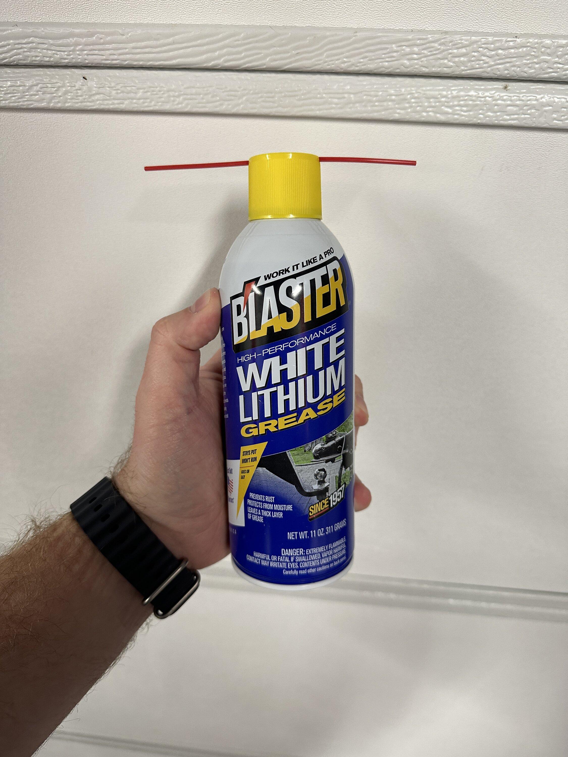

It flaps in front of the radiator. Below painted part of the bumper. When the car is asleep they are closed when the car is turning on - they are opening. I had the same issue but it was crazy louder. I put some lubricant on the corners of the flaps where they are moving and no more sound.

I had the same issue deciding what to use... After checking the garage’s cabinets found this.
