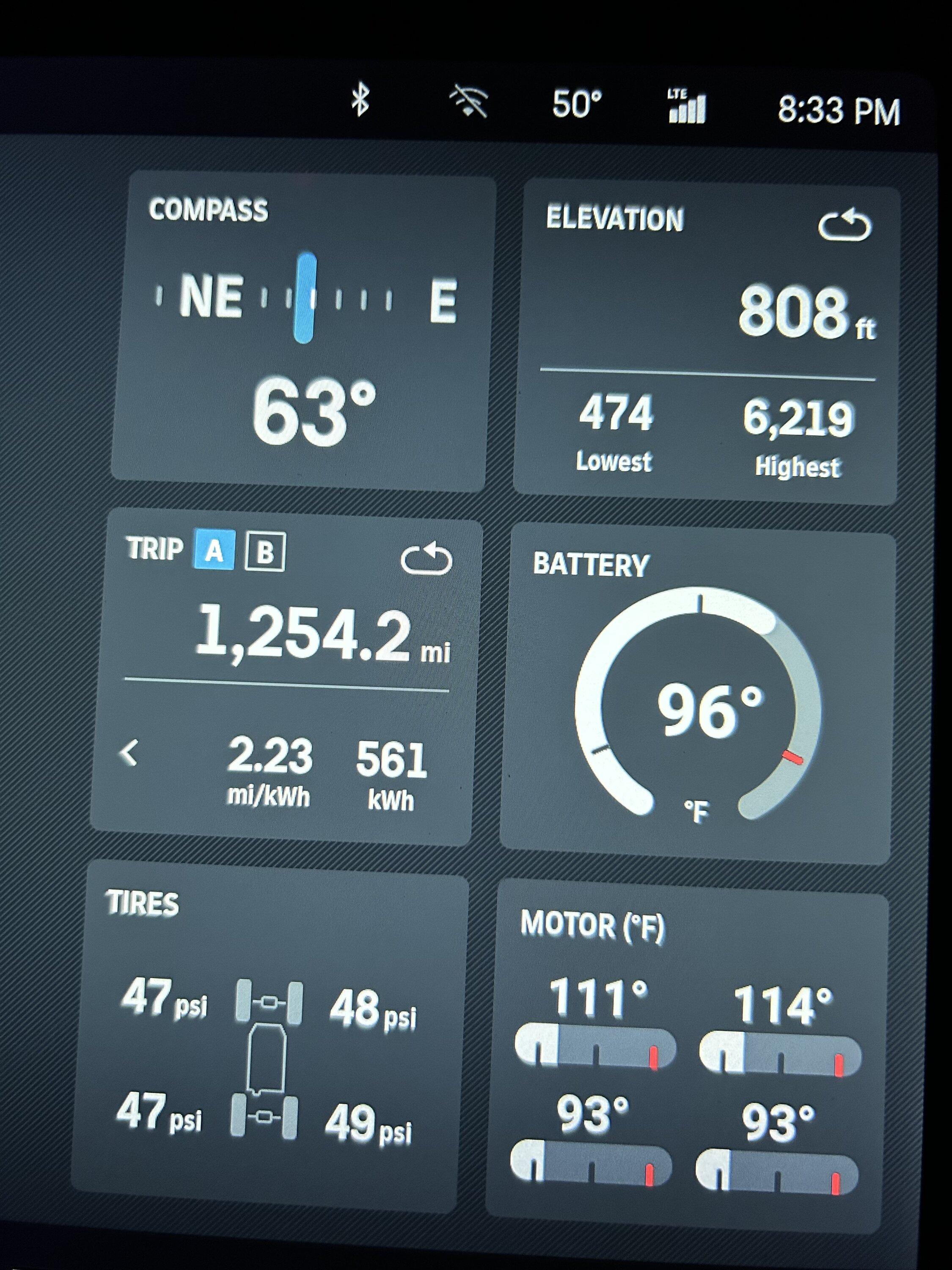

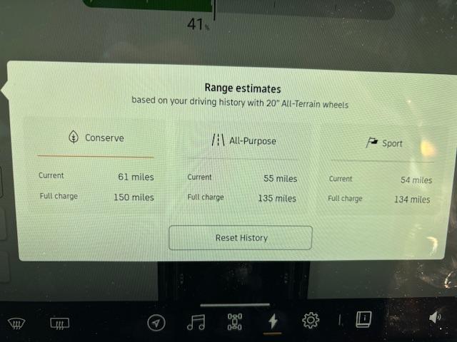

Our battery capacity has dropped in half as measure in miles at full charge in all drive modes on our R1S. Purchased in Aug 2023. Last 5 numbers of VIN 13736. Large Pack battery. Quad motor. So battery capacity is nominally 125 kw. We have all recent vehicle updates complete.
We noticed the problem since about Feb 10 in around town driving. We had to home charge each night instead of every couple days.
Now we are on a road trip with good weather (50-70 degree F), no wind and pretty flat on Interstate 90 from SD to IL. Going 65 mph. After 810 miles of driving our Trip A records 2.23 mi/kw in Conserve mode. This should translate to around 275 miles of full battery range (which we have achieved in similar conditions on past trips).
But, we get only 150 miles when we charge the battery to full amount. We switched to All Purpose for about 50 miles and didn’t see any difference. So we are stopping every 120 miles to charge up to 70-85% which gives us only around 125 miles range.
We called Service and tried to reset History on Energy screen tab, soft reset, hard reset and sleep cycle of 5 hours. Still have the problem. We do have an appointment with Cincinnati Service Centwr on March 5.
So basically getting good efficiency but limited range. Any help or suggestions our there??

Would be helpful if both of you could post photos of what your seeing in the trip screen for efficiency, energy screen estimated range, energy screen tap drive mode will show estimated range on full charge, and what shows in the RIDE menu under BMS. It would be helpful to anyone else who may encounter this issue.

Take a look at a screen shot at the end of road trip last night showing excellent efficiency. And a screen shot of the estimated full range for all modes. Our range had been 305 miles for Conserve mode and 275 mile for All Purpose in the past but no screen shot. (We sent to SC). We didn’t do the RIDE screen since service appointment is close and we will see what they find out. (And we are chicken!)
Thank you for this. This is definitely to be an educational post for sure. I know you're on a road trip, but if you get a chance to go into the ride menu I will be really curious to see what the BMS dashboard says.
Also, are you seeing any power limitation once you've used about 3/4 of the range? Once you get below 10% remaining it should show you limited. Acceleration in the dryers display. If you truly have only half of your capacity available then you should see that at a higher state of charge I would think.
You would need to put it back in all purpose mode though because the conserve mode will always show limited power due to the two-row motors being disabled.
