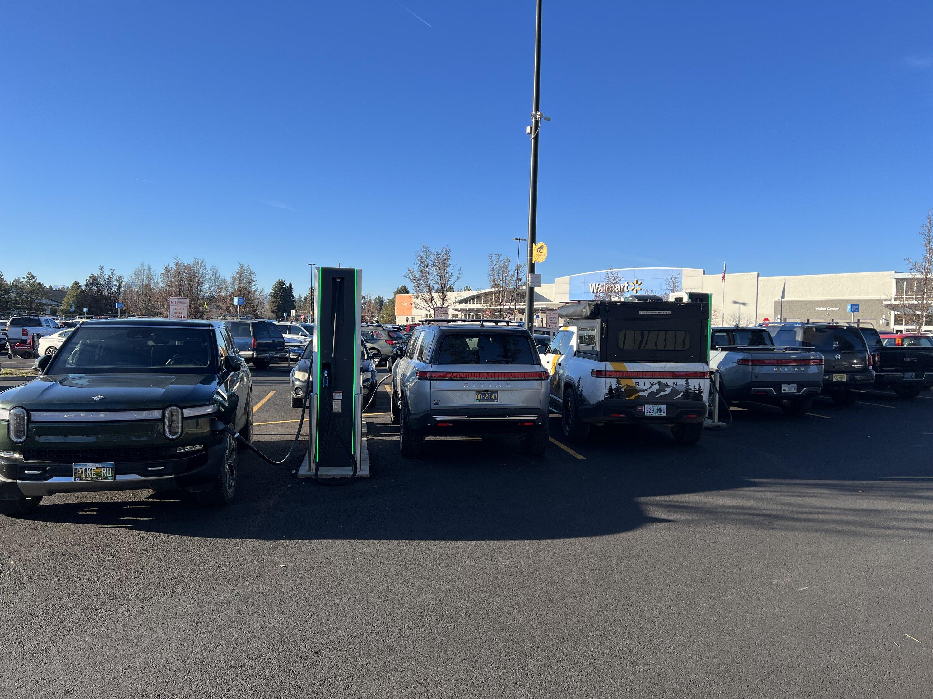

I left it for 2 hours and did a hike after warming up it started coming to life and was fixed by a full reset. And I made to the EA station in Bend just in time for a Rivian party.

Yeah that is my take, something was frozen as it wasn’t even releasing air so probably a frozen valve.
Was there Saturday morning! Of course I had to call EA to reset the one available charger. By the time that happened my battery had cooled down and got crap speeds. Luckily had to go north so I just went to the RAN in Madras and which is awesome.
Yeah I got a decent charge there Saturday afternoon on station 3 but today I pulled in last and got stuck with 4, it was giving me a solid 19kW but eventually ramped up to speedy 40kW.
I am generally pretty happy with EA but this station in Bend is a disappointment, I was stoked when they got the new chargers but even so they haven’t done well to maintain them. I see they have a second coming soon station at the Target in Bend and also one looks very close at the Safeway in Madras. Maybe they can actually hire someone to maintain these now that they have more in the area.
