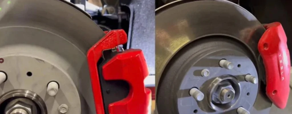

ZEV Centric, a company building accessories for Tesla vehicles, spotted and exposed the change.
The company was working on some customers’ Model Ys and some of their own Model Y vehicles and discovered the downgrade:
We already have a 2020 MYLR and a 2022 MYP that belong to other members of the company and now have added a company owned 2023 MYP to further develop. We brought all 3 into the office to do some comparisons and a quick tear down. It was at this time that we opted to snap some photos, shoot some video, take some measurements, and reveal what is hiding behind the rear covers. Little did we know that not many people were aware of this downgrade and Tesla still markets it as a performance upgrade on their website.
The Performance upgrade on the Model Y brings a rear Brembo caliper and a 2mm thicker rotor with additional venting features.
The company spotted this around September when Tesla started to replace that Brembo caliper (right) with a new Mando brake (left):
Rivian R1T R1S ?Tesla Clandestinely Downgrades Performance Brakes, Uses Plastic Covers to Hide it.? Screenshot-2023-01-16-at-2.14.24-PM
The company now says that the rotor is 2mm thinner with the downgrade.

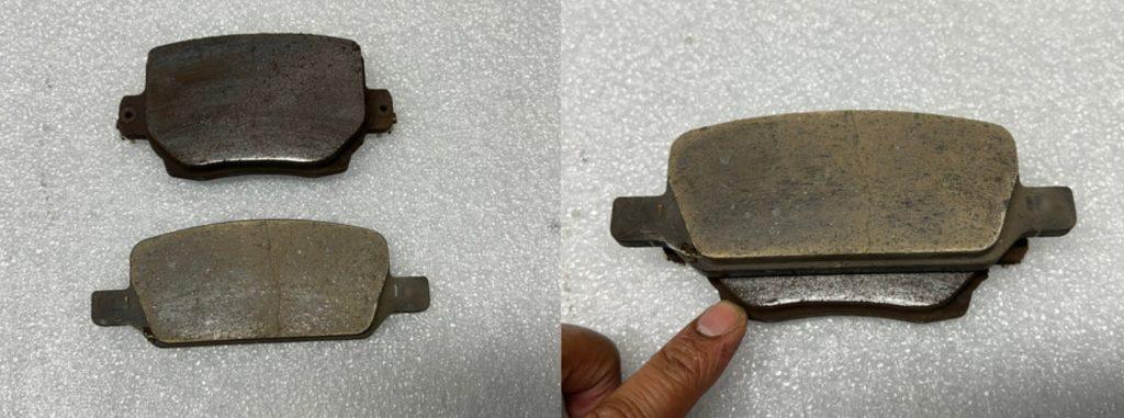

Here’s also a comparison of the brake pads on both calipers, which clearly shows the Brembo to be more significant in size:
Rivian R1T R1S ?Tesla Clandestinely Downgrades Performance Brakes, Uses Plastic Covers to Hide it.? Screenshot-2023-01-16-at-2.18.00-PM
ZEV Centric, who are brake experts, believes this is a significant downgrade and believes Tesla should provide them with the Brembo brakes since the change was not indicated on Tesla’s Model Y configurator.

For others that come across this Thread, like I did, allow me to weigh in on the Great Tesla Brake-Caliper-Cover Scandal of 2023.
In 2023 Tesla took a lot of heat online for surreptitiously installing arguably deceptive covers on Model Y rear brakes. While I can’t comment on Model Y specifically, here is what I believe happened with Models S and X. I suspect the stories and lessons to be learned are similar.
  • From first introduction, regular retail versions of (Classic/Legacy) Model S and X used the same front brakes and the same rear brakes, except that “performance” versions received calipers painted red and “long range” versions got calipers painted gray. Functionally, all the front brakes on both models were identical and all the rear brakes were similarly identical.
  • Originally, Tesla Models S (2012) and X (2015) came with four powerful (4-piston, I believe) Brembo (Italy) brake calipers. (Front and rear Brembo brakes were similar but slightly different. Rear wheels also received separate, smaller Brembo parking brake calipers.)
  • From late 2016 onward Tesla switched to Mando (South Korea) rear brake calipers on Models S and X.
    • Mando rear brake calipers:
      • are more compact in shape,
      • function differently and are perhaps somewhat less powerful, and
      • include built-in parking-brake servo-actuator motors.
    • Tesla probably switched to Mando rear brake calipers because:
      • Rear brakes need not be as powerful as front brakes.
      • Mando brakes are probably less expensive than Brembo brakes.
      • Mando calipers conveniently combine driver-actuated braking and parking-brake functions in one unit.
      • Other premier auto-makers (e.g., Porsche, Rivian) also use smaller rear brake calipers.
  • After March 2021 “Refreshed” Models S & X received similar, but updated brakes, but the patterns continued.
  • At some point (~2023?) rear performance (red) (and possibly rear non-performance gray) Mando brake calipers started receiving bolt-on caliper covers or logo-plates that were in outline similar in shape and size to elongated front Brembo calipers. Why? Speculation:
    • Possibly aesthetics. They arguably looked better and more symmetrically in-sync when combined with similarly-sized/shaped Brembo front calipers (especially at speed when painted calipers are highly visible behind spinning spoked wheels).
    • Possible camouflage. They arguably hide the fact that rear calipers are not the same or as powerful as front calipers.
Subject to its different timeline and less expensive design, I suspect that this story is otherwise similar to what happened with Model Y (2020 -->). Is all this “wrong,” or does it introduce engineering-design issues?
  • From an engineering standpoint there is probably little or nothing wrong with using smaller, less powerful rear brake calipers.
    • Other companies do the same basic thing (with different-sized front and rear disk-brake calipers).
    • For the sake of economics and business survival, auto-makers are expected within reason to adapt and to select parts that while adequate functionally are also cost-efficient.
  • But from a public relations standpoint, it may have been less than intelligent.
    • “Hiding” the smaller Mando brake calipers behind larger camouflage-like cover-plates was probably a public-relations blunder.
    • Clever PR staff could and should have alleviated any objections and even turned the rear brake-caliper change into a possible advantage, but clearly failed to do so.
