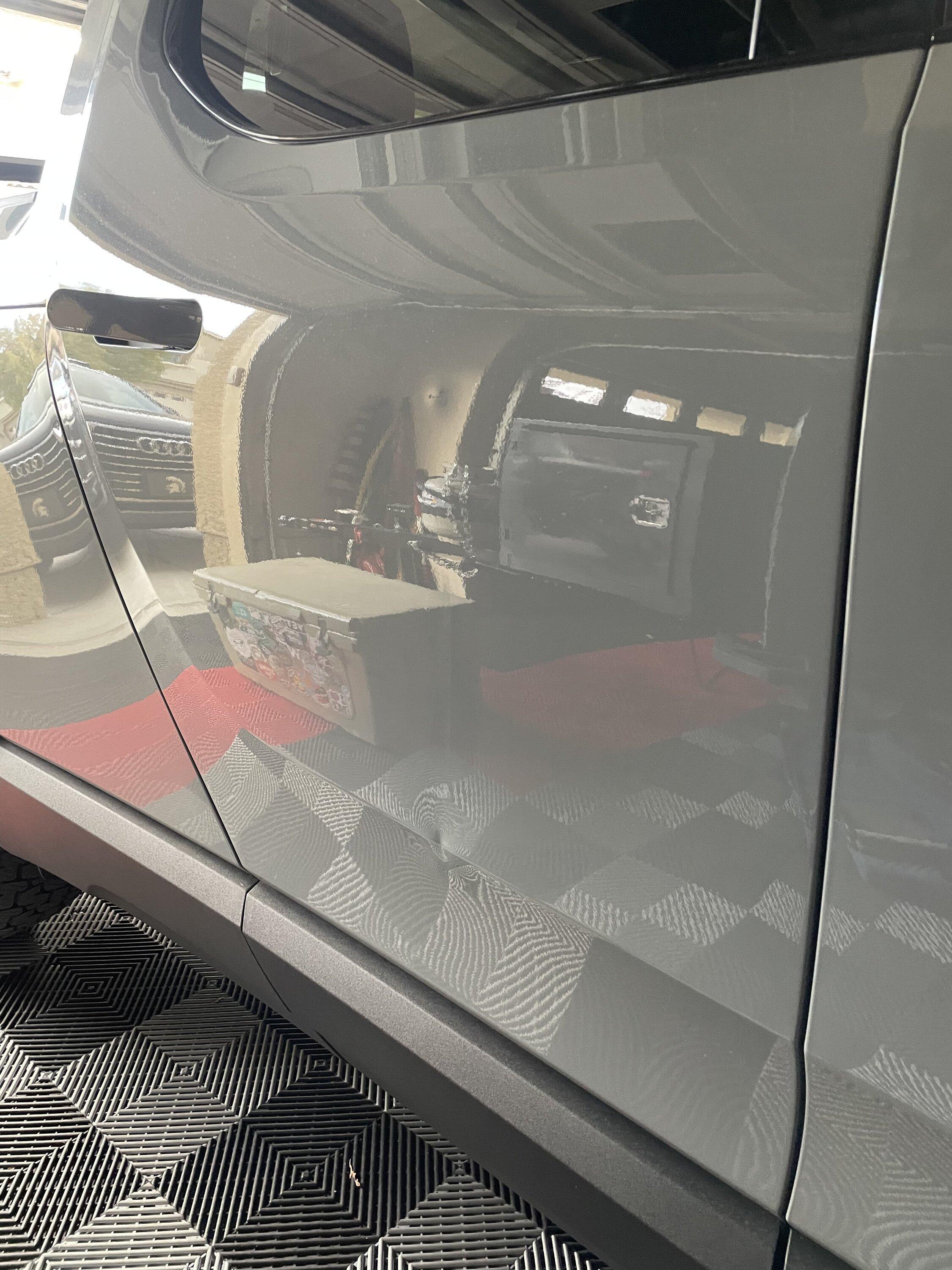

Do the body panels seem weak to anyone else? Two Rivians in I’ve noticed some slight oil canning but even worse actual subtle impression dents in the doors and door sills. This is on brand new or nearly new builds and in spots where incidental contact isn’t likely.
They definitely don’t hold up well to door dings
It strikes me as absolutely stupid they make that ridge the most prominent part of the door instead of extending the black cladding to catch a door before it hits there. Every other truck maker figured this out with where they put their sideboards.

The internet doesn't have too many examples of oil canning on new cars, mostly restorations or metal roofs. But, it's a rippling effect seen easily on large flat surfaces.
Does the R1 have weak metal? I'm not sure. I went and compared panels to other cars just a moment ago. It's not obviously weaker. I also remember long panels on my RAM seeming more flimsy. In any case, I have minor oil canning on my doors, especially the fronts.
It is definitely much weaker than BMW X5. I can easily feel it by pressing on it.

Yeah, figured it would be hard to hit it out of the park on the first go. A lot to take back and fix over the next year or two.
I'll add my vote that the panels feel shockingly thin compared to EVs made by the older OEMs. I babied the gear tunnel doors after seeing someone accidentally dent theirs with their hand.

FWIW- I've had quite a few EV's since 2012: A Plug-in-Prius, a Volt, a Bolt, a Model Y, a Model 3, a BMW i3 and the R1T. By far, the R1T has the most fragile body panels of all those vehicles. The most robust IMO are the fiberglass/carbon fiber body panels on the i3.. car doors literally bounce off them with no damage. I would absolutely love for Rivian to use something that strong, durable and lightweight on their vehicles.
One of the main reasons I'm even interested in the CyberTruck is their supposed use of 3mm (1/8") stainless on their body panels. That is massive thickness for automotive use and should be almost dent resistant in normal use (not including Walmart and Home Depot parking lot use).
