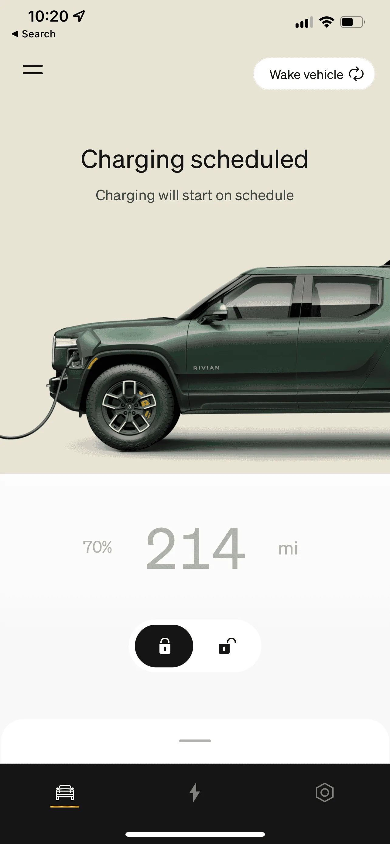

There is a sleep state and the object is to be sure your truck is in it most of the time when you are not using it.The problem is that no one can give you a procedure for putting the car to sleep though all the suggestions earlier in the thread do seem to help. When the truck is asleep you will see an indication of that on the main screen of the app in the upper right hand corner where there is a button labeleld "Wake Vehicle"
Rivian R1T R1S Tips to reduce vampiric power loss? IMG_1807
The numbers in this picture indicate the truck has lost 2 miles to phantom drain in 12 hrs and will, presumably, loose another 2 in the next 12 for a total of 4 or 1.3% per day.
