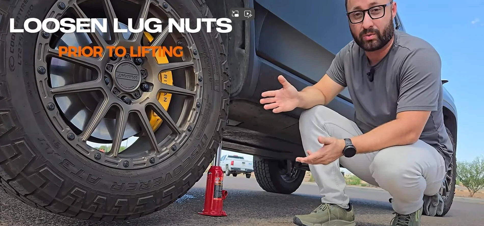

we’ve put together a quick and easy video on proper tire servicing.
I may be mistaken, but I think your video is incomplete. One should loosen the lugnuts before the tires leave contact with the ground. Otherwise, the wheels (back, I think, last time I did it by mistake) can just spin. And yes, the truck was in off-road, high.
You must have missed it ;)......
Rivian R1T R1S Tire rotation pattern incorrect in on-board manual 2025.06 loosen lug nuts
