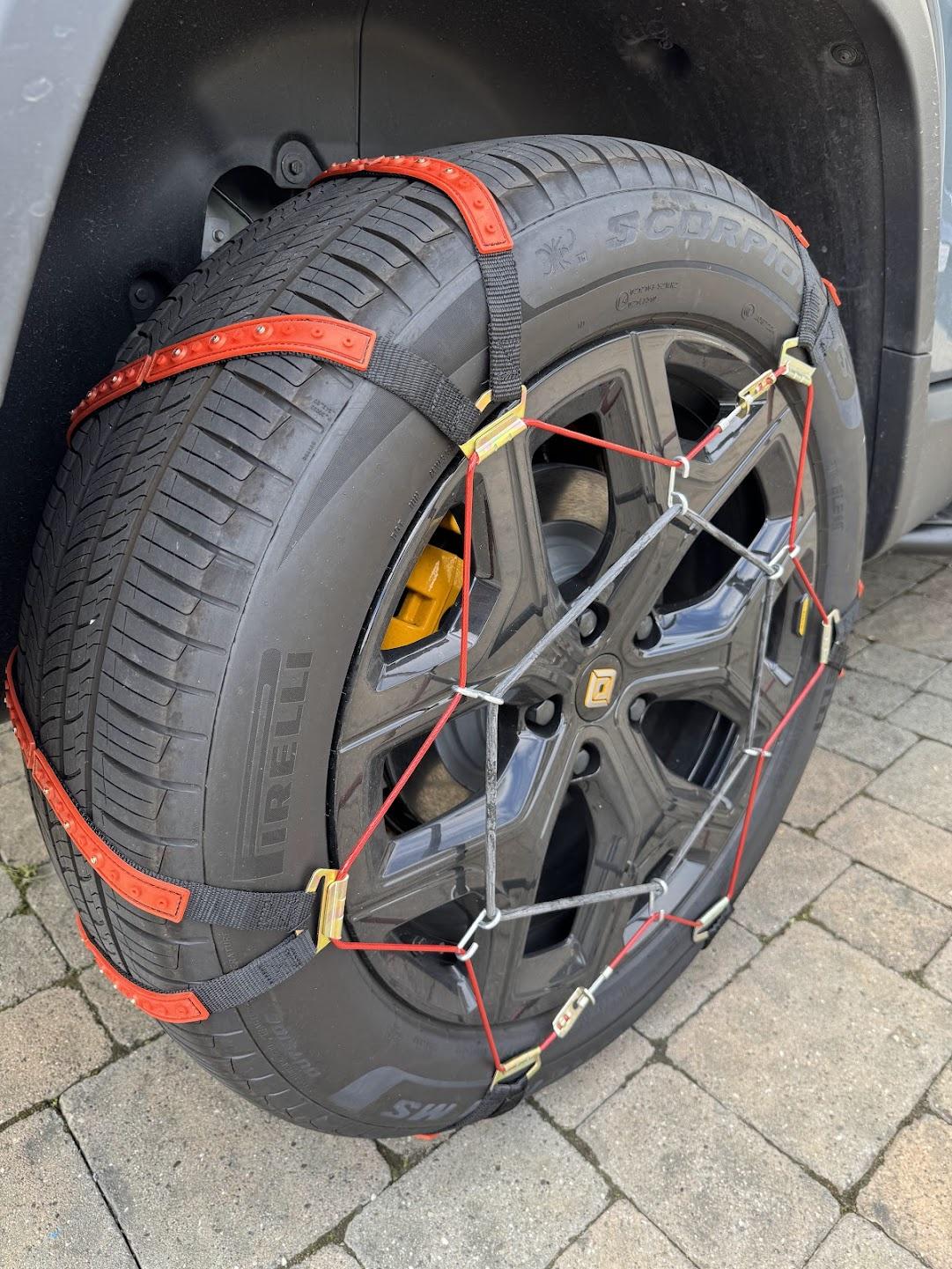

I'm trying the LaClede Alpha Trax. They're webbing-based, and meet the Class S clearance requirements.
I have the 22", and LaClede recommended the AT-747 size. They don't fit. I think as in this video, the correct size (definitely for the 21") is the AT-751 size.
Did you end up getting the AT-751 for your 22”? Did they work well? Anything special you need to know (keep car in certain height? I have the R1S Dual Large)? Can they be safely installed on all 4 tires or really only should install on rears?
Yes, I got the AT-751s. I still do need to test-fit them. Will reply here when I do.
I think Rivian recommends cables only on the rear wheels (though I've heard people have had success on the front as well).

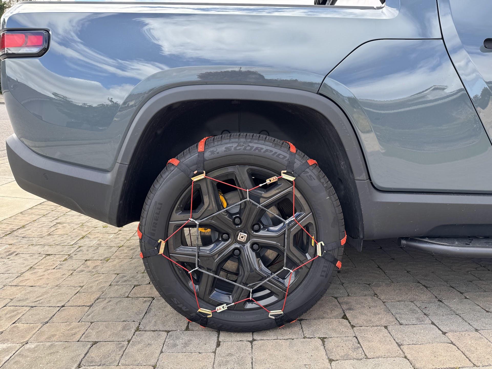

I test-fitted the Alpha Trax AT-751 on my 22" sport dark wheels. They fit *like a glove." Super tight, but not a problem locking the cables or installing the retention clips.
Did you install on all four wheels or just the rears?
I only bought one set, which has chains for two wheels. For the test I installed only on the rear passenger wheel. Rivian says not to put chains on the front, so when I go to the snow, I'll plan on only installing on the rears tires only.

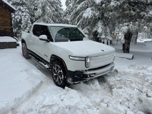

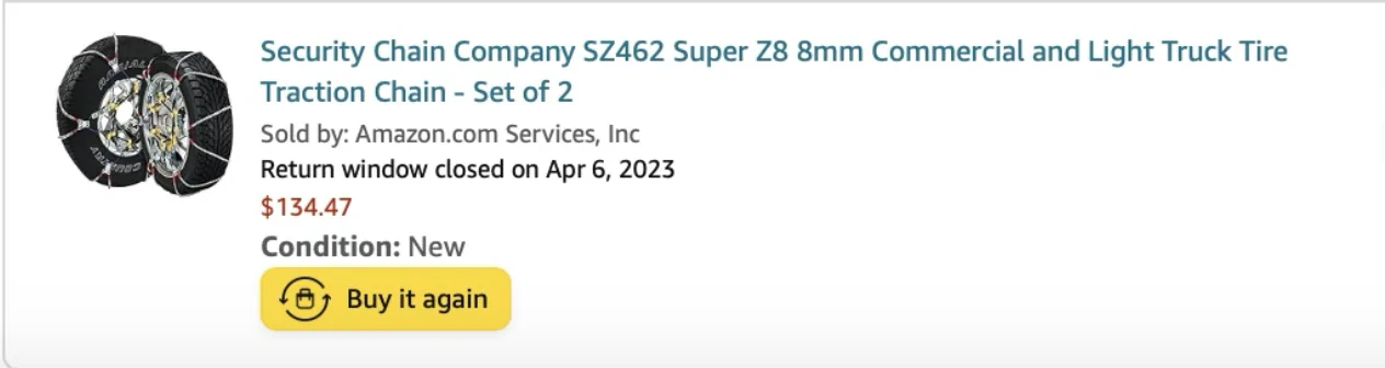

Not sure if you've decided on your chains/socks solution yet, or gone on your trip already, but here is what I purchased (via Amazon back in Mar 2023) for my R1T with the stock 21" rims/tires in preparation for a ski trip.
They were chosen for fitting the stock 21" OEM tires (275/55/R21), using knowledge gained from Forum discussions and the recommendation in the manual that 21" rims/tires can use low profile cables on the rear.

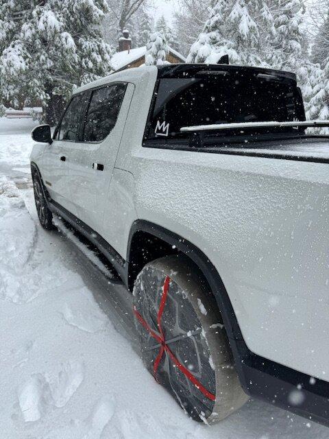

I also got socks for the front, just to be extra safe - in case it got really slick, figuring they'd enhance steer-ability on the front end.
Both checked out as fitting fine in my driveway. Fortunately, we didn't need them on the trip, so they haven't been used in real world conditions yet.

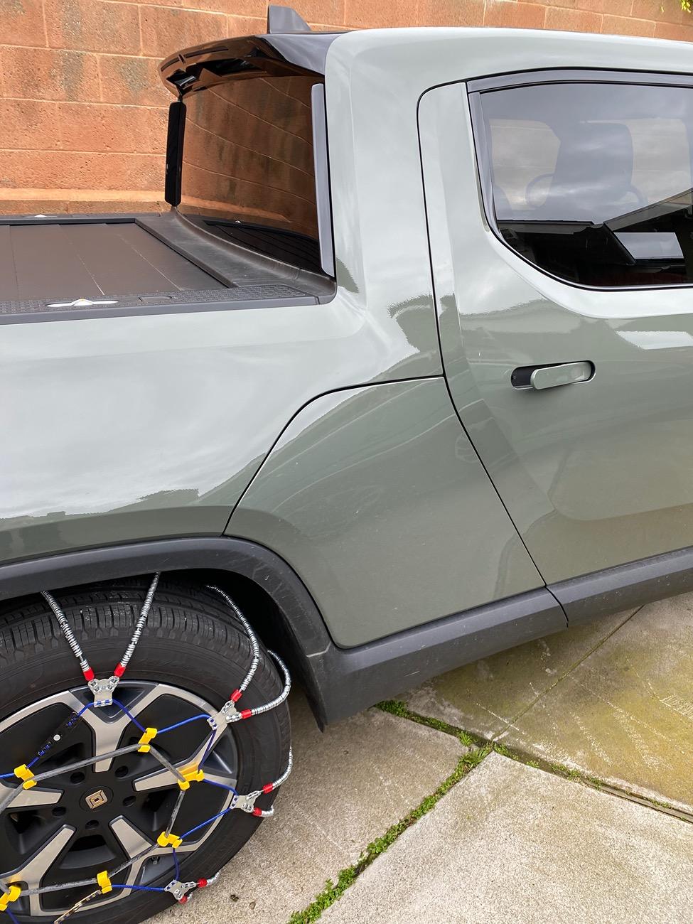

Rear: Low profile cables

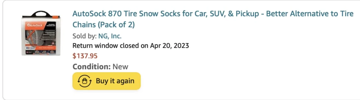

Front: AutoSock 870Tire Snow Socks
