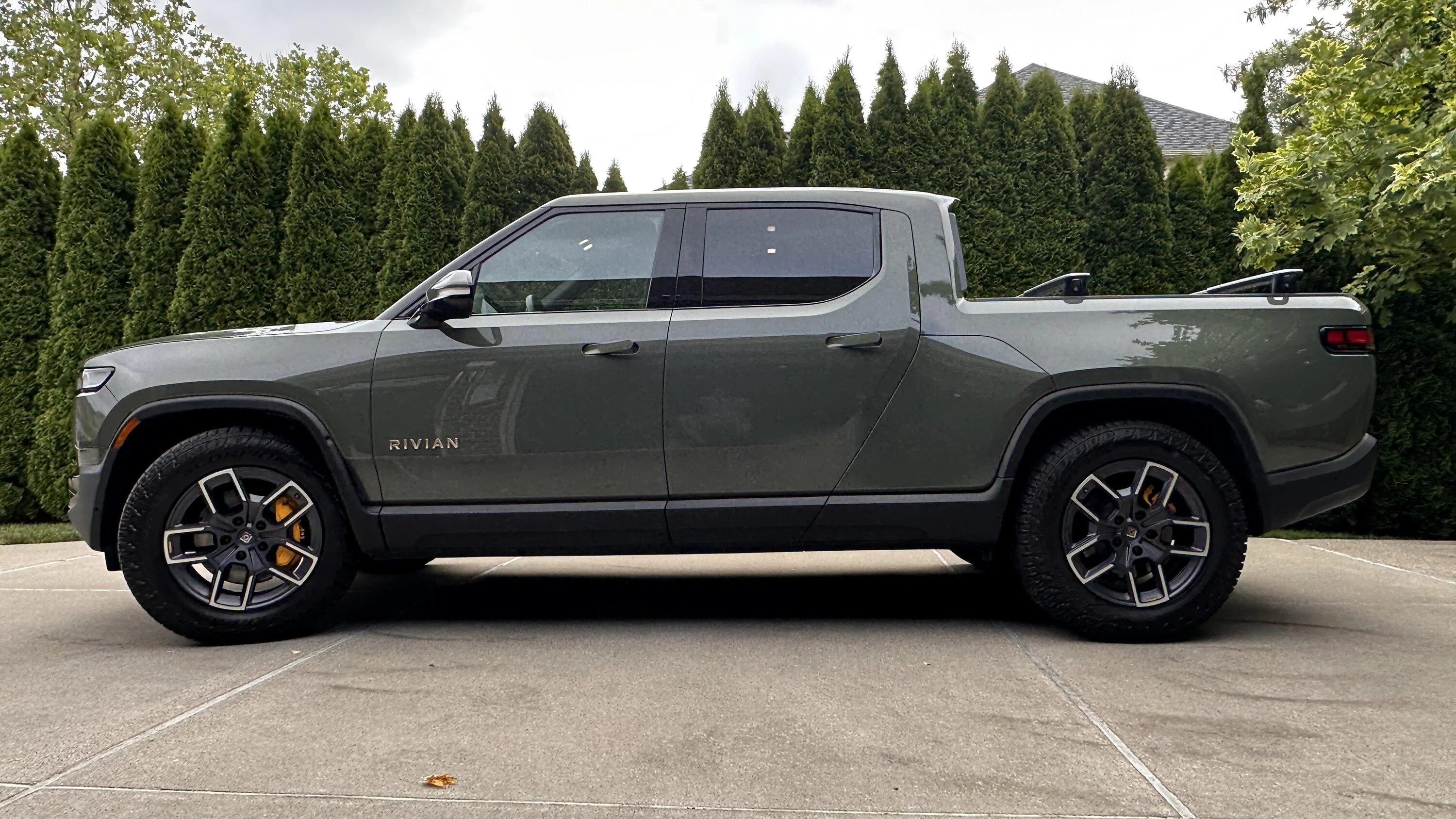

Hello Folks,
New to this group, thank you for the addition.
I have a new to me 22 R1T w/20’s. It unfortunately has an unnerving amount of steering wheel feedback over bad pavement, even while driving on a fairly new paved smooth road there is still slight steering wheel feedback. I wouldn’t equate it to ‘bump steer’, it does exhibit some of those characteristics. I can’t imagine that the ride and handling engineers would approve this and call it acceptable for release to production. Having spent months researching this vehicle (expert reviews both white papers and videos) and then finding what I thought was the perfect used one with only 1400 miles - fast forward, I‘m having a bit of buyers remorse. Of course the vehicle is an amazing feat for a start-up, and this isn’t the end of the world, but it certainly does overshadow the great things the vehicle can do and achieve…
I’ve cycled through the suspension full upright position to make certain all of the suspension/steering components are ok (that are actually visible without any teardown), of course everything seems OK. This could simply be a case of an out of specification alignment, I’m curious as to what you members have found with your trucks and whether you found root cause or correction?
Thanks in advance for your input!
