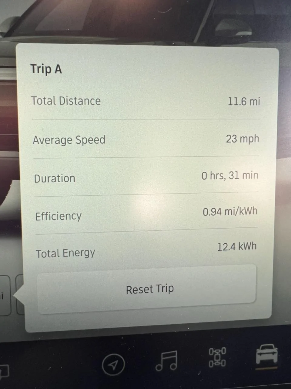

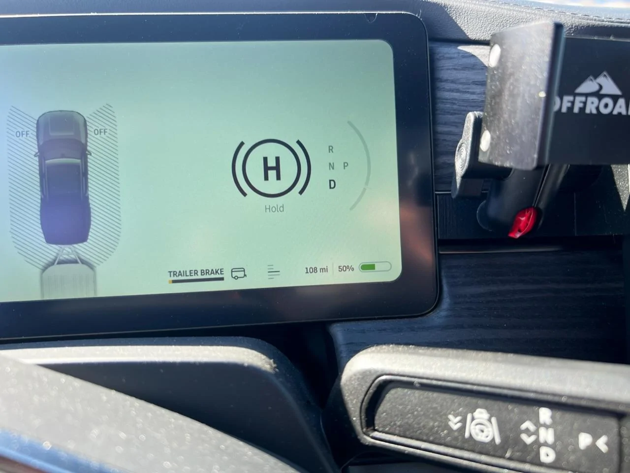

I get the feeling that Rivian software engineers just throw some shit together and send it out to the public without any testing. Three software versions ago the towing mode reported fairly accurate ranges. The 47.2 update threw it all out the window with ridiculously bad estimates. The supposedly fixed 02.3 is a little better but still completely inaccurate.
Hitched up to my 7000lb trailer like usual and here are the newest results. It shows 108 miles at 50% which is about double what the truck can do.
Rivian R1T R1S Towing + Efficiency: Please post your experience! 440E8E6C-6D11-4557-BDA7-CDE49ABB9059

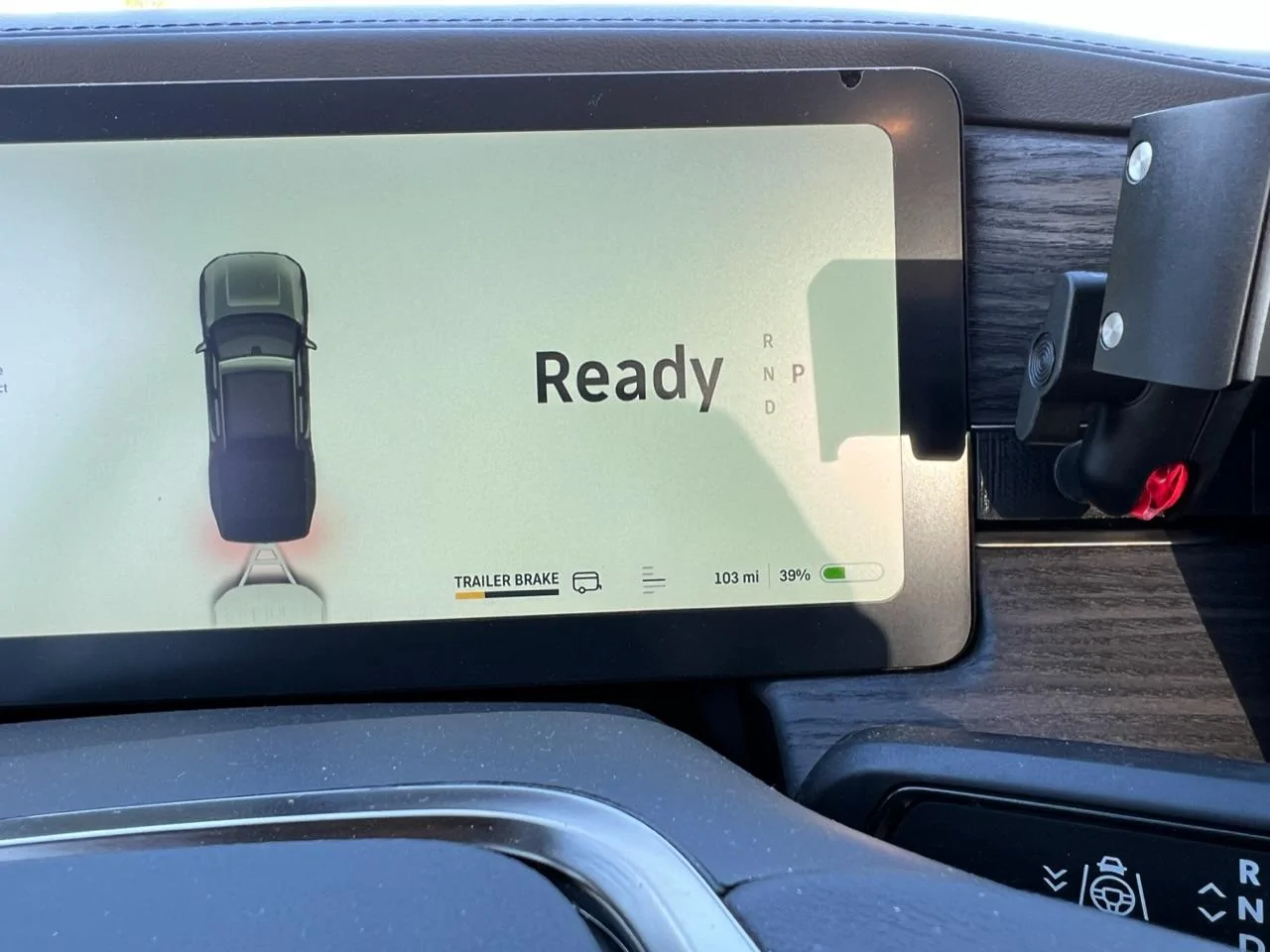

After arrival showing an 11% consumption but a range loss of only 5 miles
Rivian R1T R1S Towing + Efficiency: Please post your experience! A8449A5E-21C0-487A-A239-2D2A608D188A
The trip meter shows accurate consumption numbers.
Rivian R1T R1S Towing + Efficiency: Please post your experience! 1CE08B4E-D342-4B6D-80CC-B6EA86F4AABB

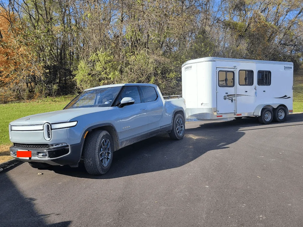

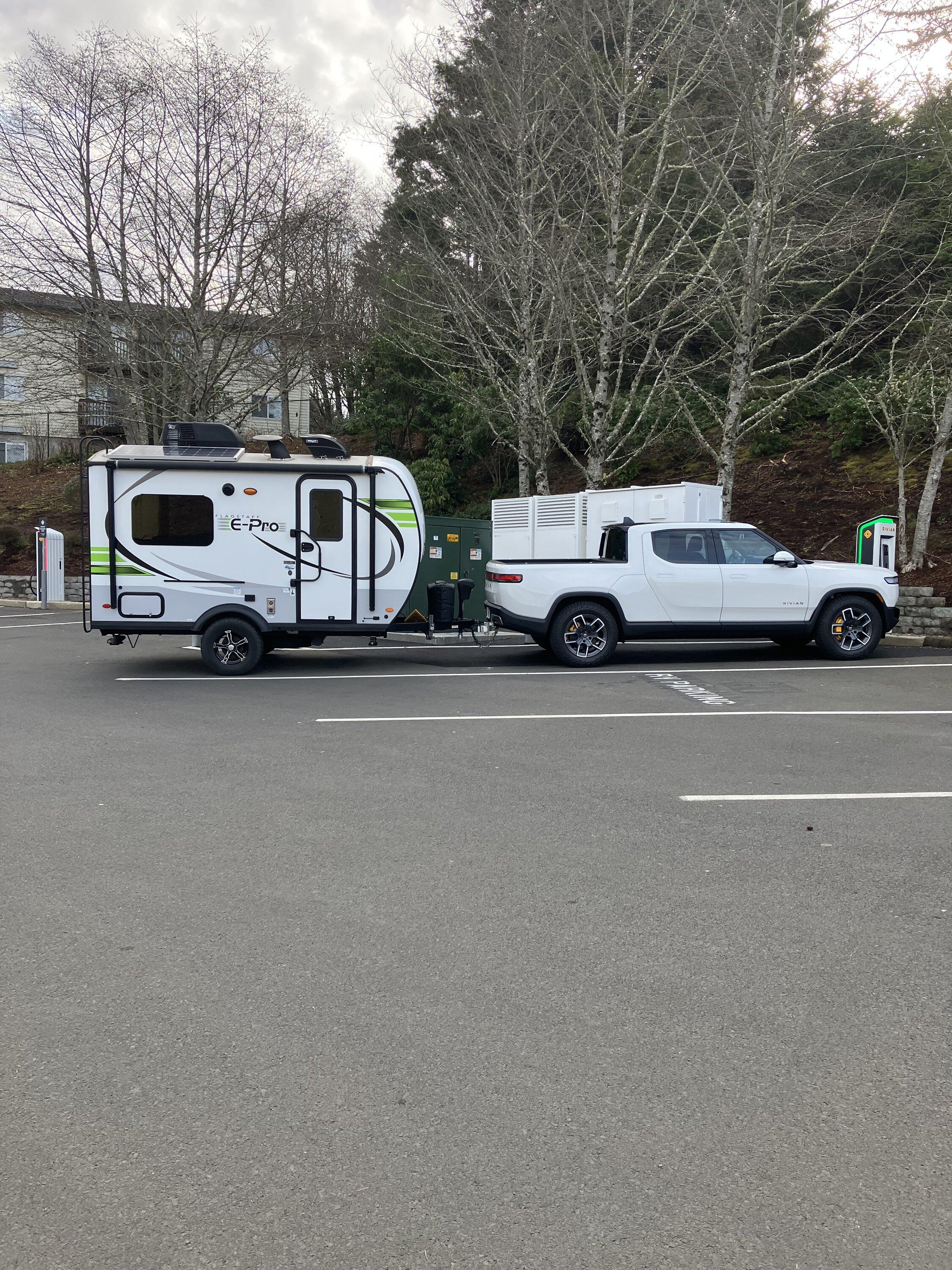

I’ve put all this in another post, but I’ll put it here too so interested parties might see it. Trailer is an e-pro 15 tb and is about 3k lbs. The trip was from pdx to Lincoln City and down the coast to Coos Bay and back.
Rivian R1T R1S Towing + Efficiency: Please post your experience! FA7F4806-EC8D-4F2A-8629-0350C4033DE6
Rivian R1T R1S Towing + Efficiency: Please post your experience! FB2C376D-5DF8-4B58-B924-9C5A79039584
Overall I’m very satisfied with the results and look forward to more trips.

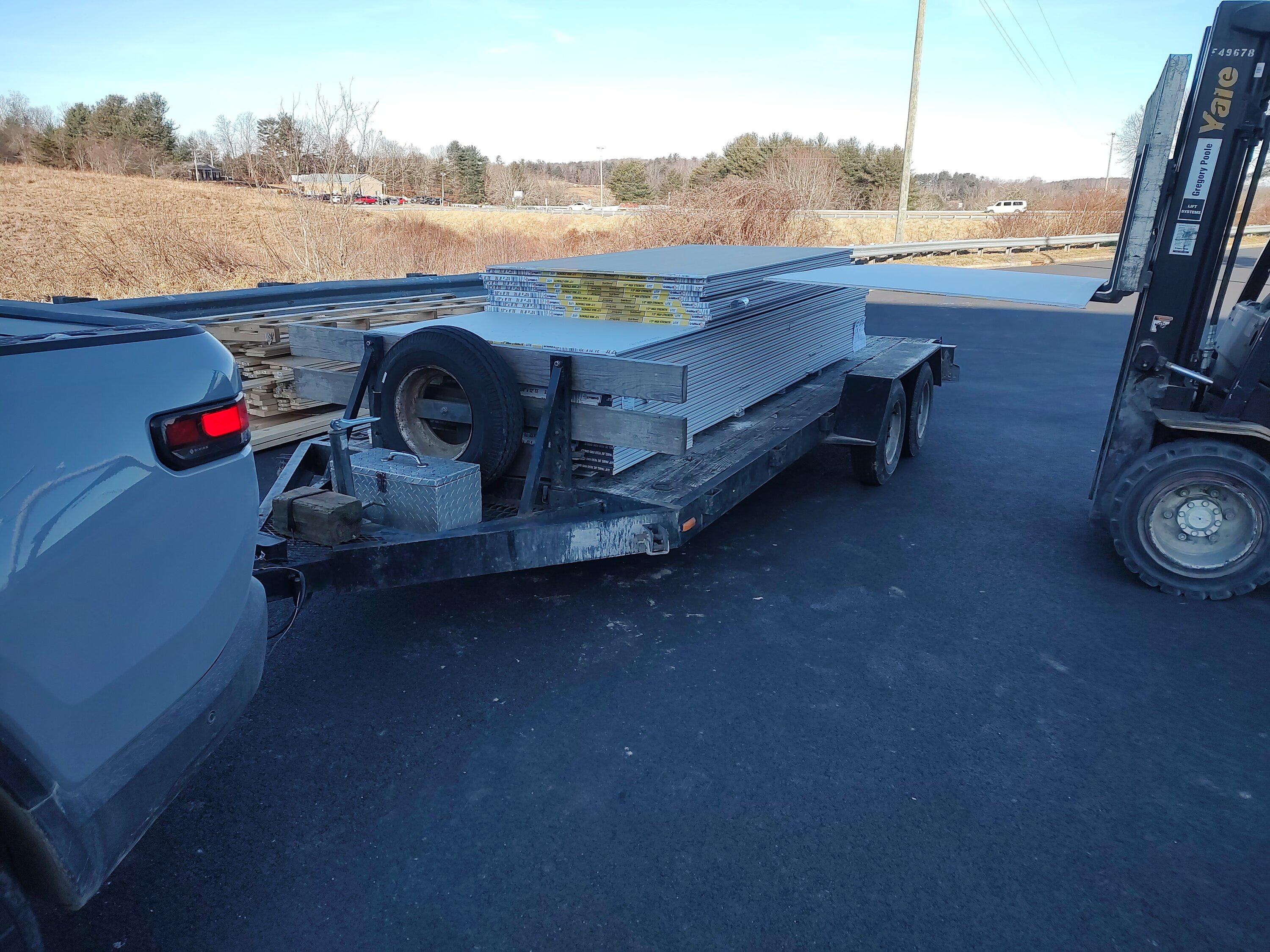

Just towed a 6x10 Haulmark enclosed trailer (non-Vnose) on my normal work commute.
In this weather, I usually go through 27-28% range on my 75 mile commute home.
With this trailer loaded with approx 1k lbs of stuff, I used 39% going home, which includes 1500' of elevation rise.
Not bad at all. Mostly doing 60-65mph in 28 degree weather.

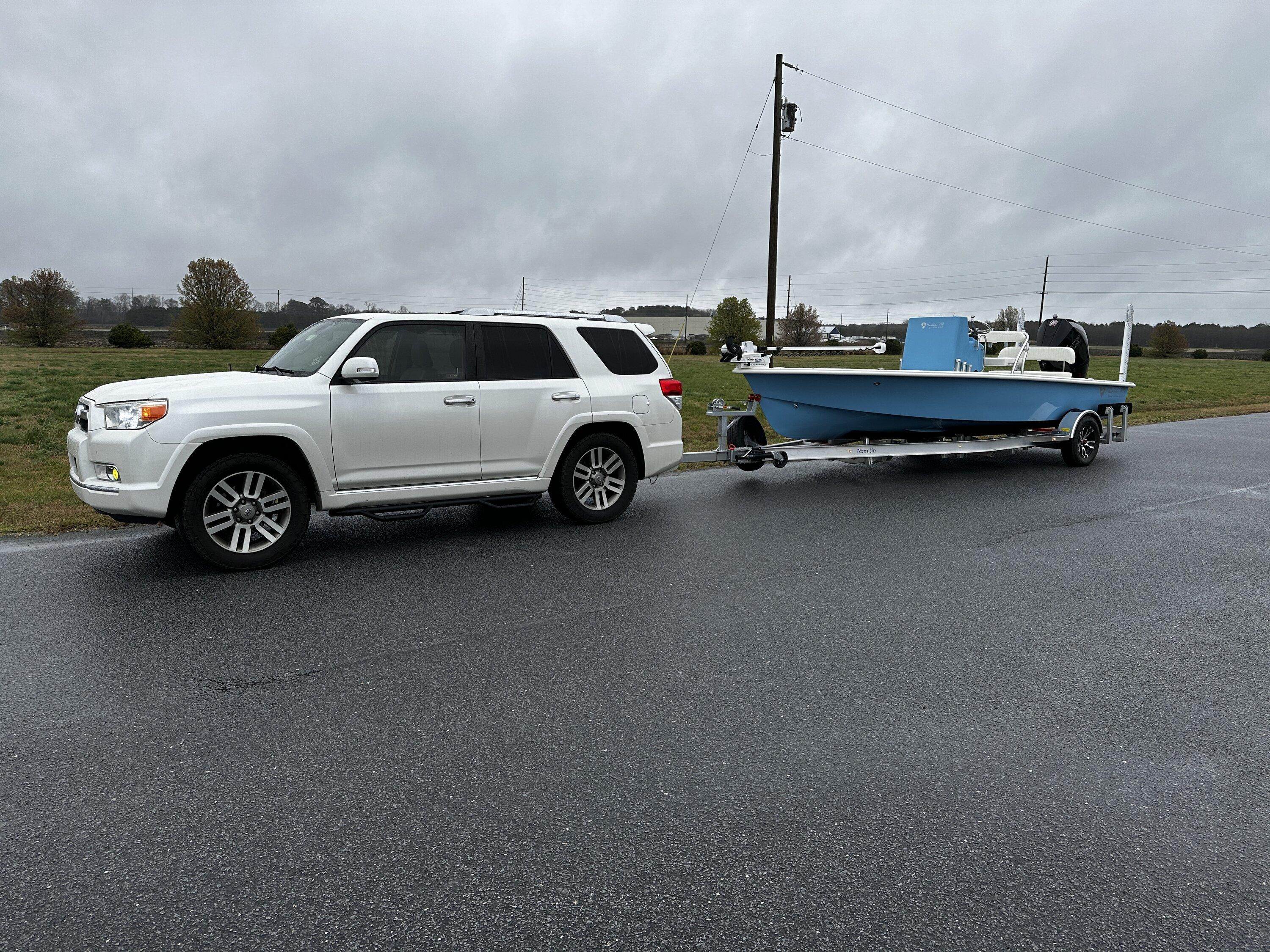

Does anyone have an experience towing the exact same load with ICE vs EV and the impact on efficiency? My only hesitation (apart from cost of an R1T) with going EV is I need to make a 150 mile tow with a boat from Raleigh, NC to Wilmington, NC. This area is a charging dead zone with only one 62.5Kw option on the way.
I just picked up my new 21' bay boat, weight is 3000lb's as it sit on the the trailer. With my 4Runner I experienced a 27% decrease in mpg (11mpg down from 15mpg, I have E load Nitto's) while towing at 70mph. Could I expect the same mi/Kwh decrease if towing with an R1T? If so, in theory, that would use about 225 miles of the 300ish miles range with an R1T on A/T's.

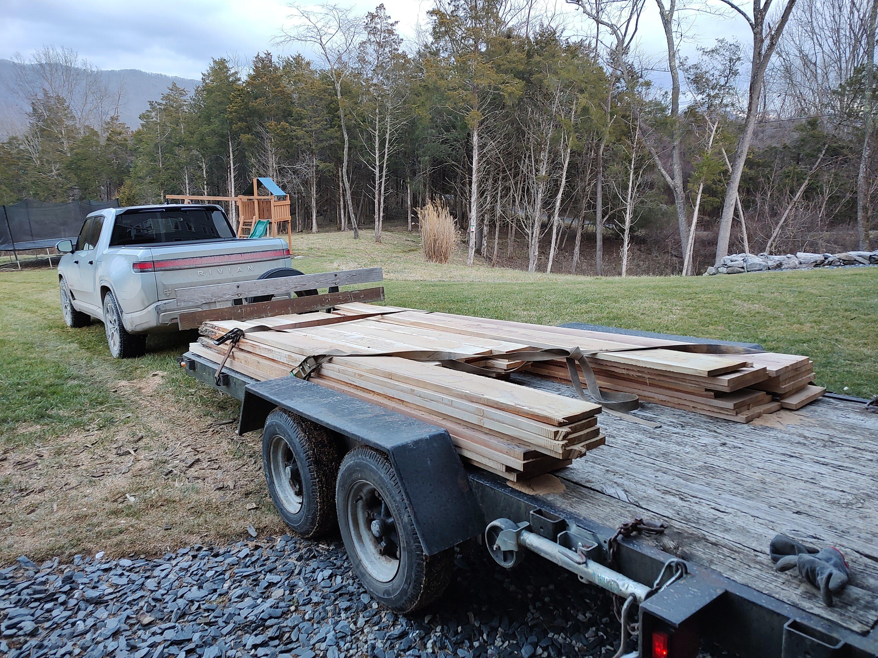

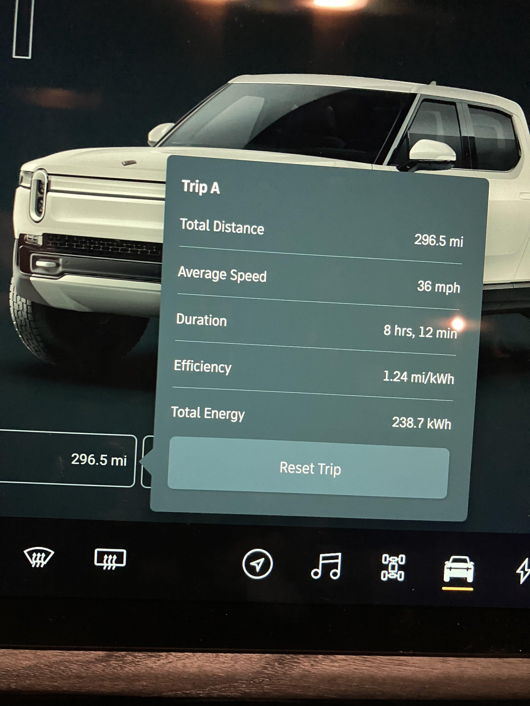

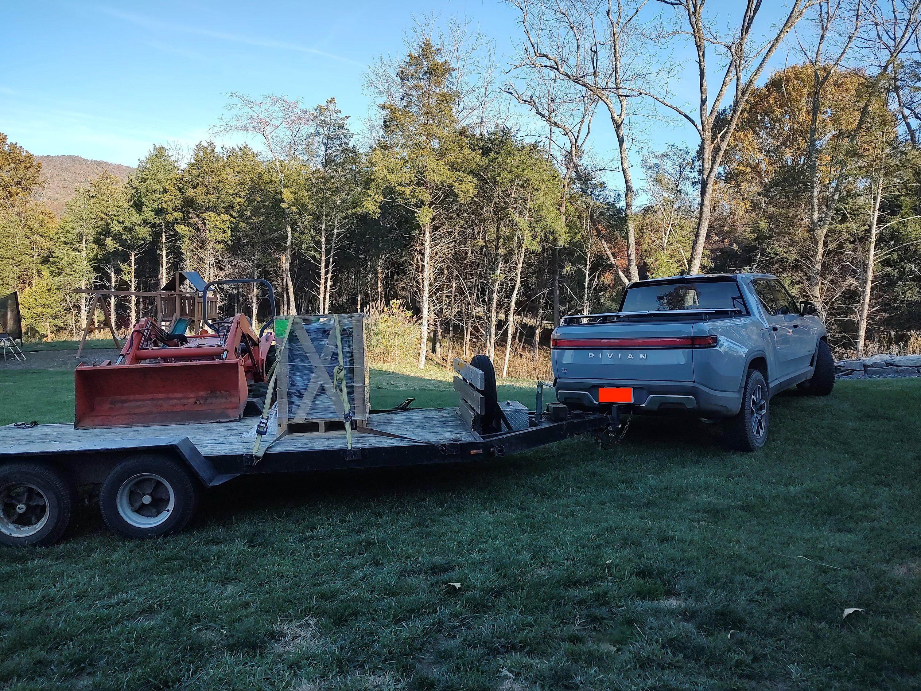

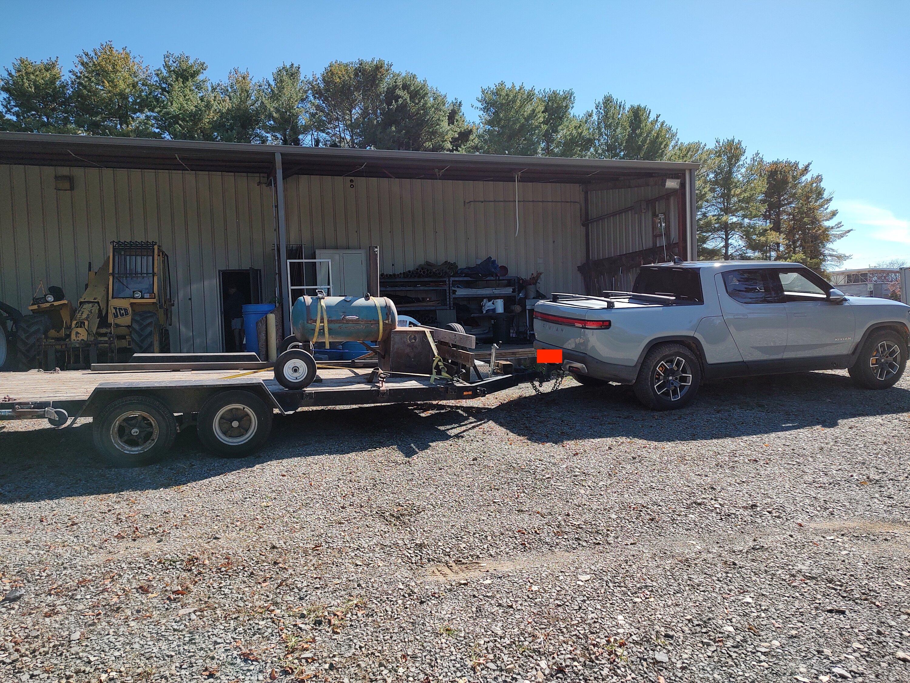

I've towed quite a bit, mostly local (<50 miles), with one longer 150 mile trip. I mainly tow a 2300 lb (empty weight) 18 ft equipment trailer. My partner has an enclosed 3 horse trailer that weighs 3500 lb empty.
Loaded weights have ranged from about 3500 lb to 10,000 lb+. I dont have a picture of the efficiency while towing, but it does not really seem to matter what the weight is, efficiency with the equipment trailer is about 1.15-1.25 mi/kWh, including the 150 mile highway trip with 8000 lb of sheetrock and around town with a Kubota tractor (9000 lb). Towing the enclosed horse trailer with horses (10,000 lb) results in lower efficiency (1 mi/kWh), but still not bad. Once the charging infrastructure is better interstate towing with the R1T will be fantastic, but for now it's mostly <100 mile trips.
Overall, this thing is a great tow rig (it's easy to forget there's even a trailer back there), assuming the distances are reasonable.
Rivian R1T R1S Towing + Efficiency: Please post your experience! IMG_20230103_170639147
Rivian R1T R1S Towing + Efficiency: Please post your experience! IMG_20230204_085240458
Rivian R1T R1S Towing + Efficiency: Please post your experience! IMG_20221009_143947977
Rivian R1T R1S Towing + Efficiency: Please post your experience! IMG_20221021_170120429
Rivian R1T R1S Towing + Efficiency: Please post your experience! image (7)
