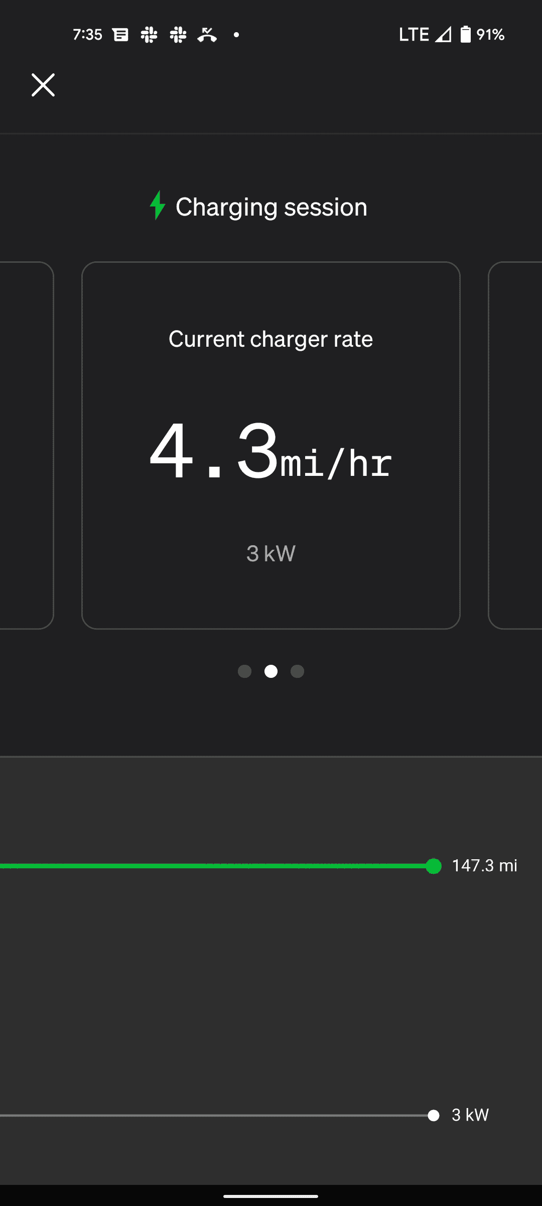

Confirmed both of my TT-30 adapters work with Rivian mobile charger. Putting a disclaimer here that you need to set the amperage to 24a in the vehicle every time. Just unplugging the mobile adapter to try another TT-30 adapters the vehicle went back to 48 amps and started pulling more than 24 amps. That concerns me in case of power outages, etc. I will do some more testing to see if that is also because I unplugged the cable from the vehicle.
Safer bet would be to is the regular 120v plug, or find a 50a circuit.
Here is the link to the one I think is best as it fits in the charging bag and the matching Rivian yellow is icing: https://www.amazon.com/gp/aw/d/B07XNSXWM4
Never mind what I wrote. I just RTFM and now I undersatnd that when I schedule a charging session I can set the amperage and it sticks. This issue is for charging at campgrounds where you don't have a regular session.
And I greatly appreciate the input here. I do plan to take my R2 camping right away! More accessories to buy before I get the dang vehicle! :rolleyes:
