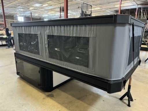

It’s installed! So far getting between 1.4-1.8 mi/kwh average. I was average 1.8 prior on my 20 inch in Colorado winter. I think seeing around a 15% drop in range. Not terrible. I drive like a grandma so it's managable. If you drive at higher speeds there'll be a greater range loss.
Planning on putting a Hest mattress in. Also ordering a fairing to help aero flow. Got a mount for my Starlink as well. Will be using this pretty much every weekend for skiing here in CO for next few months.. Say hello if you see me around!
I ordered a thermal pack to be installed next month TBD. Will be using an electric space heater.
Kyle from Out of Spec reached out on doing a video. Hopefully he can dig into some of the nerdier details.

Inspired by @jjswan33 Oru camper build, I am building out my Rivian camper with Tune Outdoor. Delivery is January. I plan to use it all year here in Colorado for skiing, MTB, camping, ect. I like the additonal size on the camper in a small footprint, especially on a small truck like R1T. I got the chance to check the facility and poke around the campers, they are extremely overbuilt and spacious even on a Tacoma.

Current Specs:
Charcoal Fabric
Tempered Glass - Driver, Passenger, and Rear
King Size Slider - Will not be king size as the camper will be 67" wide. Expecting somewhere around a 67"x80" sleep area. Necessary as I am 6'1 and cannot sleep east-west with 67" width.
Power supply - Figuring out a system using my Jackery 1500. May upgrade to a larger battery pack. Figured I would top off using bed inverter.
Maxxair Fan
No passthrough slider - not possible with the Rivian's size. They would need to find a smaller window. I am fine without this.
It'll mount using the accessory points. They plan on making holes for the buttons. Eventually they want to design a mechanism to access the rail buttons without drilling holes but mine will not have that as the first production model for Rivian. They're very on board with developing a camper for Rivian. They also have plans to make accessories using the T-Track. Also discussed fabricating a fairing to reduce drag.
Will keep this updated as the build progresses.
