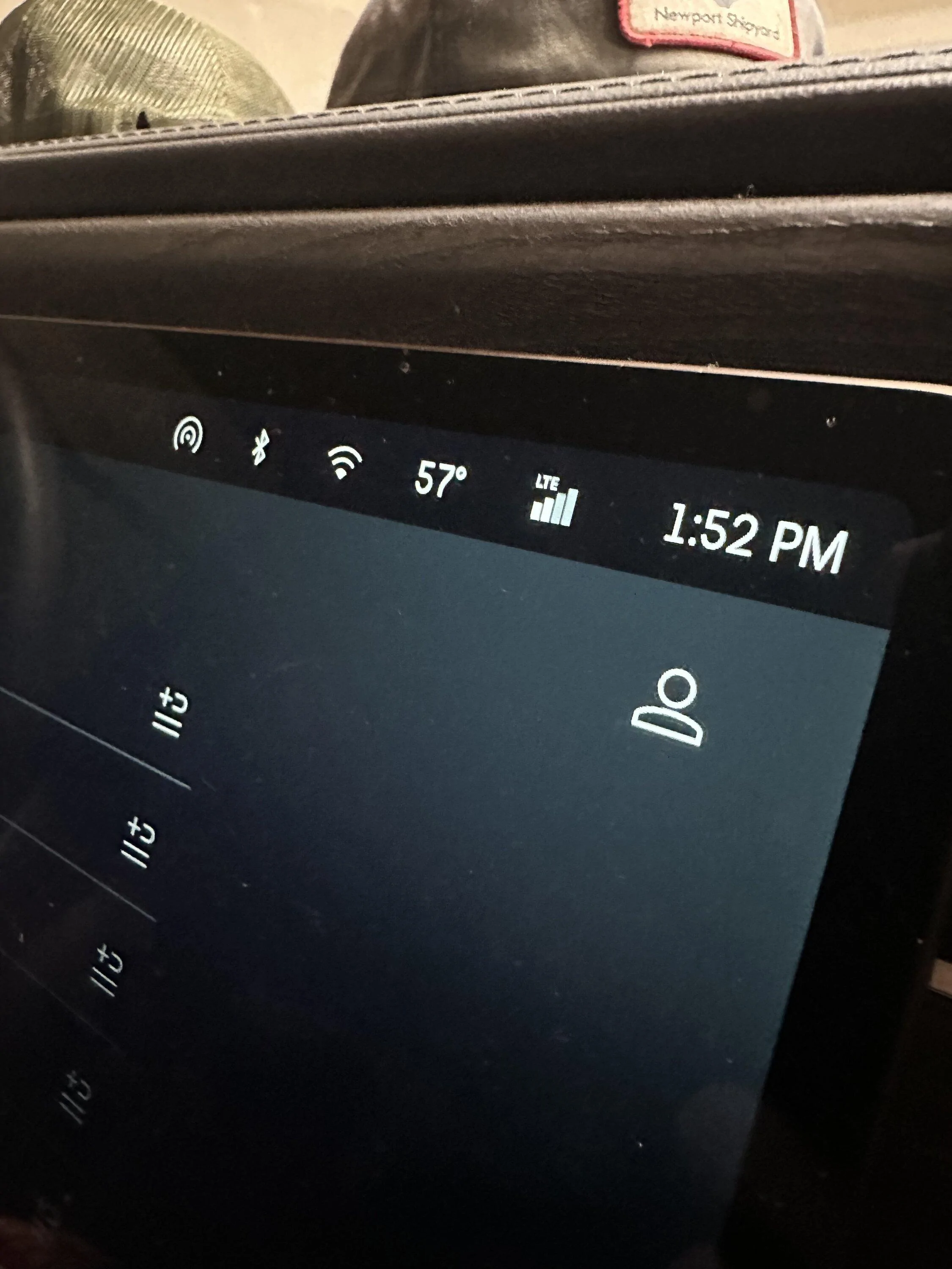

I’ve been driving this all around mountain passes in CO with no issue to reception or GPS. I also hate not playing music while driving so Spotify is always running. I think the fact that I can connect starlink through the FRP (also honeycomb) materials shows how little it interferes with RF signals. The Tune also has an aluminum frame and composite corners.
2 bars of signal strength in my garage, I only have two bars/5G on my iphone here (AT&T):
I wouldn't say I have reception or GPS issues either, just finicky D+. If your D+ is working great then you are the anomaly to this issue.
