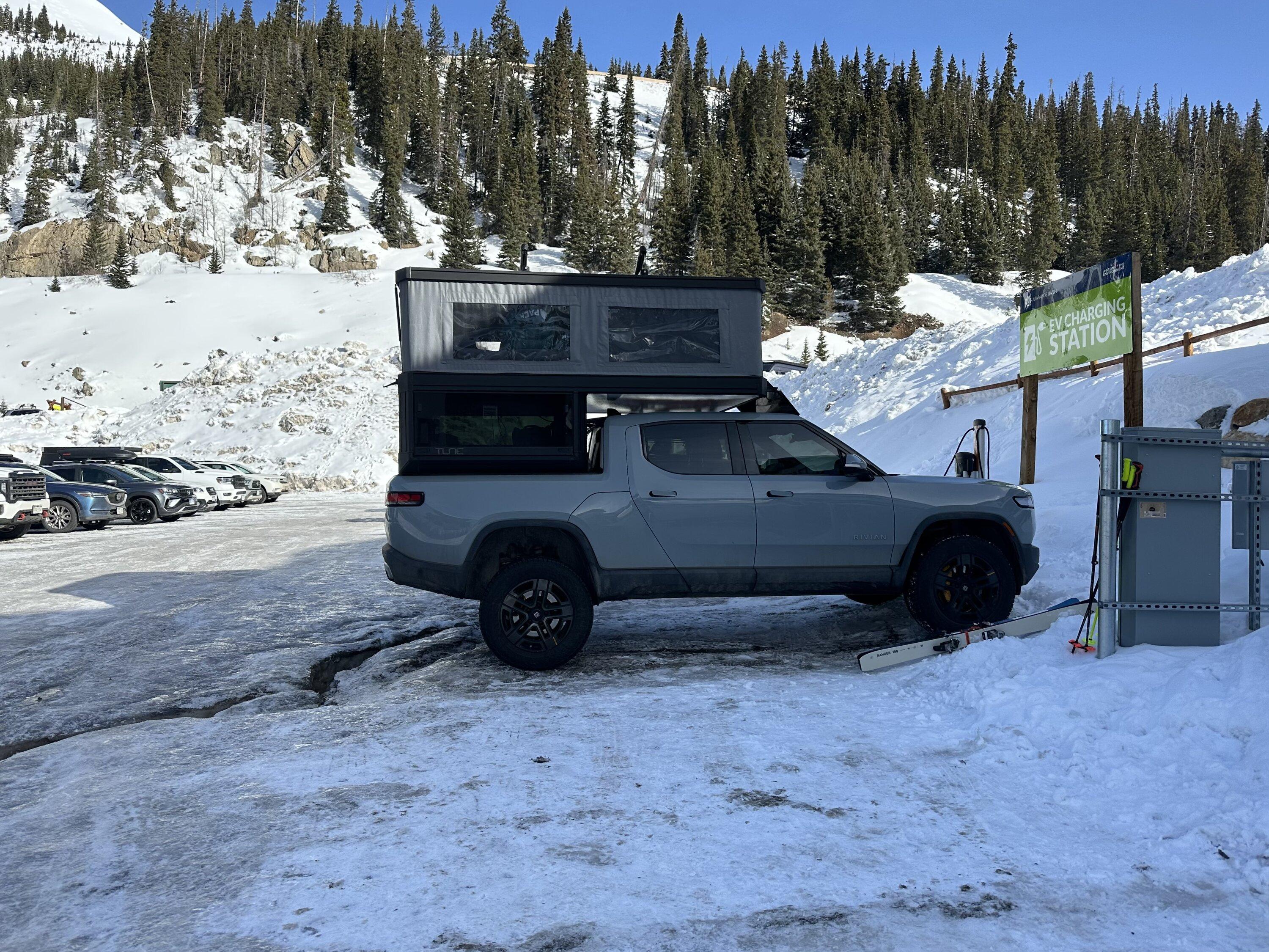

Yeah! We were back in Crested Butte. Forgot to take a photo but here’s our boondock site for one night. Taken after taking the camper down in morning.
3 degrees overnight. Stayed 55-60 in the camper with 1500w heater. About 10% battery loss.

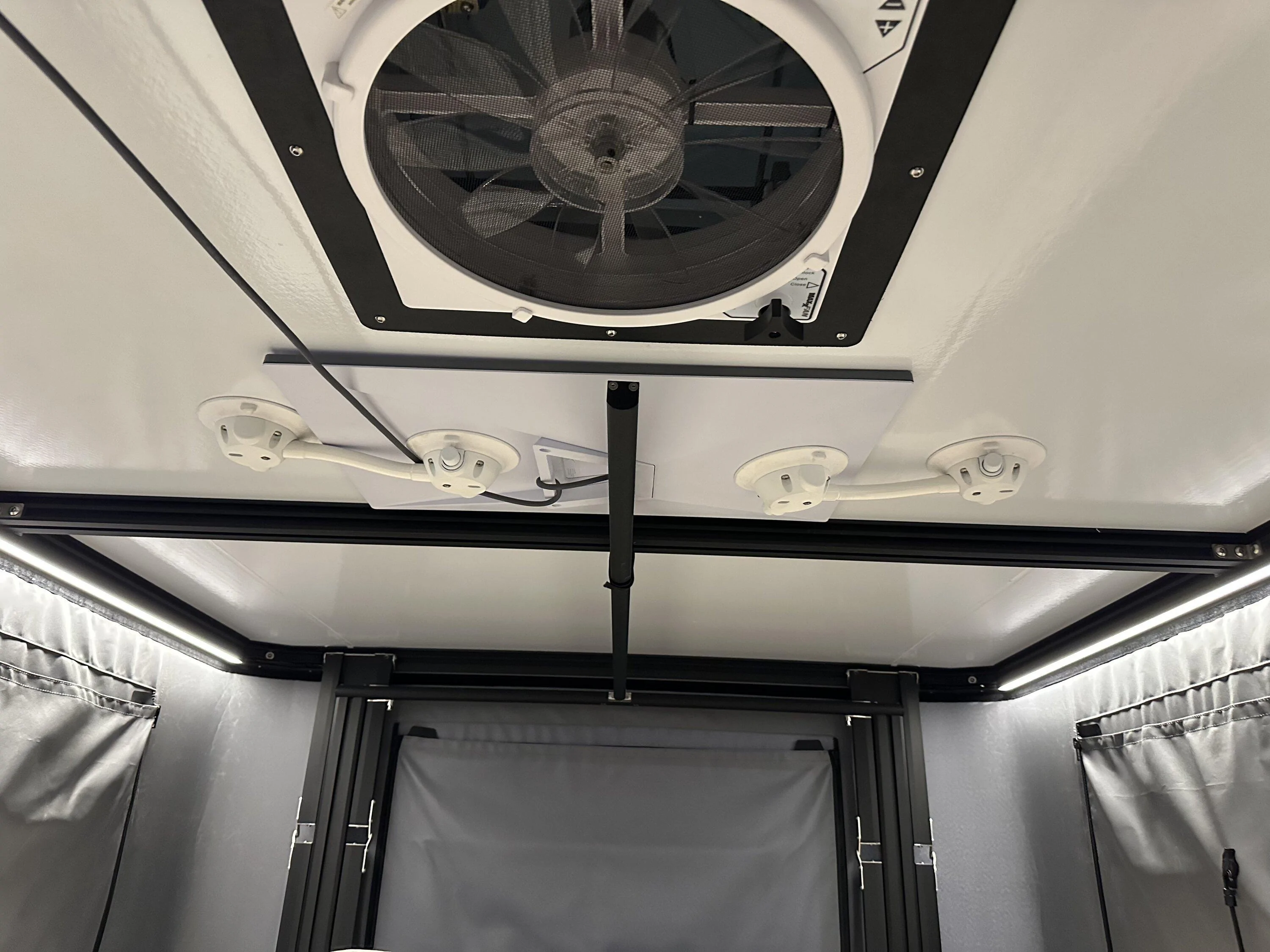

Updated my starlink set up. Didn’t like having to put up and put down everytime I used and routing a cable outside. Since the roof is FRP, I now have dishy mounted inside. Did not want to mount to roof if possible due to cable management. Drilling a hole in my roof was not appealing.
No issue with obstructions or signal and can work when the camper is popped up or down. Pretty satisfied with this solution. Also can be used in motion with priority subscription.
If there’s obstruction (trees) at my site I can pull it off and move it to a clear spot on the ground. Best of both worlds between permanent mounting and not mounting.
