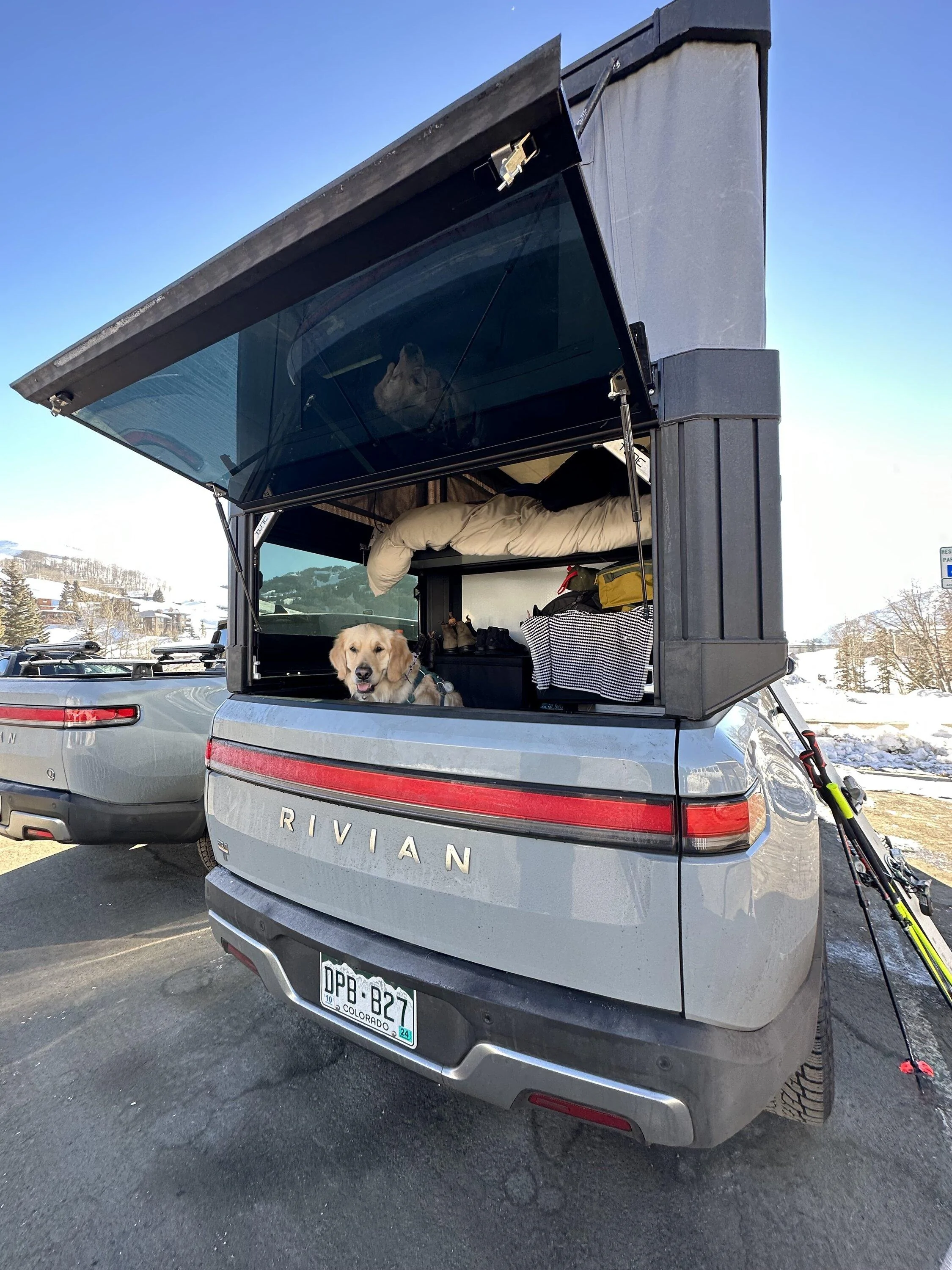

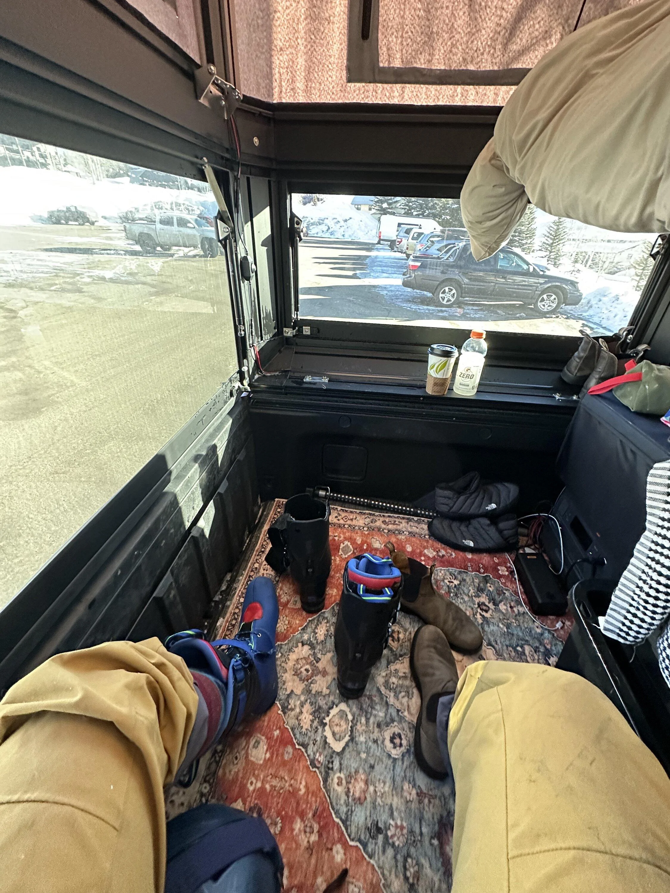

First Trip: Colorado Springs to Crested Butte. I won't normally post updates on trips since we go skiing pretty much every weekend. But I'll give some insight this time on how it went.
We stayed at Elk Creek Campground in Gunnison since we're not as familiar with boondocking spots around CB. Elk creek has winter accessible RV 50amp plugs which makes it a bit easier for our first trip. About 50 min drive to Mt Crested Butte.
Range loss was reliably 10-20%. The onboard nav computer did a good job accounting it.

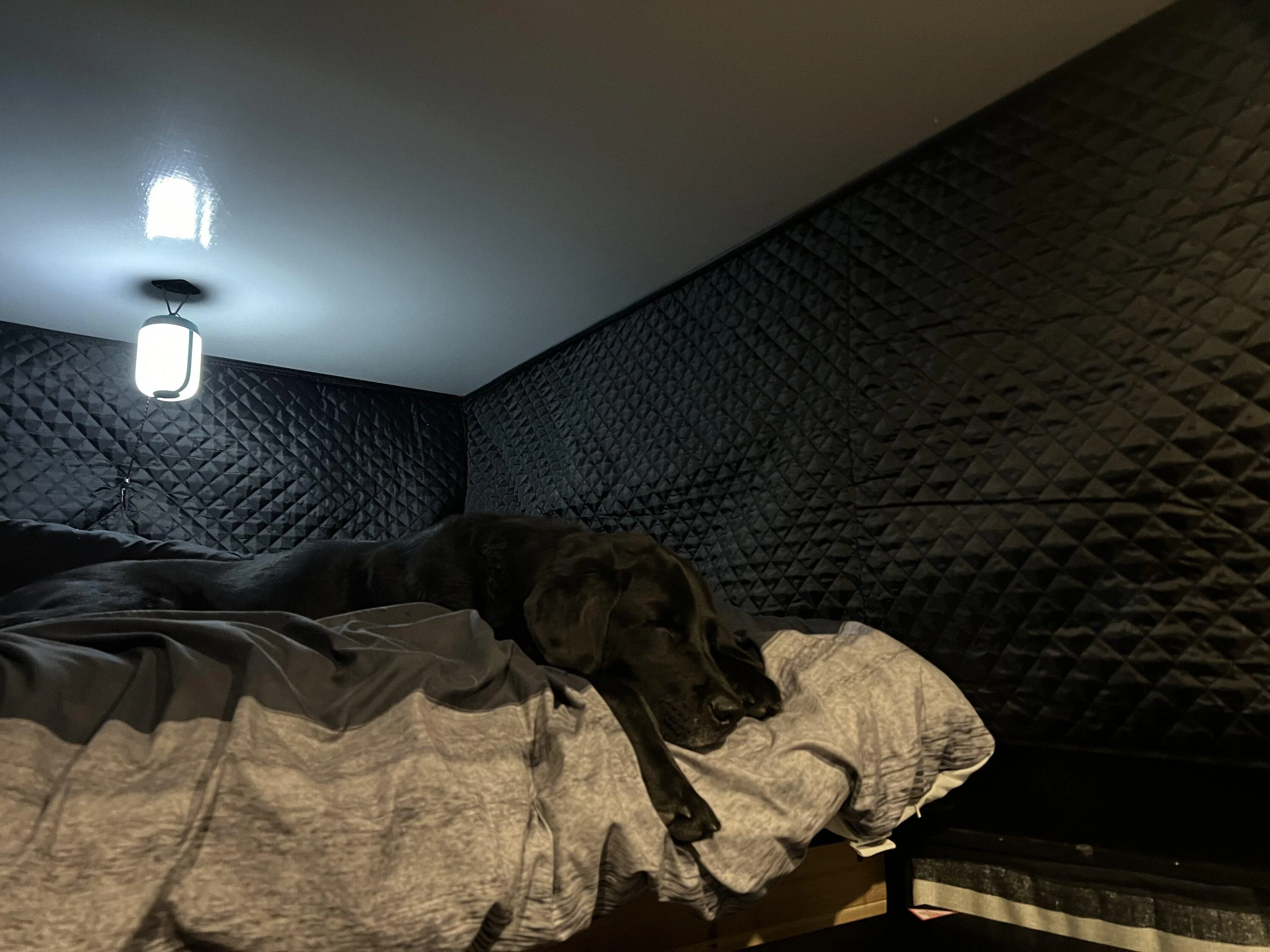

Temps were between -5 to 10 degrees overnights. Cold. No wind thankfully. We ran one 1500w electric space heater in the bed using the inverter. This kept the bottom part nice and toasty at 50-55 degrees. but it was colder up top, especially by our heads, around 37-40 degrees. We used an electric blanket plugged into the Jackery. Also don't think heater did a great job at moving heat around and towards our heads which increased condensation. Wasn't dripping but some ice on the metal and around the bottom of the tent fabric. Manageable by popping the tent during the day and letting the Colorado sun take care it. Also having the roof fan was great when it got hot inside during the day and to vent out the camper.
The second night we used shore power to run a second 750w heater which was up by the bed. Kept the whole space at 65 degrees and no condensation, not normal though. I'm also thinking the 1500w heater doesn't have a great fan on it, might try another heater or different placement. TBD.
Looking forward to getting an insulation pack, we loss a lot of heat to the canvas.
Tucked in:

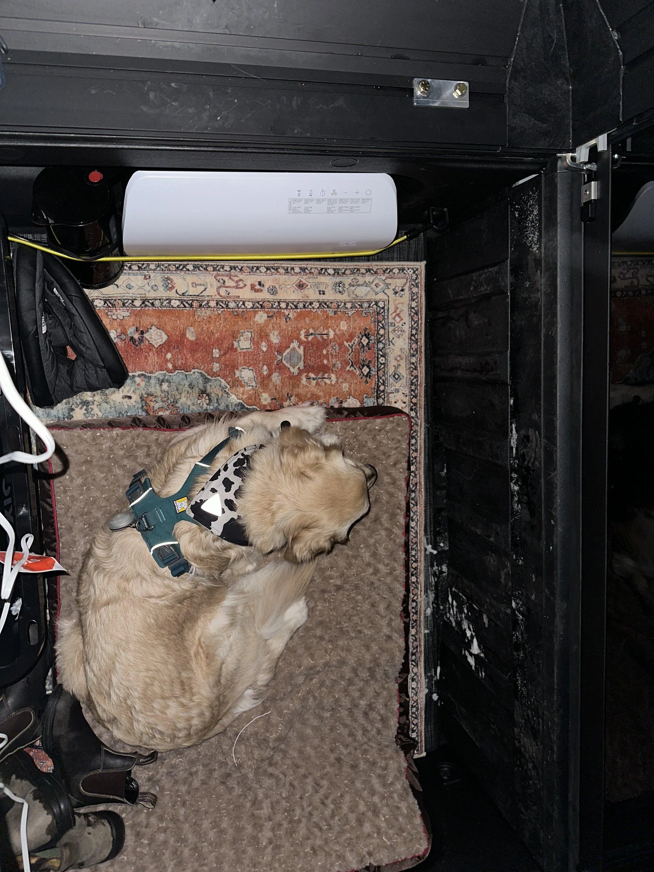

Our dog, Obi standing watch:
Rivian R1T R1S Tune Outdoor Camper M1 Build IMG_0778

Thanks for posting...A couple of thoughts:
  • I imagine Obi slept well that night
  • I cringed seeing the skis leaning against the side of your truck...With my luck I'd have a perfect arc etched in the side of my vehicle marking the direction in which the skis fell!

Yeah he was toasty for sure. We were not as toasty up top but dog comes first.
The wing extrusions work for leaning skis against camper! But it's not great, I agree Bit of a disaster waiting to happen. I have a rubber magnetic ski holder but I accidentally buried in under my stuff, it worked okay later when I dug it out. The camper sort of makes it difficult to use. Was thinking of making a removable ski holder that would quick mount with the t track but that's low on the project list.
Also got a ski rack set up for the roof but didn't have the right hardware. Will be mounting that this week. The wing extrusions made it possible to carry my 185 cm skis inside the cabin in a bag at a diagonal. Probably could fit 191cm bent chetlers too.
FWIW the insulation kit in my camper made a big difference but obviously not apples to apples. I found my roof was pretty well insulated but the composite walls got cold. I can imagine canvas would be worse and I don’t know what the roof of yours is made of.
For the lower portion of the camper I stuffed foam board insulation anywhere I could fit it. I also made window covers and a fan cover, they are 3 layers fabric, Insulbright and Reflectex and then sowed around the edge. My weak point is still the tailgate.
As for heater I bought a Dreo heater on Amazon. It is compact and has 3 power settings (900,1200,1500) also has a digital thermostat so you can set a temperature. Full disclosed the oscillating feature broke on my first one but the company sent me a replacement, I just had to send them a video of It.
