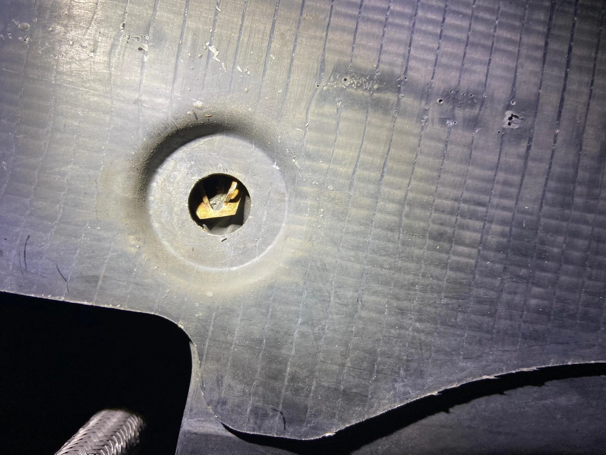

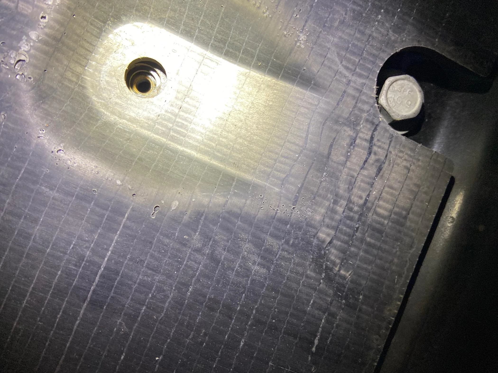

I was underneath my vehicle checking in something and noticed I have 4 bolts missing. I know the last time I checked I had no missing bolts. Anyways, in two of the workpieces where the bolt goes I see what looks like rust. I have the RUS but this is on the area underneath the front of the vehicle, where the composite cover is, passenger side.
Should I be worried and open a service ticket?

I’d worry about the missing bolts, but not about those rusty nut clip things.
interesting. i thought the opposite.
the bolts are easy to replace but the rust could be more pervasive underneath the composite cover. if you look at the first pic, its not the nut clip thats rusty but the workpiece where you screw the nut into that has visible rust.

That rust is forming on bare metal that is a byproduct of the bolt being threaded into the hole. Once the bolt fell out, that bare metal surface was exposed and surface rust formed. About the same amount of rust that you would see if left a brand new set of pliers out in the rain over night. I personally wouldn't throw out the pliers or worry about that surface rust.
I would take a wide shot that you can draw some arrows on so you can upload for a service appointment. Hopefully they will send out mobile service and get them replaced sooner than later.
