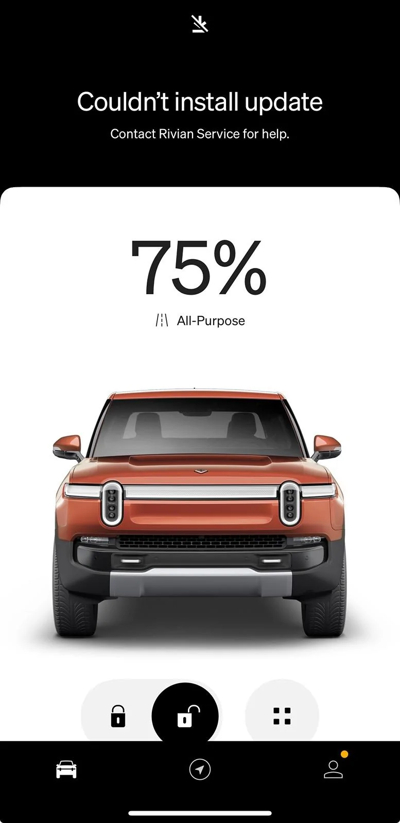

Hi - i know this is an older thread/reply but my Gen2 R1S has done the same thing with the recent 2024.51.01 update. Failed 3x at the same ~7%. They called saying I need to take it into the SC for them to diagnose - which may take several days. Sucks because the last update went perfectly - probably done within 25 mins.
Curious how long it took them to replace your communication module?
When I had a similar "fail to update" issue it was related to my 12v battery health. Do you have any warnings in that regard?

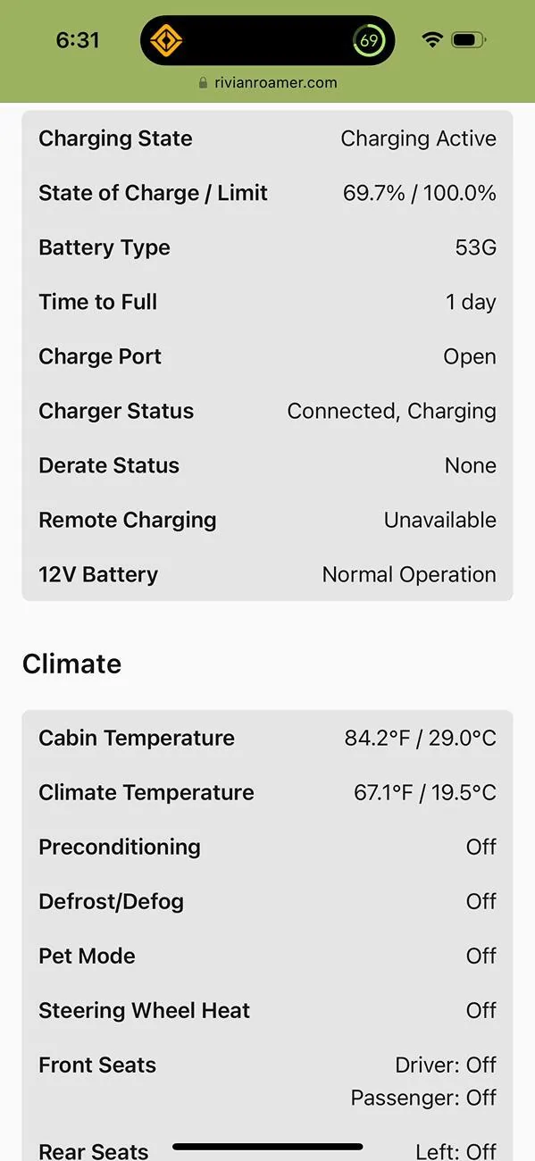

Dear lord I hope not. No, I haven’t had any warning signs regarding the 12V.
I just took delivery a little over a month ago although I know there are horror stories of others having their Gen2 brick with less than 1K miles.
Rivian Roamer has enhanced the owner dashboard view with a ton of vehicle data on the site now. It currently says my 12v is operating “normally”
I highly suggest everyone sign up if you don’t have an account and have a look.

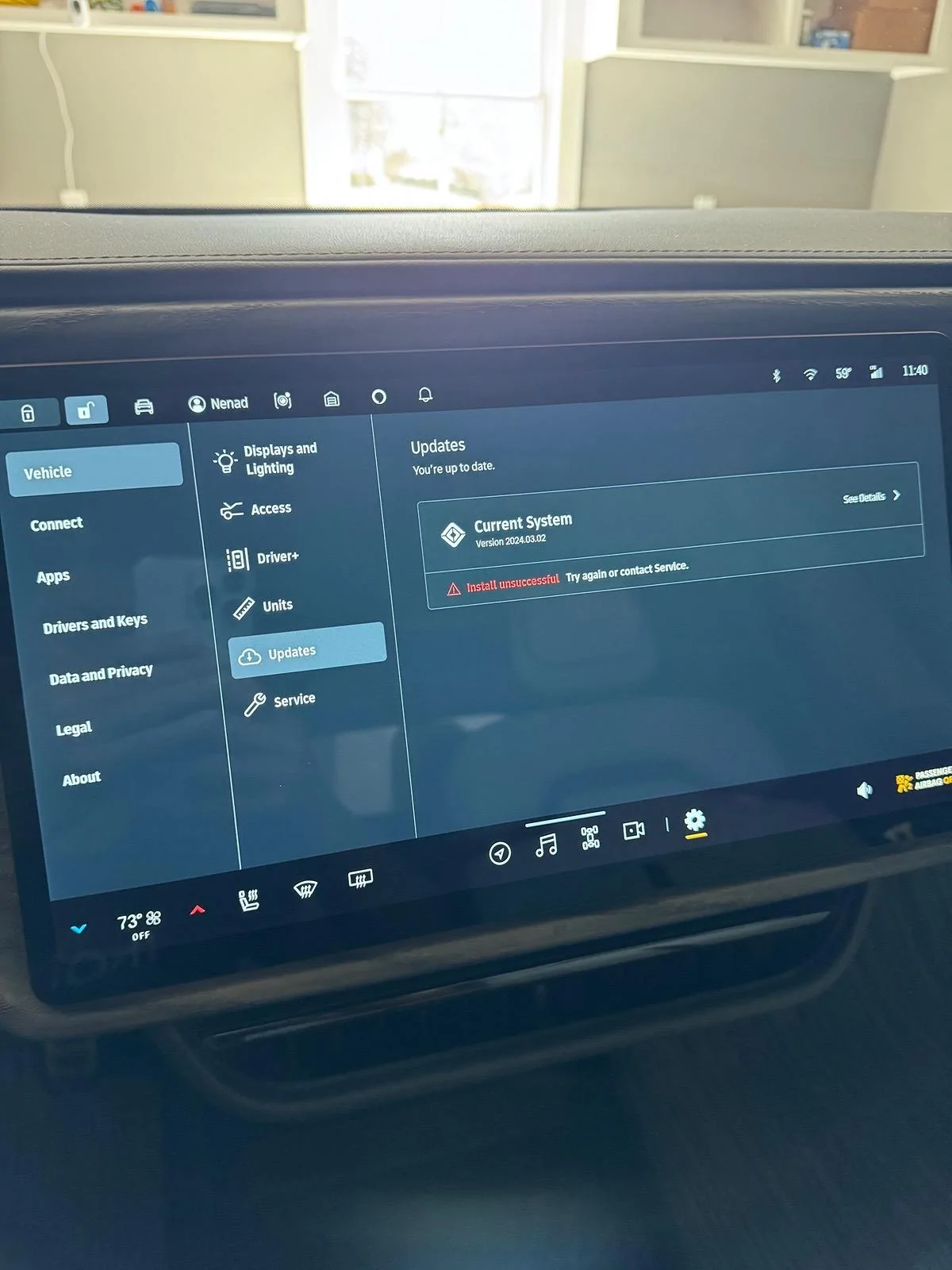

Well, that doesn't make any sense that your vehicle is less than one month old and on software version 2024.03.02
That's from February last year.
Update History
It’s not, I’m on the previous version 2024.47.30. Installed totally fine last time. Rivian service mentioned something on the backend of my vehicle is blocking the recent OTA from downloading..who knows. I’m assuming it’s maybe the communication module.

Update 2/7: It appears the out of the blue update 2024.51.31 hotfix resolved my OTA update issue. Based on the notes, it seems my VIN was part of the "Fixed a rare issue which prevented software updates from fully downloading even in areas with good connectivity"....we survived another month of avoiding the service center!! LFG!
