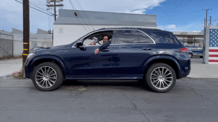

I definitely put a vote in for them to enable this kind of setting/tuning in all-purpose mode so we can keep driver assistance aids. Hell, this should be the "default" ride comfort IN all-purpose. I really hope they update the tuning. I feel like the R1S is either way too bouncy in soft, or way too thumpy/clunky sounding/feeling in stiff. Of the two I prefer stiff as at least the bump happens - makes everything rattle - and then is DONE. Where soft makes me feel like a Mercedes in sand extraction mode - and people definitely comment on it.

OK I just learned what the Mercedes sand extraction mode is and now i want that for my R1T. You know to cruise downtown with.
