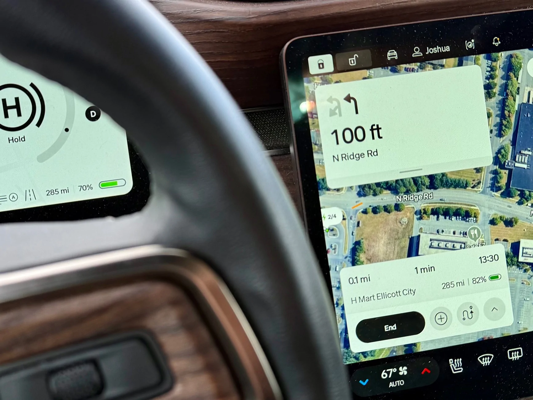

I didn’t notice until today, but I assume it’s since installing the update. When driving with navigation on, it consistently says that I’ll arrive with a higher state of charge than I currently have. The attached photo was obviously taken towards the end of the drive, but it did the same on my drive home. When I got home, I performed a soft reset, so hopefully it will be fixed next time I drive it, but I guess we’ll see.
I suppose it’s also possible that H Mart is just magical like that.

I’ve noticed the same thing but not to that variance. It’s been off by around 2% stating I will arrive with 36% when I’m currently at 34%. You must have a very steep downhill for the last 0.1M to gain that much!

It's junk, absolute dog poo. The longer the trip, the more the arrival percentage increases, even beyond current SOC.

I completed a 1300 mile round trip last weekend and observed no such problems with my Gen 1.

Gen 2. Arrival SoC still works as it did before and is pretty accurate. Only time it doesn't work is if the battery is extremely cold and you get the reduced range warning.
I did do a soft reset post update for a different issue, so hopefully that will do it.

Finally actually left the house today… didn’t need navigation, but remembered to try it out anyway. Looks like a soft reset resolved my problem, or possibly ruined my physics-defying perpetual motion Rivian.

In my Gen1 Quad I've noticed that predicted arrival SOC is much lower using Conserve Mode than it is using All Purpose Mode. That makes absolute zero sense. I don't know if this is new in .46 or some other earlier update. But it's very annoying.

Is anyone still experiencing this? A hard and soft reset has not fixed this for me. My arrival % is displayed as much higher than current traveling %, without any charging stops planned.
