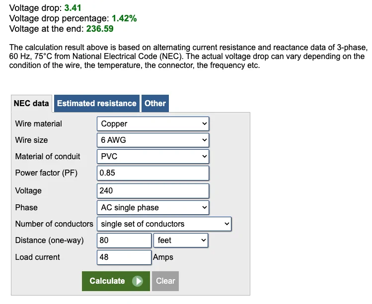

Your electrician isn't wrong, he's doing the right thing by considering voltage drop. But in your case it's not significant. #6 at 1.42% voltage drop is still well under NEC maximum of 3%. Considering that #4 costs more and if done right, he needs provide approved transition from #4 to #6 which will also add to the cost.
I would measure the line voltage at the panel. It may be higher or lower than than 240v. I'd just go with #6 as long as the line voltage is at least 238 volts at the panel.

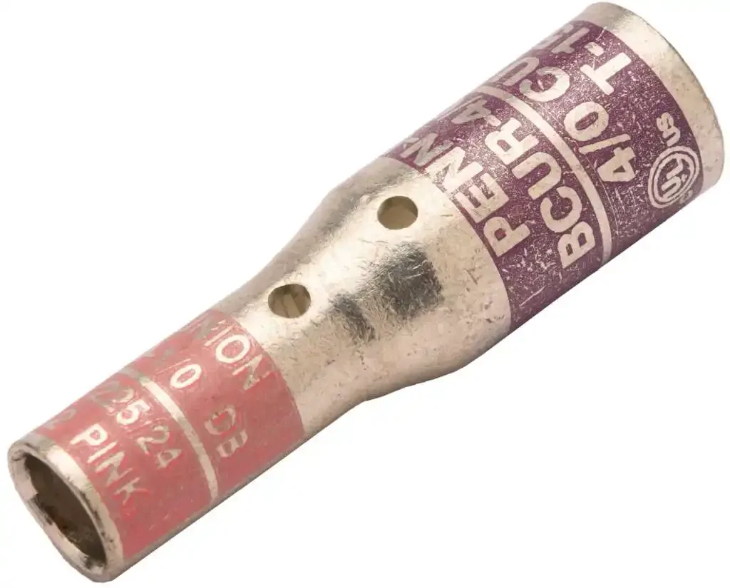

I've also done it the hacky way on car stereo installs, but yes, these are better:
https://www.elecdirect.com/lug-comp...educing-crimp-splice-4-awg-gray-to-6-awg-blue
Rivian R1T R1S Wall charger wire gauge question 1774713154898-24
I'm pretty sure it's THHN in conduit, but would stress that I would be very happy to have 20% faster as cost is not a consideration in this specific case. Thanks
Oh for sure, if he's already doing 6awg THHN in conduit, might as well charge at 48A.

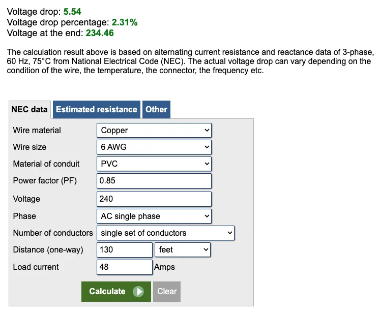

Update: I was given a more accurate measurement and it’s actually 130 feet. I suspect the answer is still to go with 6 awg, but thought I would ask the experts here to be sure. Thanks!
Still within NEC under 3%, I would run #6 and avoid the other issues.
Or..... go bigger by installing a 100A subpanel if there is the possiblity of future loads, and then that easily transitions to a short #6 for your EVSE. That was my solution. I now have a 100A subpanel in the garage.

That 130 ft distance requires 5 gauge, so you'll need 4 gauge copper. You can run 4 gauge wire to a small 2 or 4 space sub-panel. Then 6 gauge to the charger. That will pass anyone's code and give you max voltage.
this is what I ended up doing.
