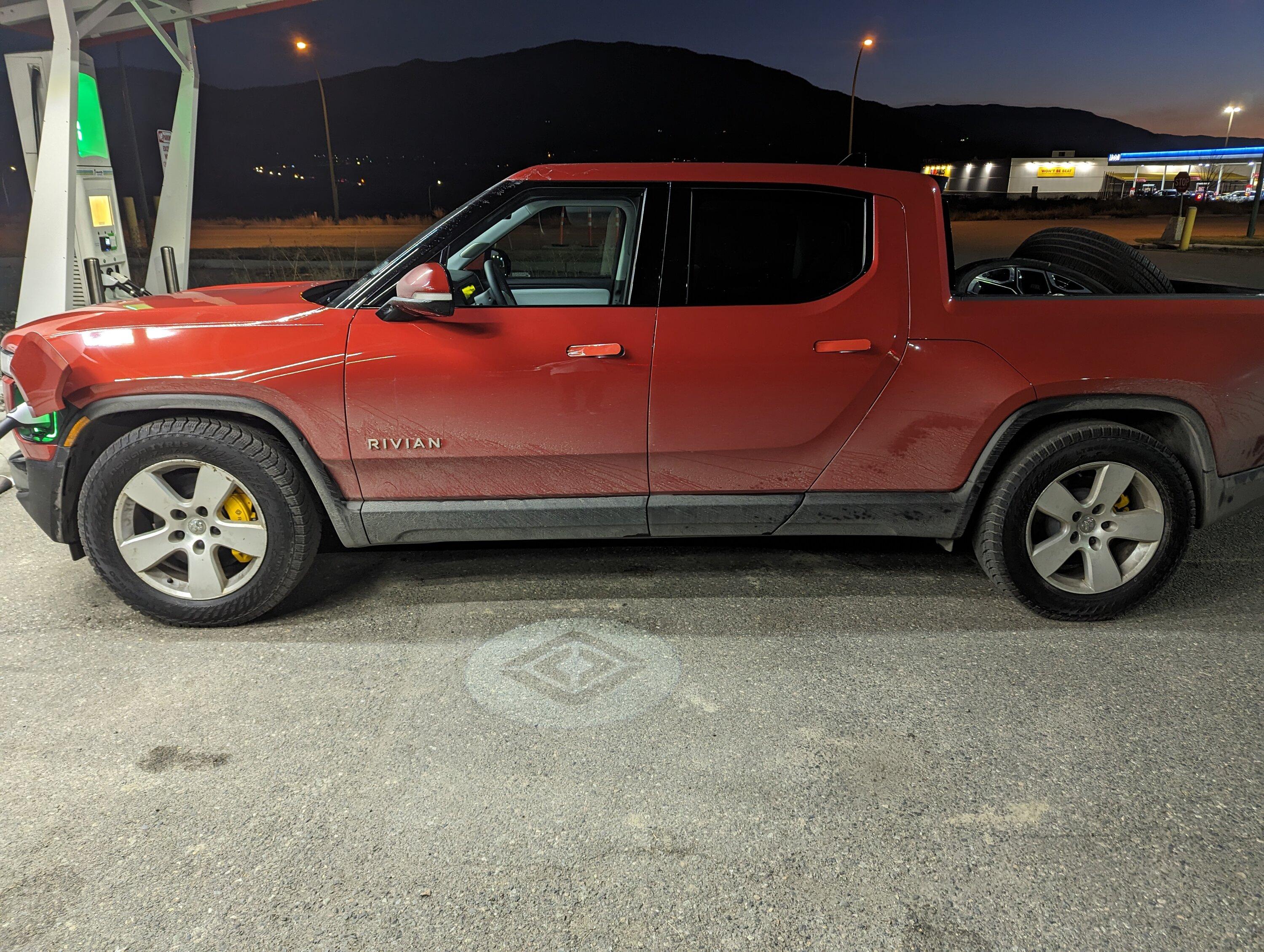

I picked up my latest batch of 2363 wheels with Pirelli AS+3 275/60R20, a 115 load index, and talked to their tire/wheel guy who worked at Discount Tire for 8 years before joining his friend in the powdercoating business. The dude is a walking encyclopedia of wheels and tires, so I had to ask about this topic. Tldr; nothing to worry about.
I expressed concern about the Ram 1500 rear GAWR being less than R1T, and the wheels taking more pressure. He immediately said "Oh those wheels? 2363s can take over 3600lbs per wheel. They way overspec wheels for the tires you put on them. We used to put 125 load index tires on the Rams with these. I'd be more concerned about what tires you put on there, these wheels are fine." He rambled a bit about my Wildpeaks and spat out numbers on them, he's a big fan of them from his experience. He pointed to the thick spokes and talked about wheel construction,
Granted it's all hearsay, my concerns are alleviated.

Let's just pretend they don't meet weight ratings, because they're ugly AF and make our Rivian's look cheap.
Problem solved!!
(that's just like...my opinion man)
Here's my 2363s with snows. I like this look a lot. So did the guys at the tire shop.
Rivian R1T R1S Weight rating RAM 2363 wheels? PXL_20231118_010249689.MP
