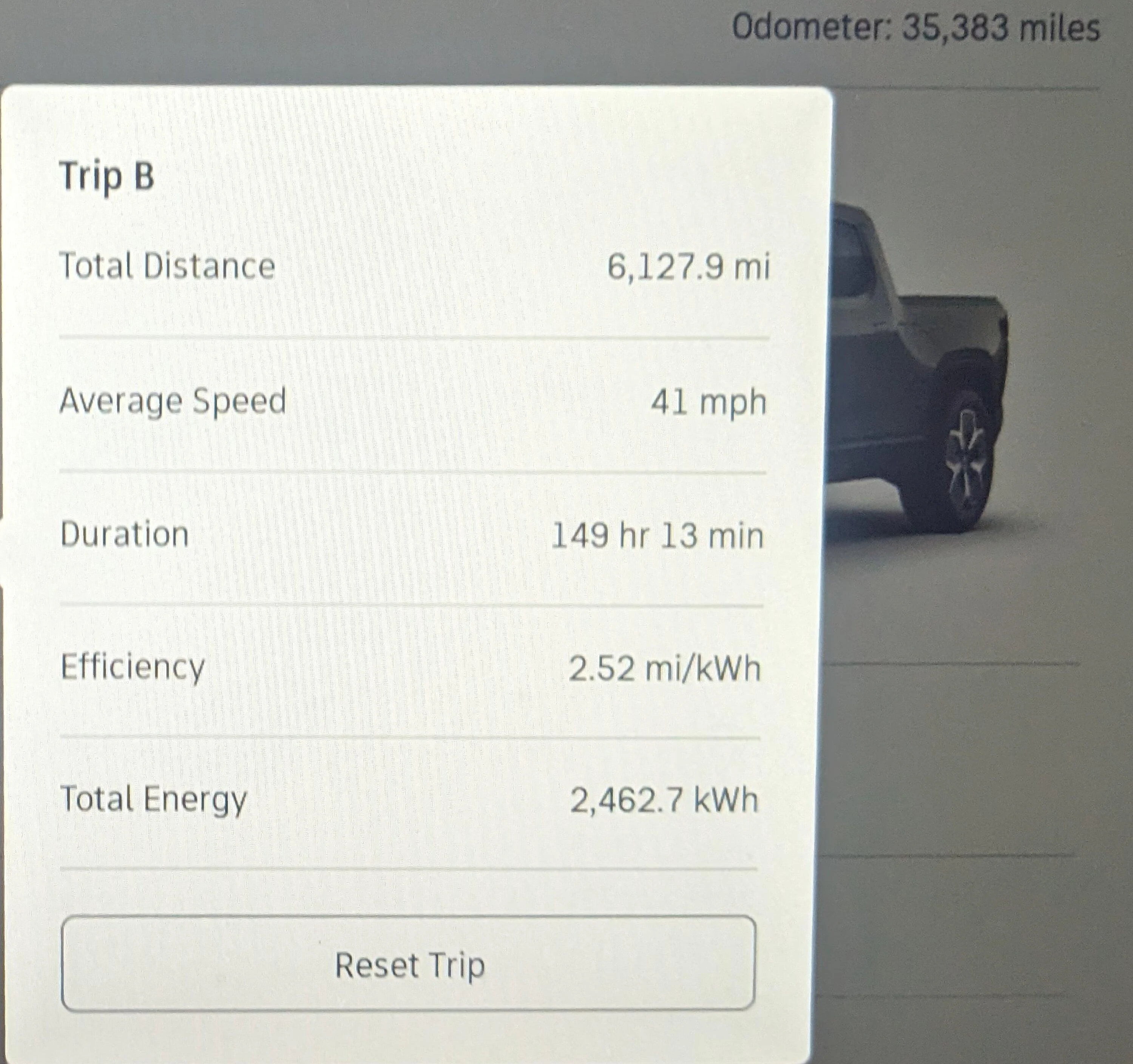

Thank you all for your service, been thoroughly entertained reading these posts. Riviot - what was your long term efficiency results on that lite weight setup you had on previously?
OEM 20" staple wheels with Pirelli AS+3 275/60/20 gave me 2.45mi/kWh over summer. It dropped to 2.35 as soon as October hit with cooler temps.
(This was taken at pickup after 21" wheel calibration, but based on 20" AT diameter of 34", so divide miles and efficiency by 1.03 to correct)
Rivian R1T R1S Weight rating RAM 2363 wheels? PXL_20231025_155003633~2
I'm currently at 2mi/kWh on the 2363s with Falken Wildpeak AT3Ws 275/60/20 calibrated to 21s for the correct diameter for efficiency and speedo accuracy. My big question is what the 2363 with AS I just had made will do in comparison... I probably won't test until spring when it's time to rotate, changing 8 tires just to test now doesn't sound fun.
