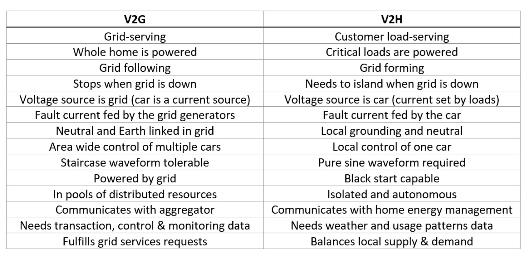

Seems like you are asking for V2H, not V2G.
V2H will allow you to power your home from the Rivian
V2G allows your utility company to "borrow" energy from you battery to balance demand.
https://energycentral.com/c/ec/v2g-v2h-what’s-difference#:~:text=While in V2G the car,large power plants supplying it.
