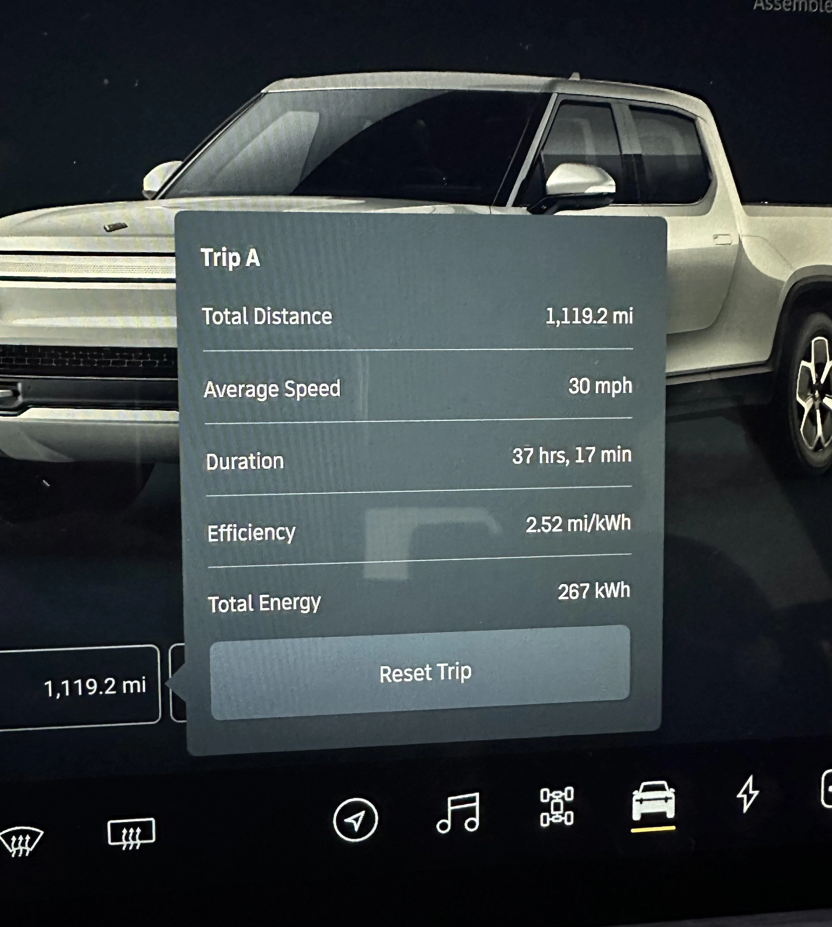

Trip A shows 43,000 miles and 2.38/kWh efficiency. Mixture of AP and Conserve. Driving is combination of two lane highways, interstate and some city driving. 20s. At 25,000 miles switched from AT tires to a hybrid (AT/Road) tire. Gained approximately 10 percent when I changed tires.

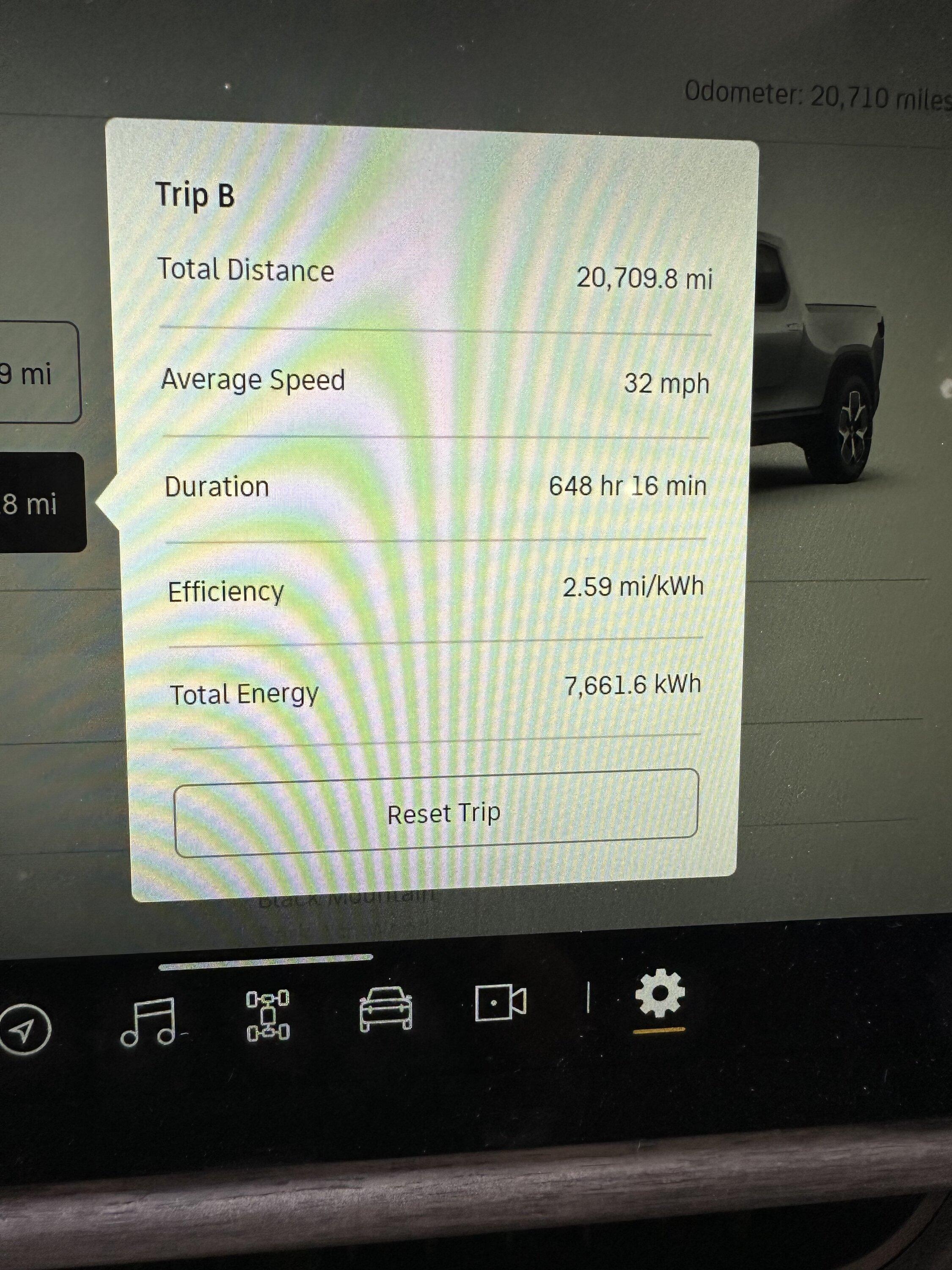

I think I'm cheating with 20" AS, but just got my average up to 2.5 mi/kWh today, and that's correcting for the 3% radial delta.
