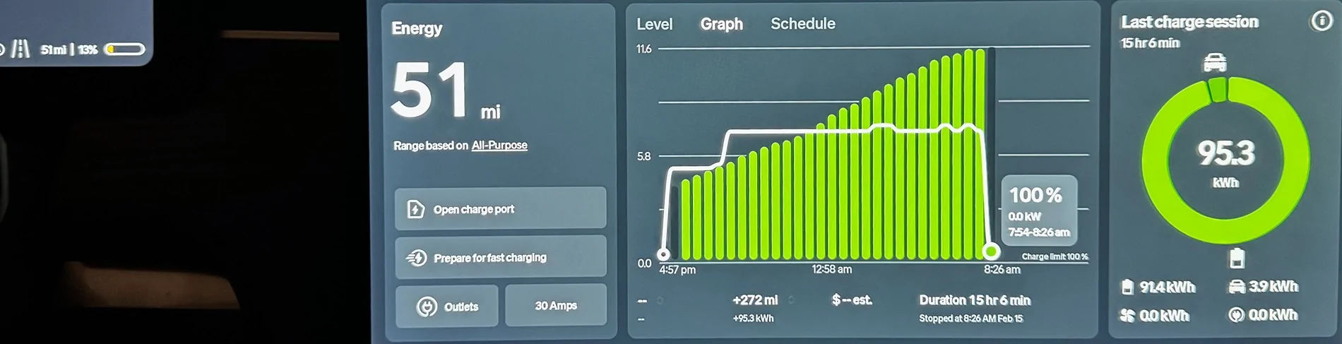

Yes, beneath the yellow circle. The Energy Monitor shows how much power is consumed by the car, the HVAC, the electrical outlets, and gear guard. Perhaps Hudesigns can post a photo that is zoomed out a bit more.

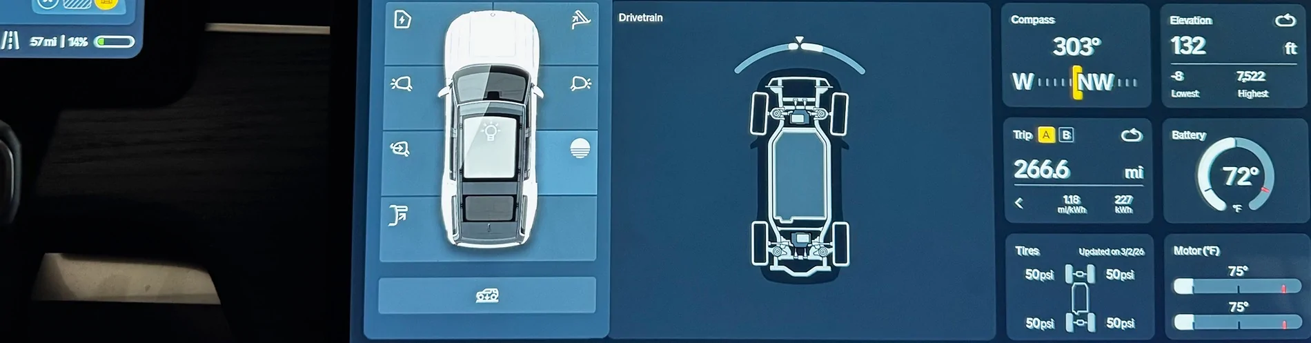

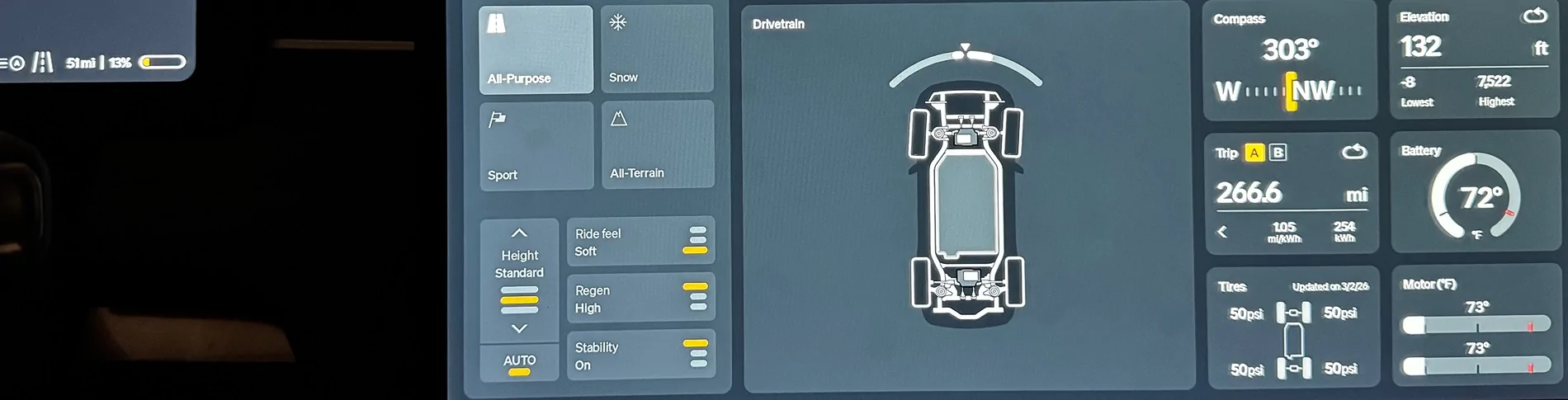

For my 3.5-hour time window on Thursday, the Energy Monitor screens showed the driving energy was 0.8 and the parked energy was 0.3. However, the Trip Meter logged a bogus 10 "traveling kilowatts". My travel efficiency was also bogus [1.0 divided by 10 = 0.16mi/kWh], and the projected range dropped just 2 miles. If I'd actually used those 10 kilowatts, the range should have dropped 20 miles or more.
FYI: RivianRoamer.com provides nice detail on each drive I make, but nothing sheds light on the mysterious extra "traveling kilowatts" that are logged while the car is parked.
It should at least tell you if you're vehicle is sleeping or on the daily view.

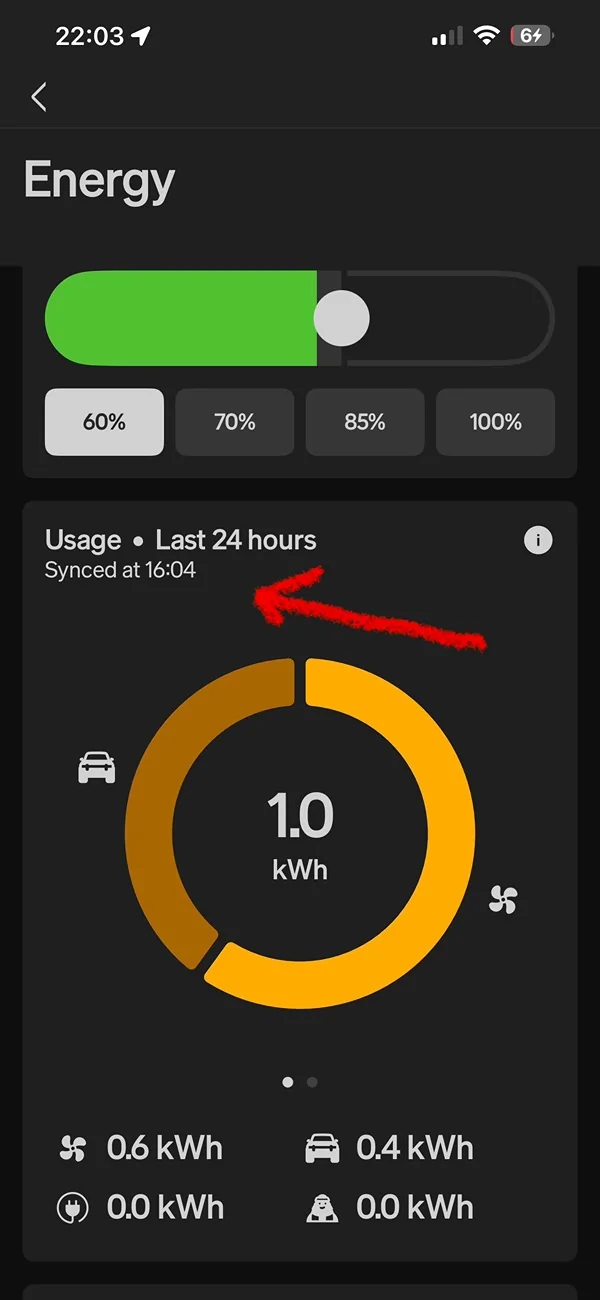

Stay like this for a few days now. I can never be certain when was last update. Absolutely need a date, year info there!

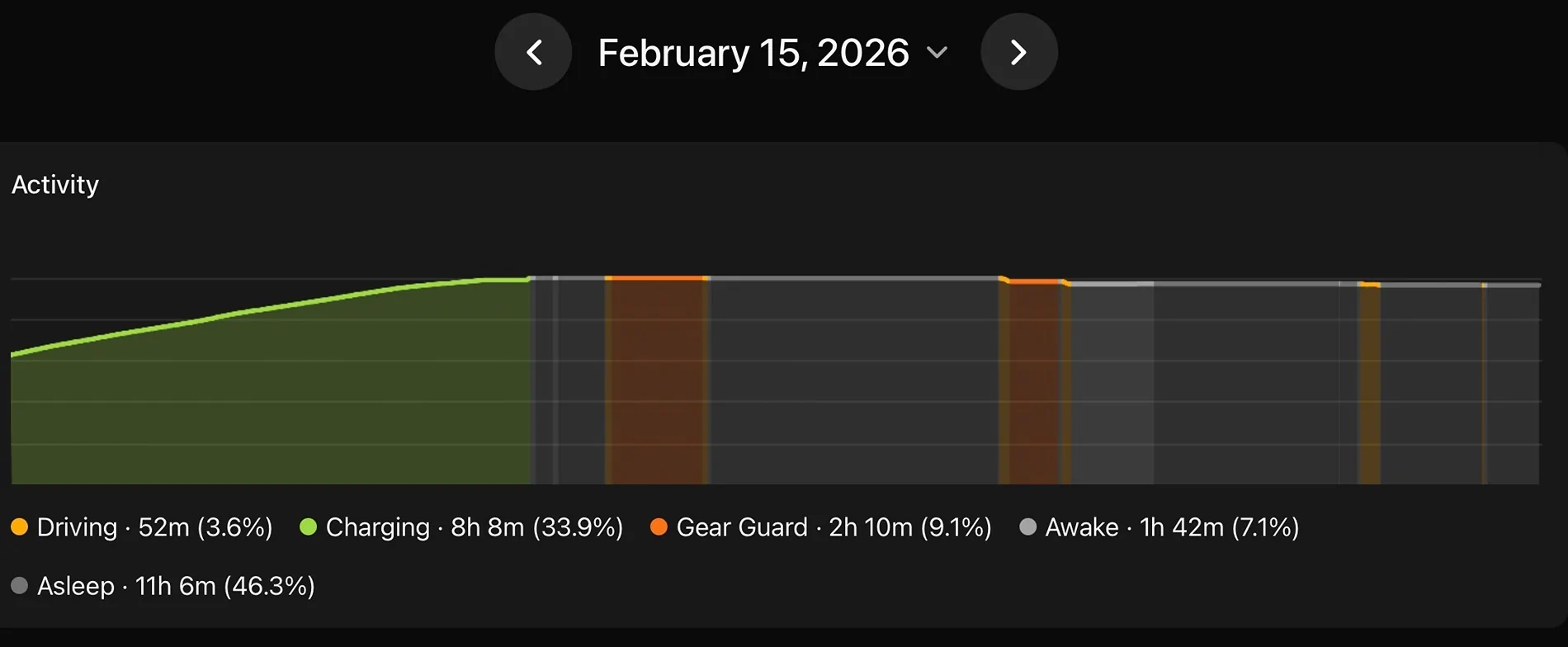

Yesterday, I charged to 100% and made a couple short drives. Over the last 24 hours, my car used just 0.7kWh while parked. My car now has 96% remaining, with a projected range of 399 miles. I used 1/25th of the battery. My Trip Meter says I used 14kWh...10% of the battery. At this rate, I might "use" over 300kWh on a single charge! [14kWh multiplied by 25 = 350kWh]

Thank you Rivian Roamer. I went back into your website and did find the detailed look at my car's day. I love the detail! My apologies for missing it.
Just two things (cents) here:
1) Rivian Roamer is the best :)
2) The Activity graph definitely looks nice and normal. So probably just bad Rivian math?

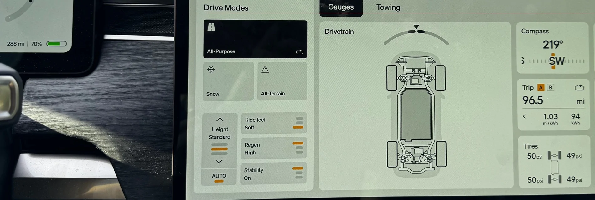

A fellow Rivian owner, SurfnBike, posted his Rivian has 20,000 miles and his Trip Meter reads 25,000kWh! He has it worse than me, for sure. I am running a test from 100% SOC. At 70% SOC, my car has logged 94kWh...on track to at least double my battery's storage capacity. I opened a service ticket, though this is likely above the scope of a service center.

Doesn't that 94 kWh include regen?
On the Energy Monitor tab, you can see how much energy has been used in the drive. Some of that energy is from regen, not battery use. I am pretty sure that 94 kWh matches what is on the Energy Monitor tab.
Which means you have not used 94 kWh of battery. You have used 94 kWh to move the truck 96.5 miles, with some of that coming from regen.
I wish Rivian didn't report energy use that way. It really means nothing. What we care about is how much battery is used, not how much energy is used. At least that is what I care about.
It is so, so confusing.

Interesting software bug, definitely. Keep us posted!
Normally that counter will subtract regen from the consumed, so it will tell you NET kWh.
