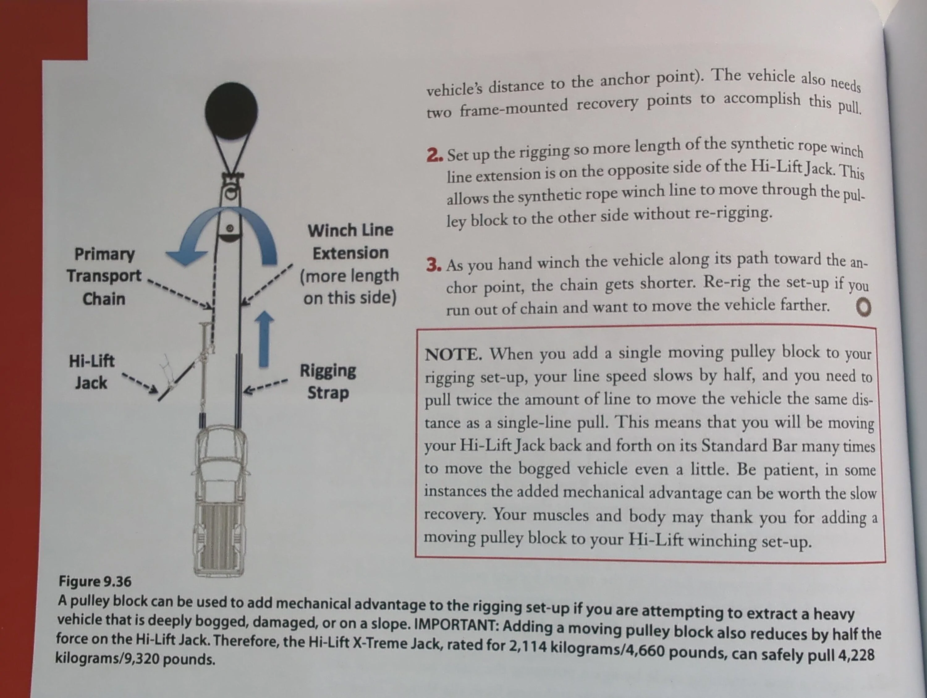

- a winch is great, but if you're like me and not ready to go crazy with aftermarket mods, consider a double line pulley with the Hi-Lift jack (example below)
