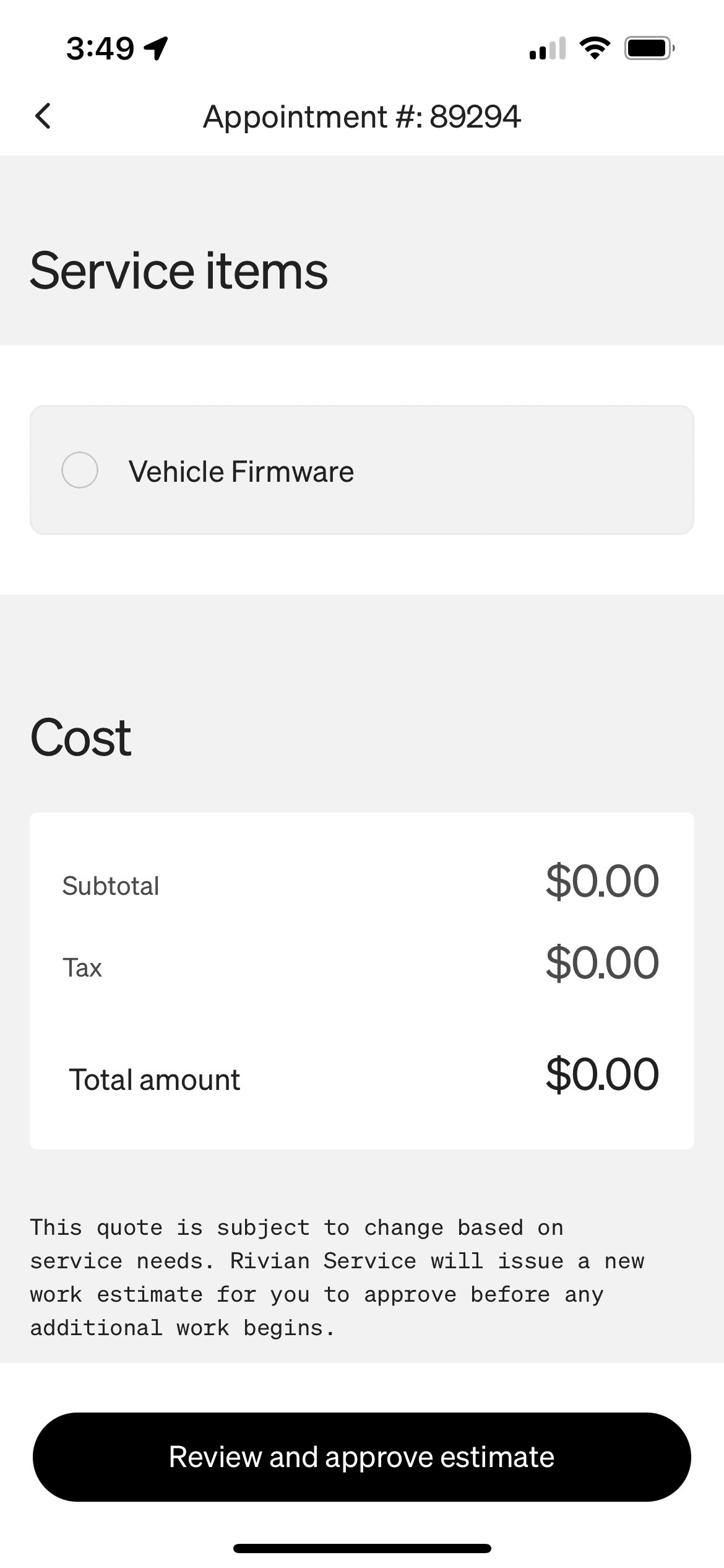

OTA for the tire swap was a no go. Mobile Service will make a complimentary house call to update my vehicle configuration.
Do you have that it writing? Because I’d like to see that in writing to update my upcoming service ticket. :)
Mobile Service Appointment
