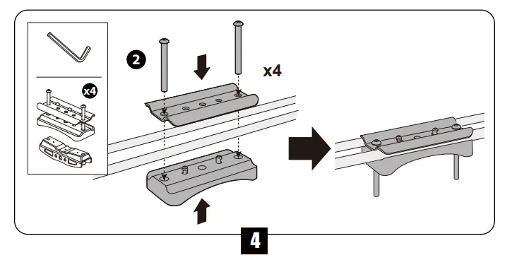

Just another quick question how to did you figure out these are M6 bolts? Or are you guessing? I might just order shorter M6 bolts instead of trying to cut down the longer factory bolts...
Installation instructions on the link you sent.
Those are for the front wind deflector bar and mounting clips. The 8 bolts for the brackets around the crossbar it does not say what size unfortunately. But based on this it's probably safe to assume M6 as well.
Oops. Ya, all the rest of the bolts are M6 so I think you would be making a safe assumption. Weird they dont specify for those bolts though.
