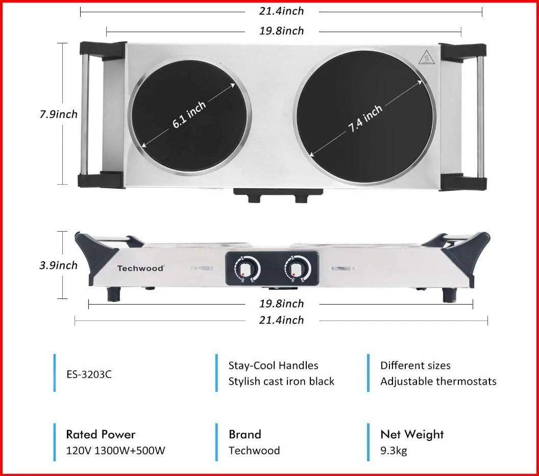

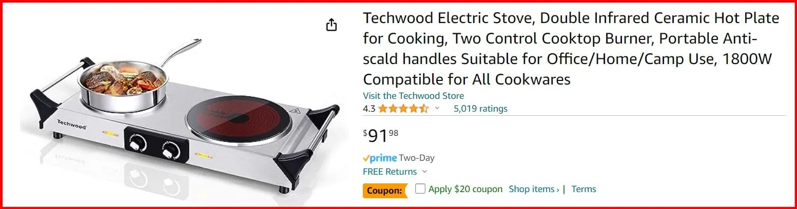

I just ordered the dual burner 1800W from Amazon. I was going to use it when I go camping next week however looking at the R1T User's manual it reads "Don't use a device that requires more than 1500W..." Does this mean I have to return this 1800W burner I just ordered? This probably was a stupid question but my knowledge of electricity is nil. I don't even understand the difference between watts and amps, lol. Do you have any recommended burner that works with R1T? Thanks guys.
Rivian R1T R1S Will this cooktop burner work with Rivian? Screenshot 2023-10-19 172626
Rivian R1T R1S Will this cooktop burner work with Rivian? Screenshot 2023-10-19 173911

you will be ok as long as you don’t put it on the highest heat setting. If I put mine too high I can hear it cut out

Exactly this. It's a pure resistive load, no motors or capacitors or inrush current or anything like that. Turning the dials turns up the watts. As long as you don't turn it too high on both burners, you're good.

According to the spec, as long as you’re not using both burners at the max setting at the same time, you’ll be fine.

1800w is too much pf course. I would either go with something just under the limit or hook up a kill a watt at home and experiment with how much power it pulls on different settings.
Most likely you will only be sble to cook with one burner on high and the other on warm.

I bought a dual burner induction cooktop rated at 1,800W, but my home energy monitor tells me it draws about 1,700W in practice.
I’ve cooked on it at full power using the Rivian with no negative side effects.
