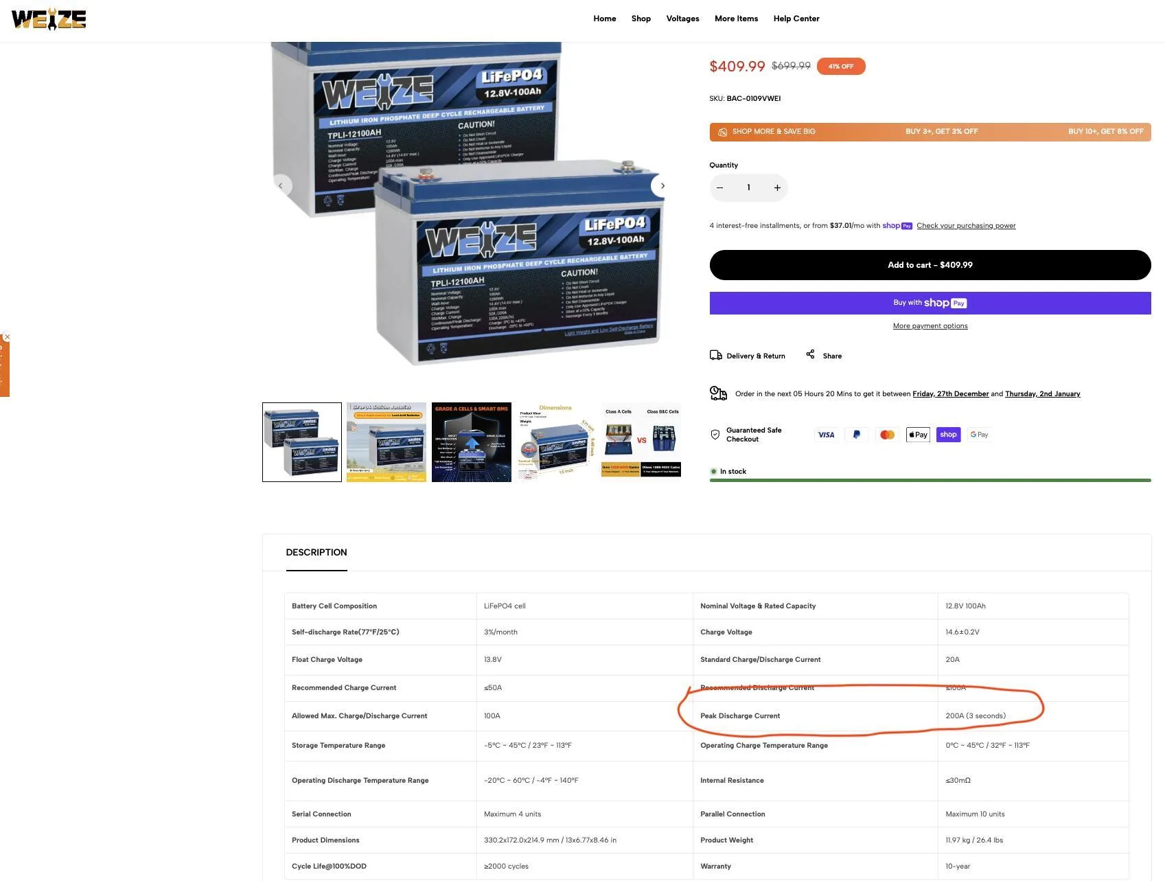

Sorry, but the LFePO4 batteries recommended DO NOT have enough current output to drive these winches. Max 200 amps for 3 seconds isn't going to get the job done. These are "Suitable for Trolling Motors, RVs, Solar, Marine, Camping, and Off-Grid Applications". They're not for the instant power needed to start a car or in this case, drive a winch.
Rivian R1T R1S Winch attached to R1T trailer hitch 1735062127889-px

Maybe, maybe not. There are other options too. I've used it with a small winch, but not a huge one. I've measured power usage on a winch and it's never as high as they claim. Also, current rises quickly when voltage drops, and AGMs drop voltage HARD. The lithiums do not. You will use lower current with them than with AGM. Watts are what measures work. Amps are the way we get the watts needed at a certain voltage. An AGM often drops below 11 with real loads, and the Lithium would be much higher.
