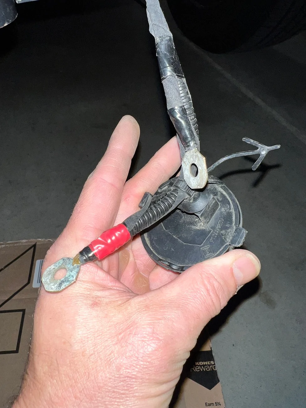

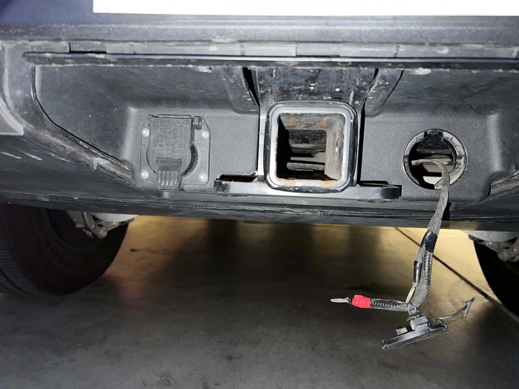

I was recently exploring my trailer hitch and found a jack point cap. After popping the jack point cap out I found it was attached to a two wire harness. What are these two wires for? See pics.

It's in the owners manual and tow operators manual:
