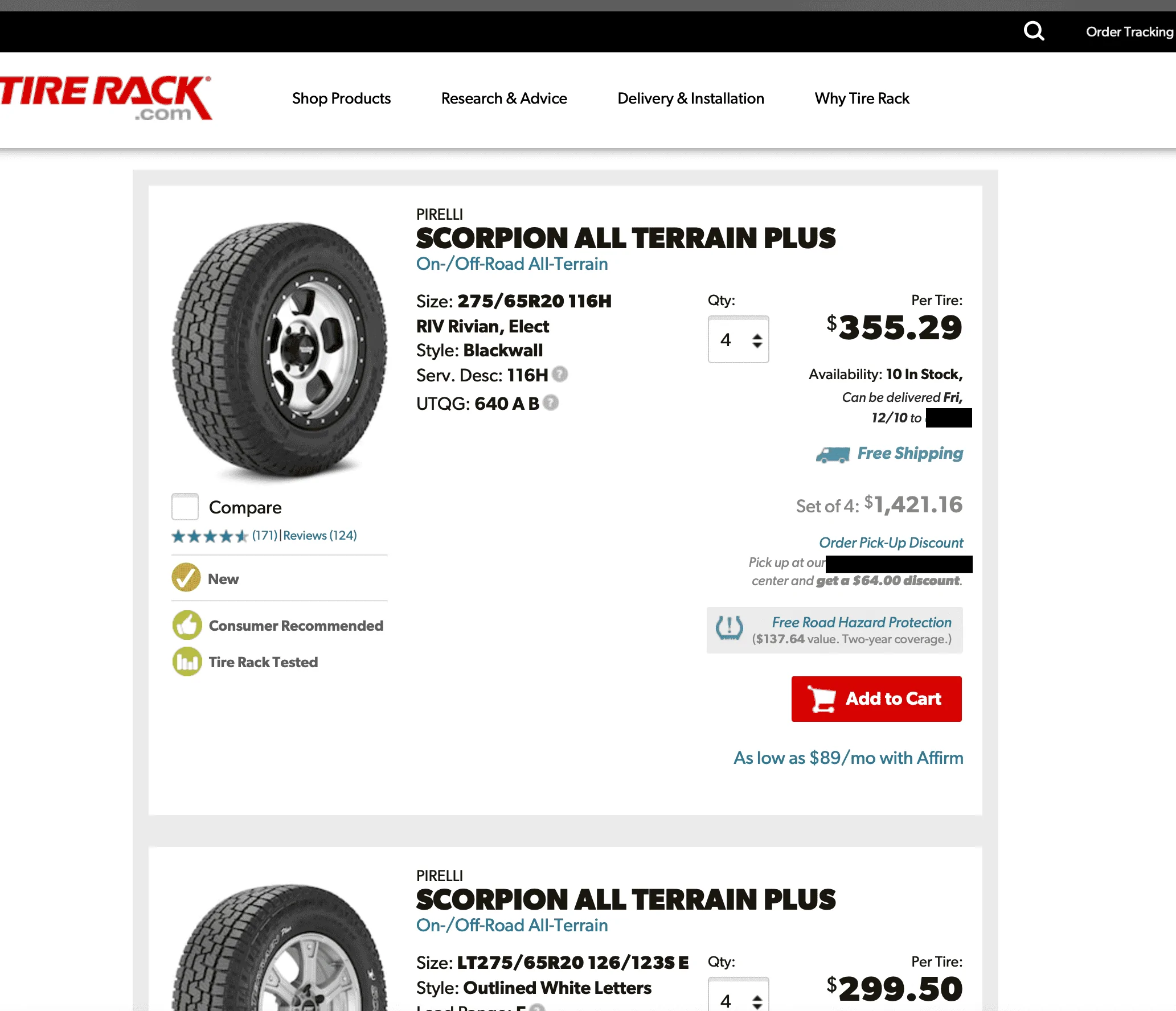

We buy tires distributor-direct for all our trucks. But just for grins, I checked a couple other options... Here are the Rivian 20" Scorpion ATs on Tire Rack. I can have a set here end of week if I wanted. So it doesn't look like these are going to be special or hard to get and they have definitely replaced the 275/65-20 118T in the Pirelli catalog.
Rivian R1T R1S Winter/Snow/Ice performance rivtirerack
Kinda pricey though. Says Rivian. lol...

Wow. Those are expensive tires. At least for what I am used to.
AT tires are not cheap, but those are still $45 less than the same sized Falken AT3Ws.

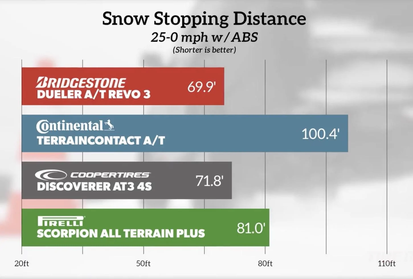

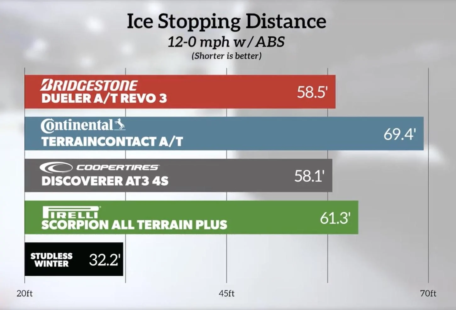

I think that the 20" all-terrain tires are fine for occasional snow but they're no substitute for true winter tires. Tire Rack tested all-terrain tires a couple of years ago and found that the Pirelli performed worse than other tires that don't carry the 3PMSF symbol. On ice, the braking distance with the Pirelli is almost twice that of a studless winter tire.
Rivian R1T R1S Winter/Snow/Ice performance TireRack-IceBraking
Rivian R1T R1S Winter/Snow/Ice performance TireRack-SnowBraking
