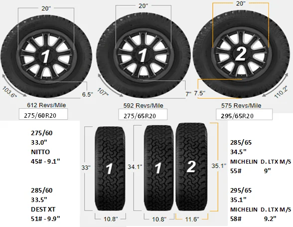

Agree, can go up to 295/65...tradeoffs and many options spread out between 33-35" sizes:
Sweet spot is ~55#s and 10" width...

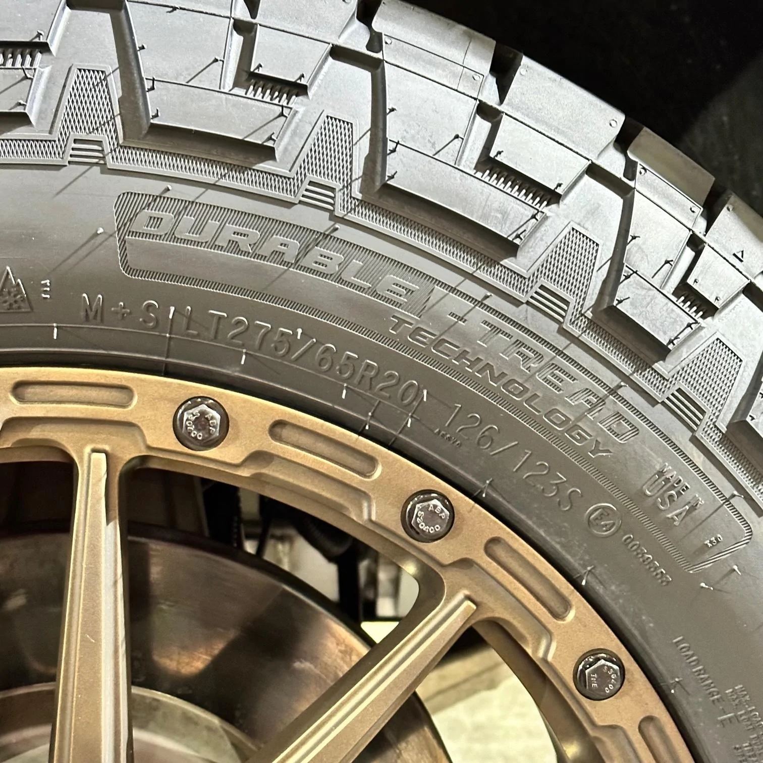

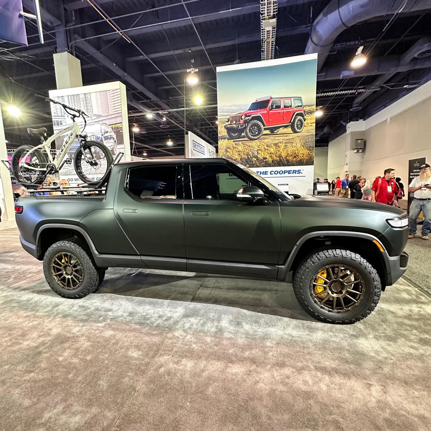

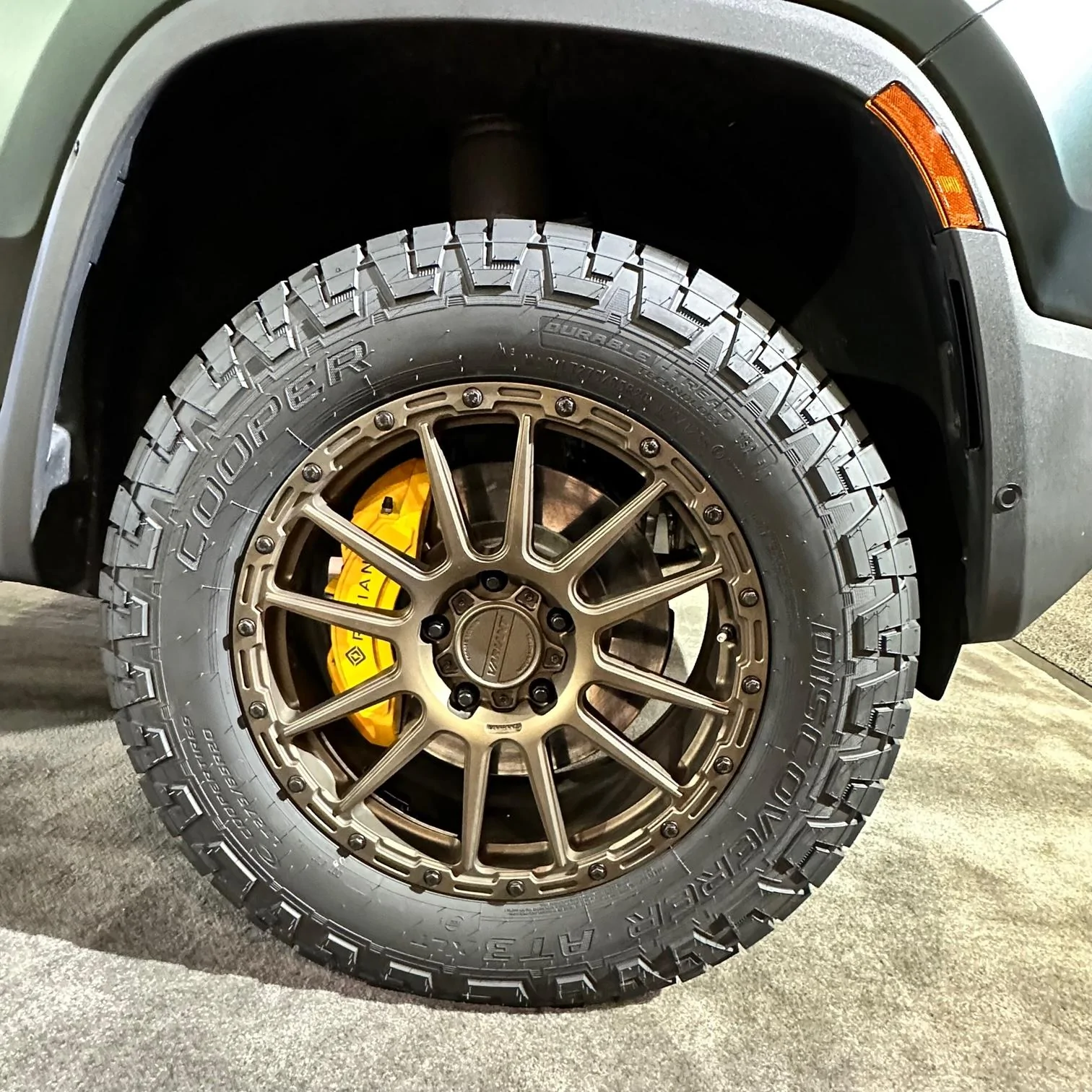

Why not stick with a true 34" AT (with some meat) in a Load Range E, 34" and crank up the tire pressure to make up for most all of the efficiency loss? This is what I have done and sit right in the middle of the efficiency range in the chart above.....28,000 miles in. Smooth ride, quiet, wear pattern excellent....Cooper Discoverer AT3 XLT 20's.
Rivian R1T R1S !¿ Best 20” AT Tire for Range?! ??? IMG_0266
Rivian R1T R1S !¿ Best 20” AT Tire for Range?! ??? IMG_0267
Rivian R1T R1S !¿ Best 20” AT Tire for Range?! ??? IMG_0268
