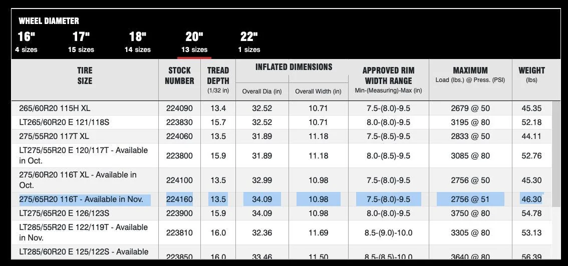

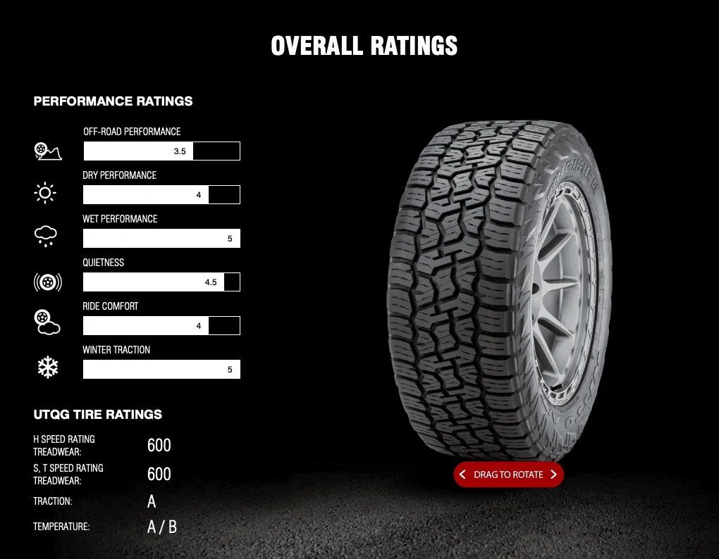

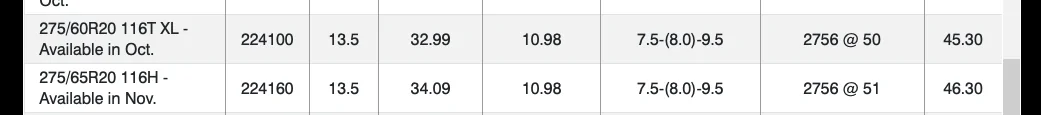

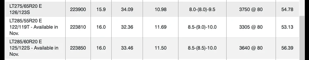

I just noticed there will be another AT option available to us in November, from Nitto: Terra Grappler G3 in 275/65R20. 600 UTQG. 116H. Non-LT with a max pressure of 51 PSI. Also, there will be a 60-series XL (116T) version coming sooner, in October, 50 psi max. The tires weigh 46.3 and 45.3 lbs respectively. The factory ATs are said to be 48 lbs. Both are 3PMSF.
LT275/65 and LT285/60 (Nov.) are also available, but heavier.
Sorry if this has been talked about already... Too many tire threads and I don't keep track of them all.
Rivian R1T R1S !¿ Best 20” AT Tire for Range?! ??? Screenshot 2024-09-07 at 7.25.55 PM
Rivian R1T R1S !¿ Best 20” AT Tire for Range?! ??? Screenshot 2024-09-07 at 7.35.03 PM
Rivian R1T R1S !¿ Best 20” AT Tire for Range?! ??? Screenshot 2024-09-07 at 7.32.22 PM
Nice find! That 275/65 in 116H is definitely what I’ve been waiting for.
Looks like they just updated the site and changed that second one from 116H to a 116T... stock number and all other specs are unchanged.
275/65R20 116T - Available in Nov.

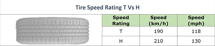

Rivian R1T R1S !¿ Best 20” AT Tire for Range?! ??? Tire-Speed-Rating-T-Vs-H-1
Now, this *shouldn't* matter for us as we're speed limited below 118mph, but I've seen some tire shops argue that they won't install T-rated tires because it's below the OEM speed rating of H... Hopefully that doesn't happen because I'm really looking forward to these Nitto G3's.
That’s unfortunate. But right about the software governor. Independent shops are generally more accommodating than big chains. The LT is still viable and about similar weight to other front runners.

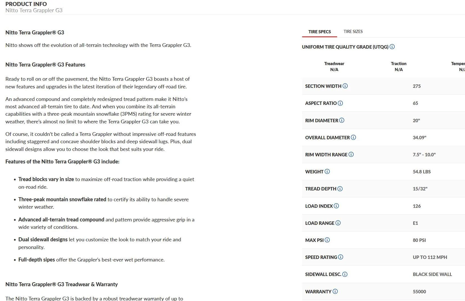

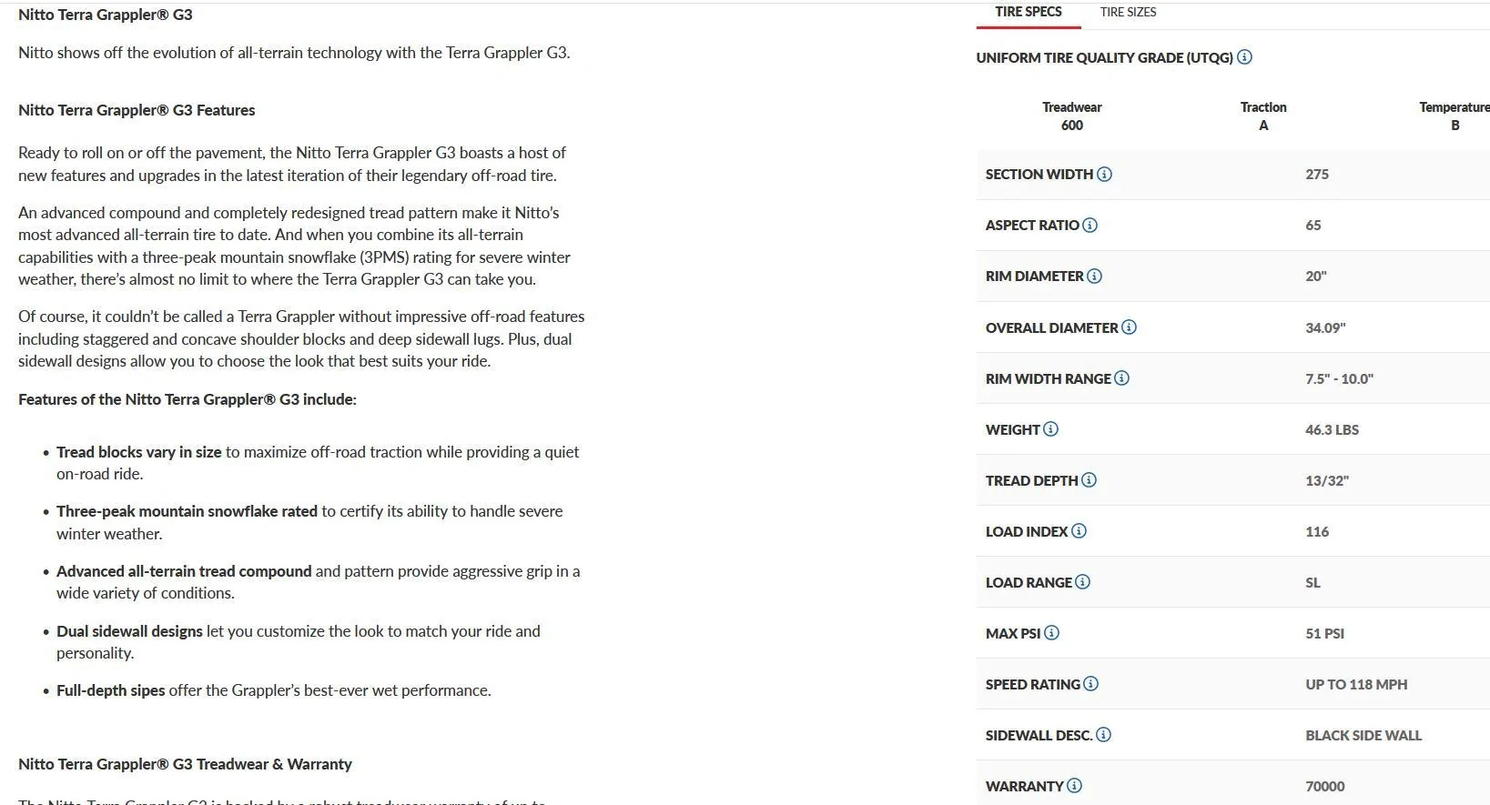

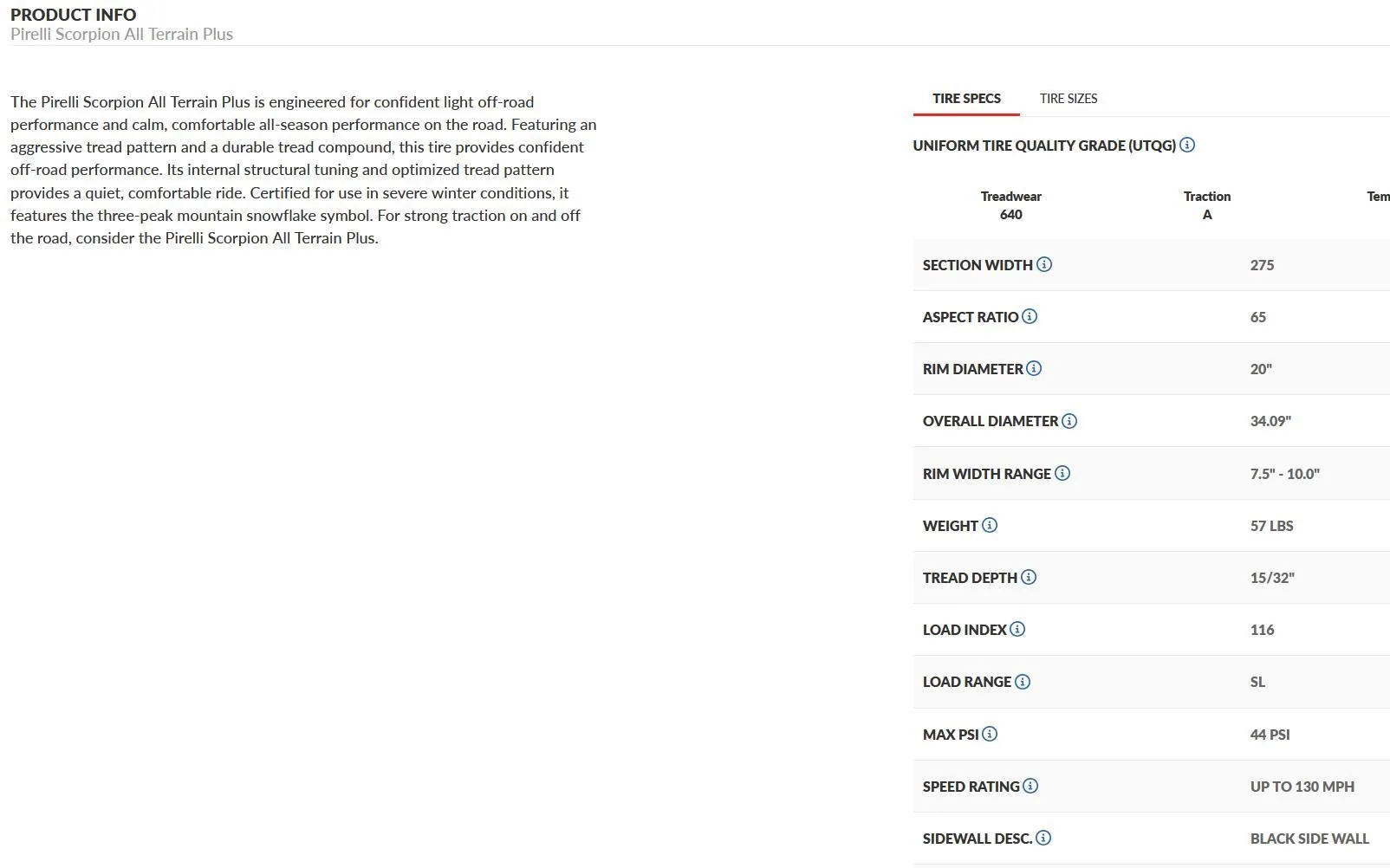

just comparing the OEM 20" with these G3 (spec sheets from Discount Tire site):
PIRELLI SCORPION ALL TERRAIN PLUS:
Rivian R1T R1S !¿ Best 20” AT Tire for Range?! ??? 1727113388288-sd
NITTO TERRA GRAPPLER G3:
Rivian R1T R1S !¿ Best 20” AT Tire for Range?! ??? 1727113458503-hg
I wonder if the increased Load Range of the Terra Grappler G3 comes with a compromise of handling or noise? Noise is the only real gripe I have with my OEM Pirelli set.
You're looking at the wrong G3. They offer the 275/65/20 in a 116T (standard) load index, which is more comparable to the OEM Pirelli ATs.
