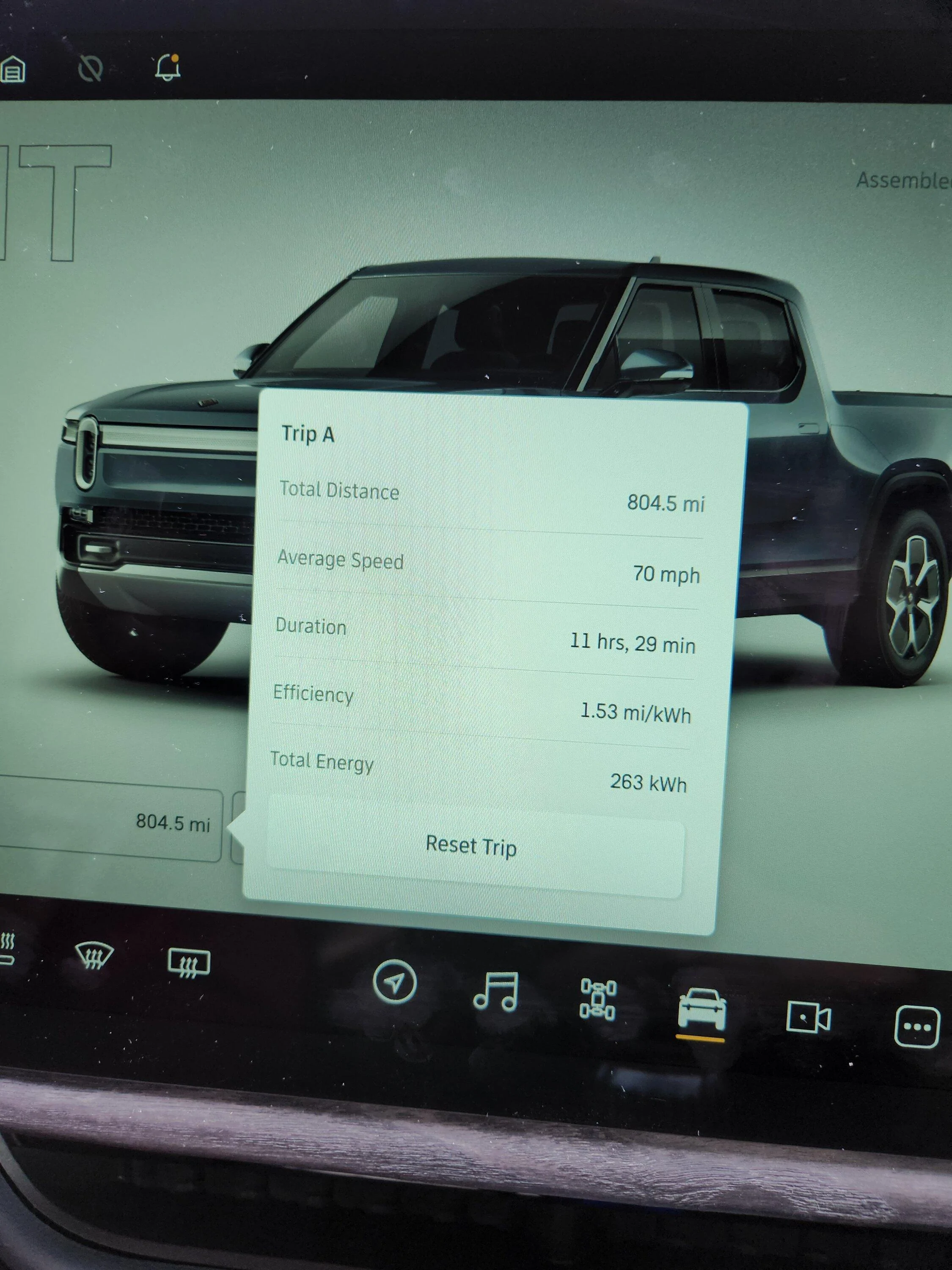

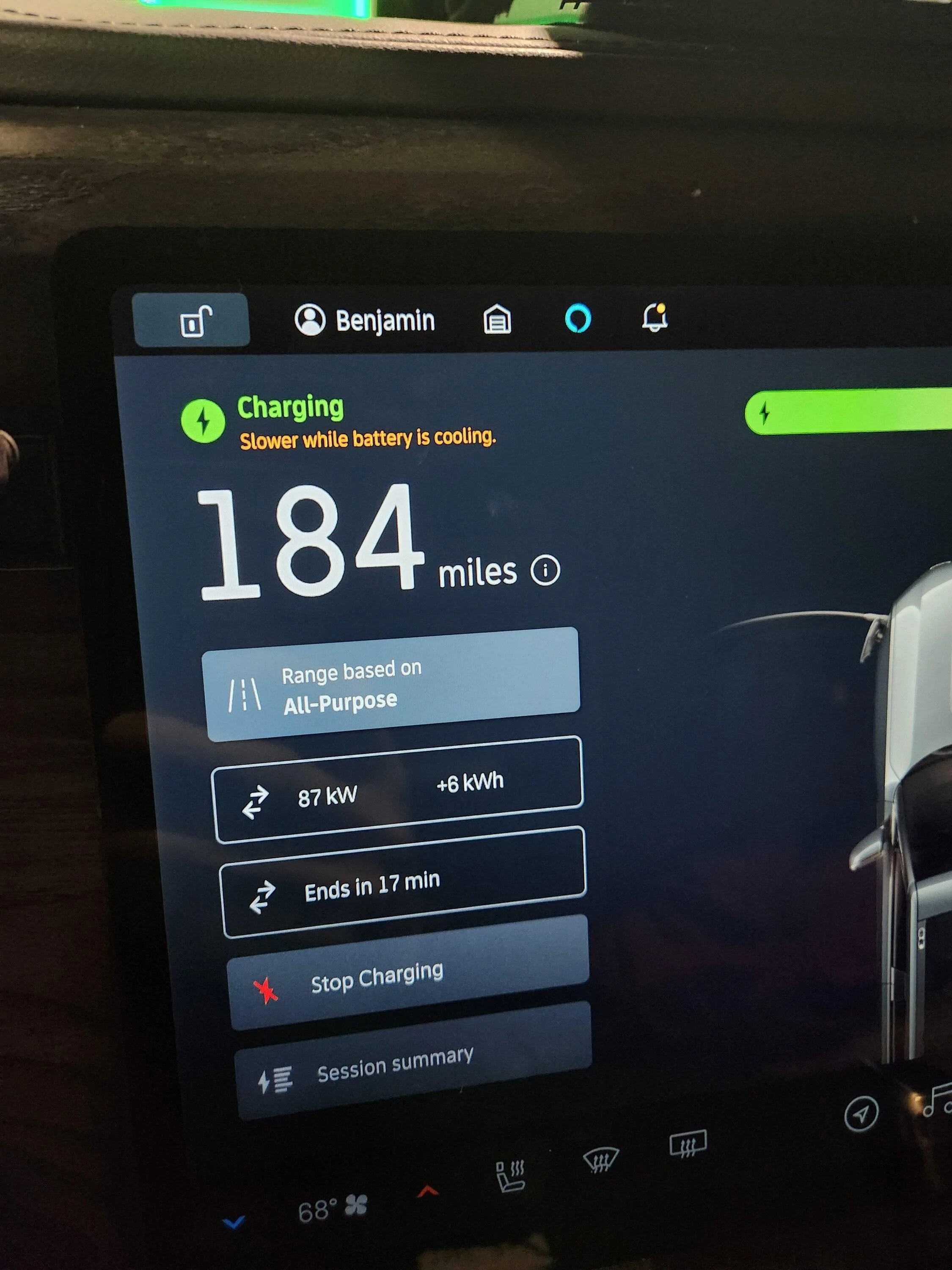

I'm on a road trip from CO to MI. I've been getting crushed on efficiency. Still halfway there, but drove over the last 24hrs mostly in single digit weather, going 75 to 85mph, a headwind, with blizzak-lt, and ram 20" that pokes out half an inch or so. So a lot going against me. Only keeping heat at 68 and driving in conserve at lowest
Rivian R1T R1S 0°F Commute Efficiency 20221221_125356
So stopping a lot more than usual. What makes it worse are the charging speeds with EA. The car keeps saying the battery needs to cool down after a few minutes. Makes no sense. I think it's a car issue, not an ea issue
Surprisingly I've had zero issues with ea so far.

based on what I saw in <10 degree F weather thus far it is almost as if Rivian didn't test for cold weather.
That efficiency, given the challenges you list, doesn't seem too horrible. It's certainly usable, if annoying.
Regarding the cooling of the battery while charging, I've seen OutofSpecKyle note this on several of his Rivian charging videos. It appears they did not size the cooling effectively or design the heat transfer mechanism correctly to sustain high rate charging for longer periods. It's a shame really, as that's something that needs to be right in the absence of 800v architecture.
