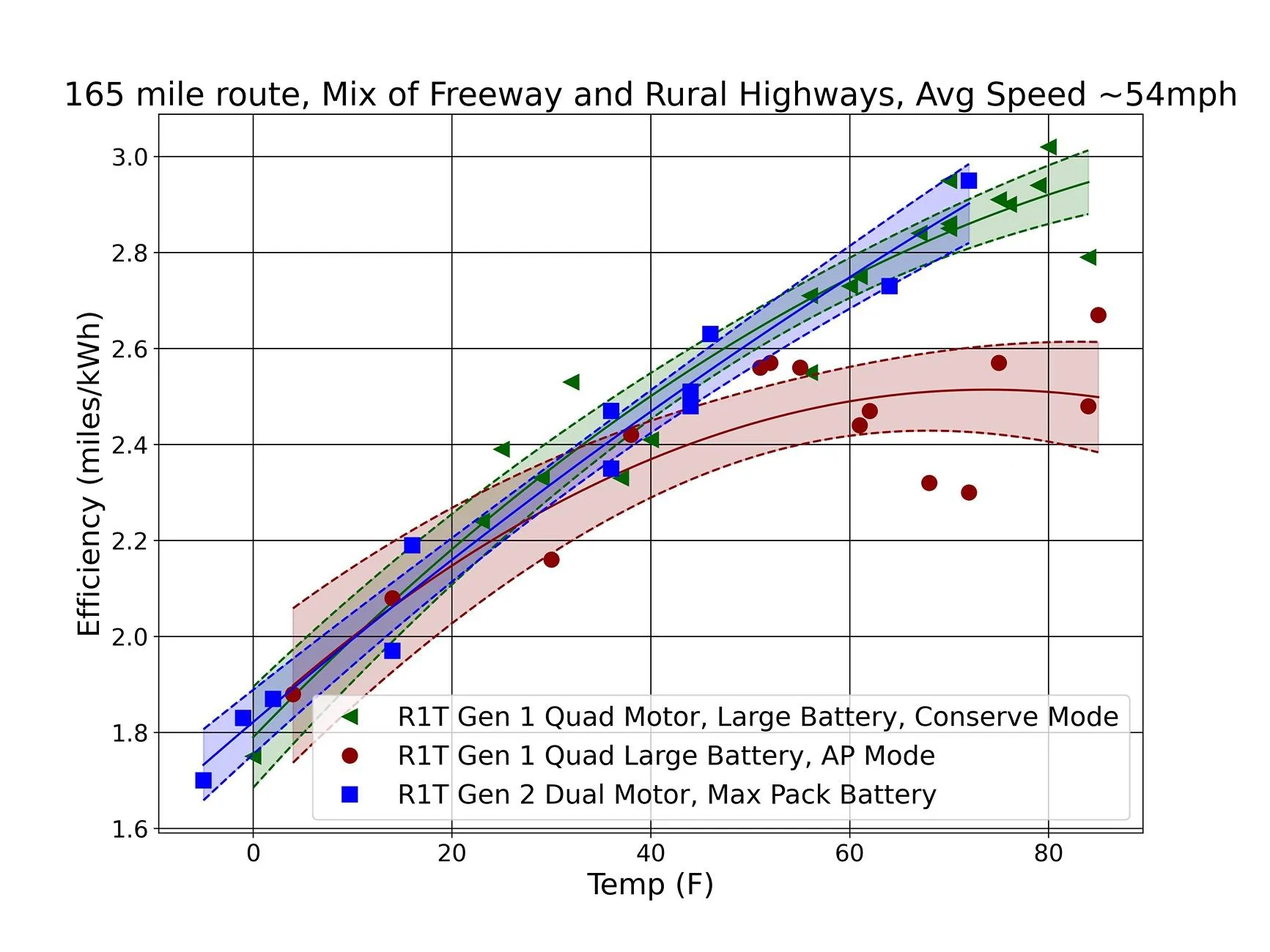

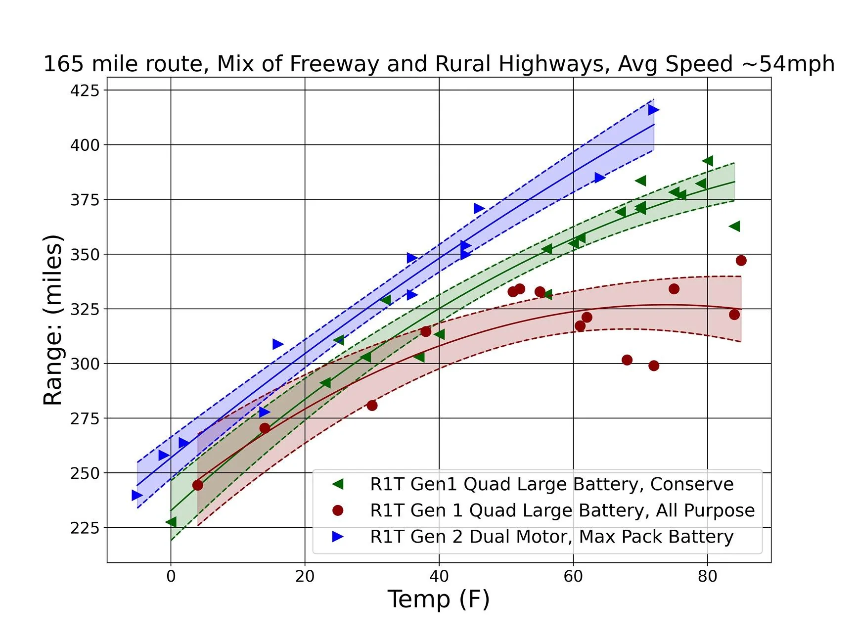

I've been a bit puzzled over that too. The Gen 1 Quad has AP and Conserve modes. I wonder if the EPA is a blend of the two. Gen 2 Dual is essentially always like the conserve mode on a steady speed drive like this. For purposes of clarity, I've only included data where I used the Gen 1 in conserve to compare to Gen 2.
I will add in that my vehicles have the standard Pirelli OEM road tires. 21" on the Gen 1. 22" on Gen 2.
Another note to add. The heat pump on the Gen 2 appears to provide no efficiency benefit.
All purpose data (RED POINTS) included here;

Thank you for posting it again. My first time seeing it. A couple questions about ur graph just so I am interpreting it correctly: 1) what is each data point represent (eg., the first graph, R1T gen 2, you have 11 data pts on the graph, is each point a trip taken at that particular temp for 165 mi)? 2) is your R1T gen 2 data from All-Purpose mode?
Each data point represents the efficiency from one entire trip. I have a vacation home in northern Wisconsin I visit frequently from the Minneapolis area.
The data is the efficiency reported by the Trip A odometer in the Rivian UI at the completion of each 165 mile trip. It is reset to zero when I started each of the trips.
Gen 2 data is the All Purpose mode which means it is running front motor only for the vast majority of the time on a trip like this and would be very similar to the Quad conserve mode.
Good to know! Nice data (coming from a scientist šŸ˜†) demonstrating the singular effect of temp on efficiency. It looks like 60°F+ is optimal for reaching the EPA range/efficiency. I am saving your graph for my own reference.
