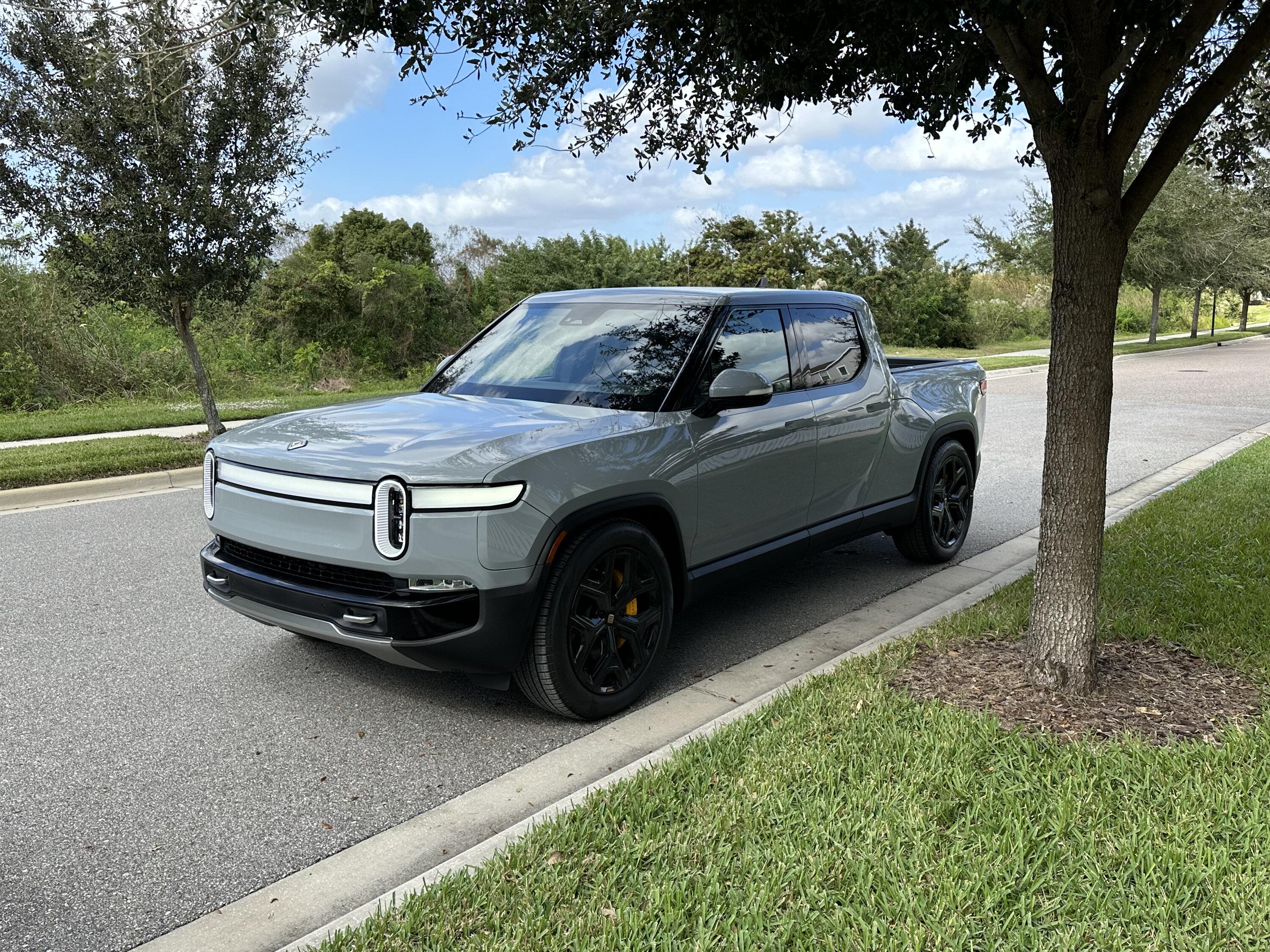

Truck got delivered yesterday (woohoo!) so I've naturally been playing around with everything all weekend. I wanted to see how strong the brakes were so I threw it in neutral and stood on them and to my shock the truck DID NOT want to stop, even with me applying a massive amount of pressure that would normally kick on ABS in another car. My first thought was "does Rivian not bed these brakes?" - So I followed my typical bed in process when I get new brakes and just like that - the truck stops perfectly normal now. Thought i'd pass along this advice because it is borderline dangerous without bedding these brakes in!
Pic of truck because it's awesome.
