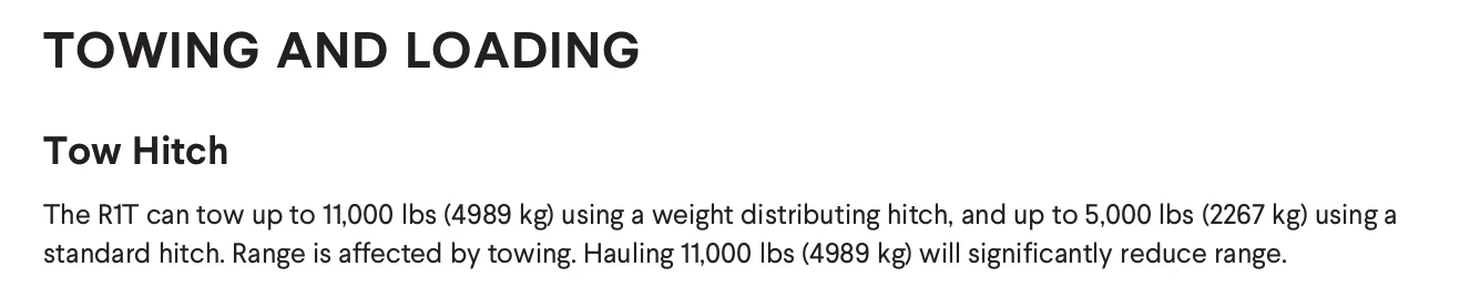

I haven't been able to find this anywhere - is the 11k rating for weight distribution, or straight off the hitch? Many vehicles that advertise 10k+ capacity require weight distribution in the fine print for that number, something we can't do with boat trailers. They are 5-7k off the hitch otherwise. If the R1T can pull an 8500lb boat from the hitch, it will be my next purchase.
Thanks in advance.

And I'm not a towing expert but there appear to be a few weight distribution hitches that are compatible with boat trailers with surge brakes?

Thanks for the information above.
Anf I have yet to find a WD system for my boat as the tongue is too long and narrow. Hence having to get an HD diesel to tow it.
