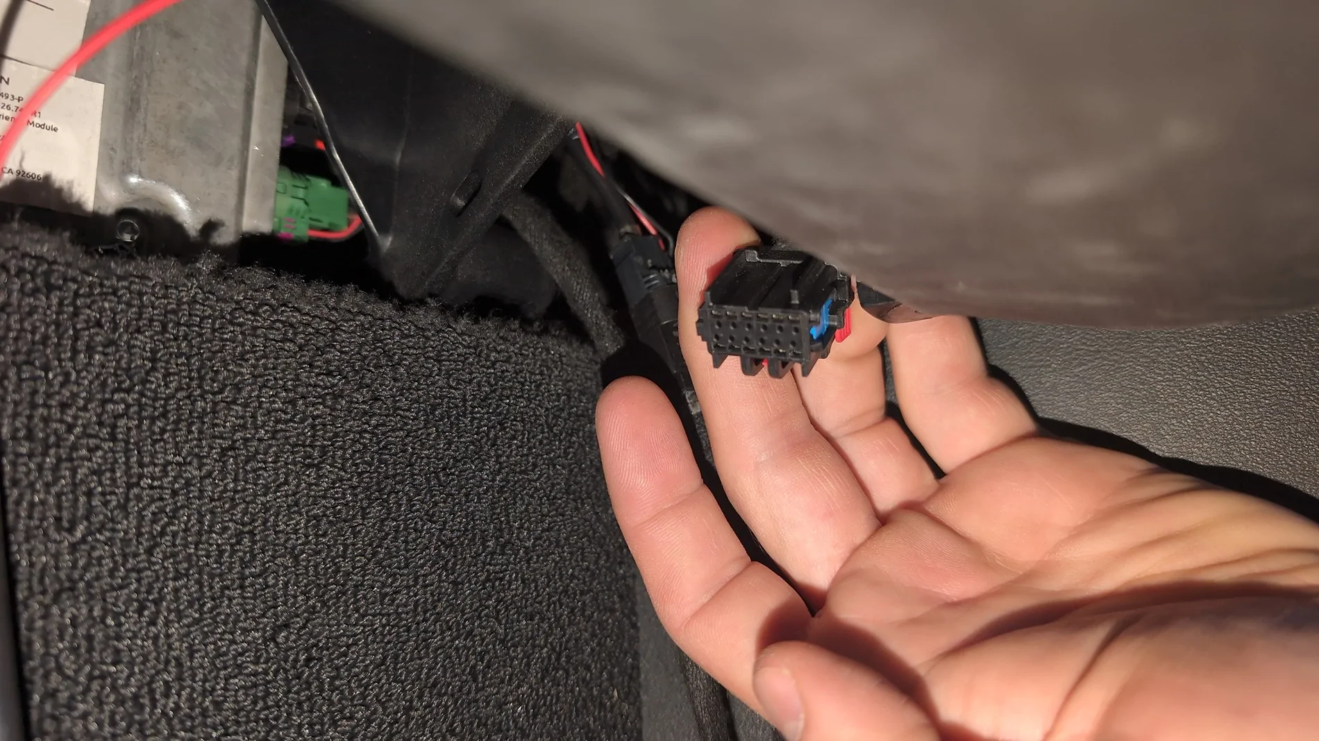

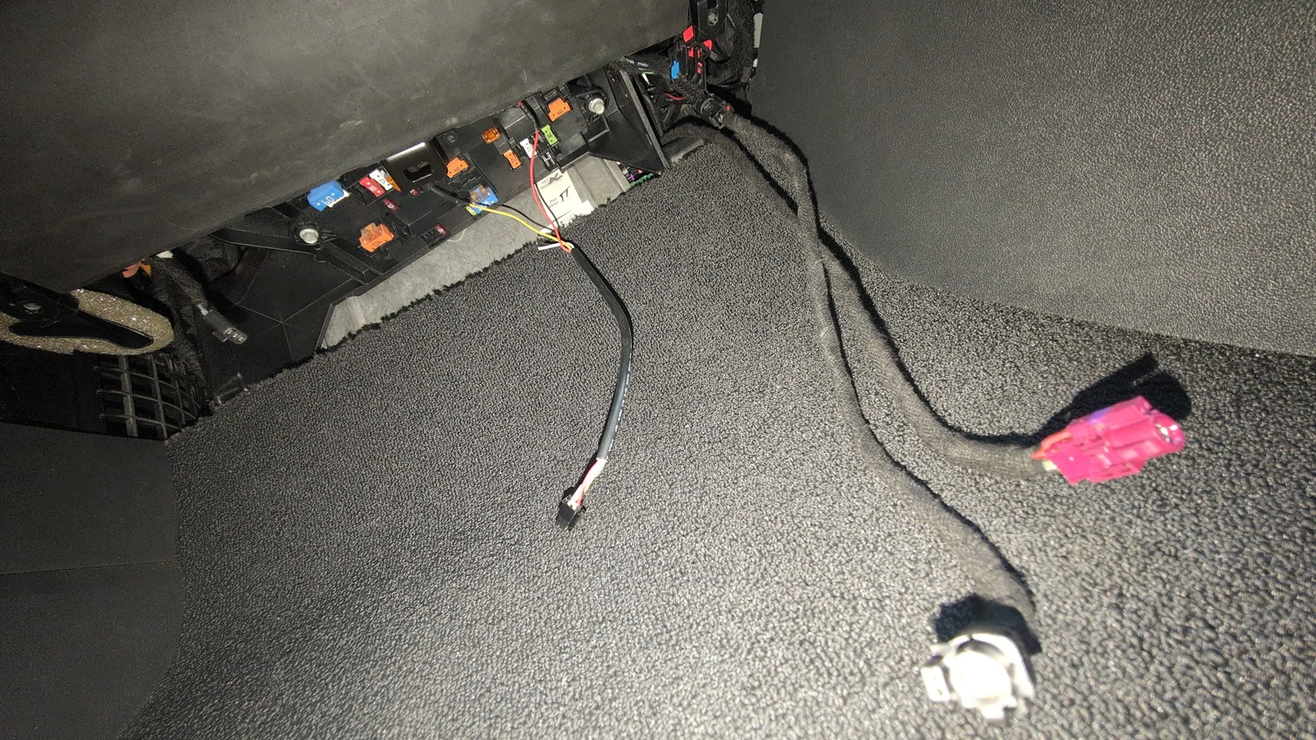

And can someone help me with these wire connectors under the Passanger fusebox. I'm assuming something for the center console is disconnected.

OK, this is weird.
I think you bought my totaled R1T, Nanuq.
VIN 7FCTGBAA5PN028668
I recognize those connectors as from the EV Play device I had installed. I pulled this before surrendering the vehicle. This explains the center console not coming up because it is not plugged in.
The round cable plugs into to connector at the left side of the passenger footwell. The multi-pin connector is a spare, normally not connected to anything. The other wires into the fuse panel are a tap and can be removed.
If it is Nanuq, let me know. I have the panel covering the fuse box. It was at home when we were hit.
