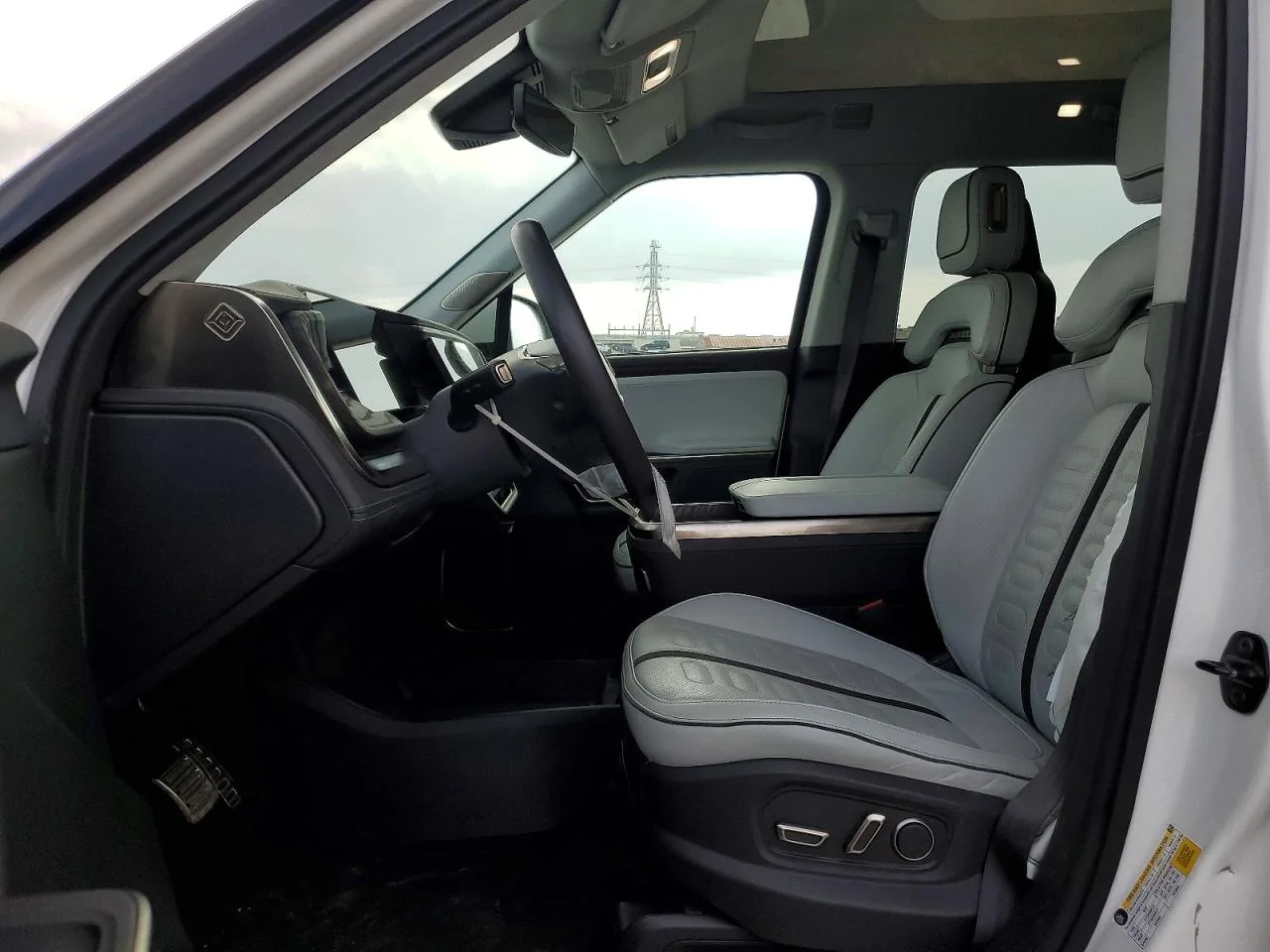

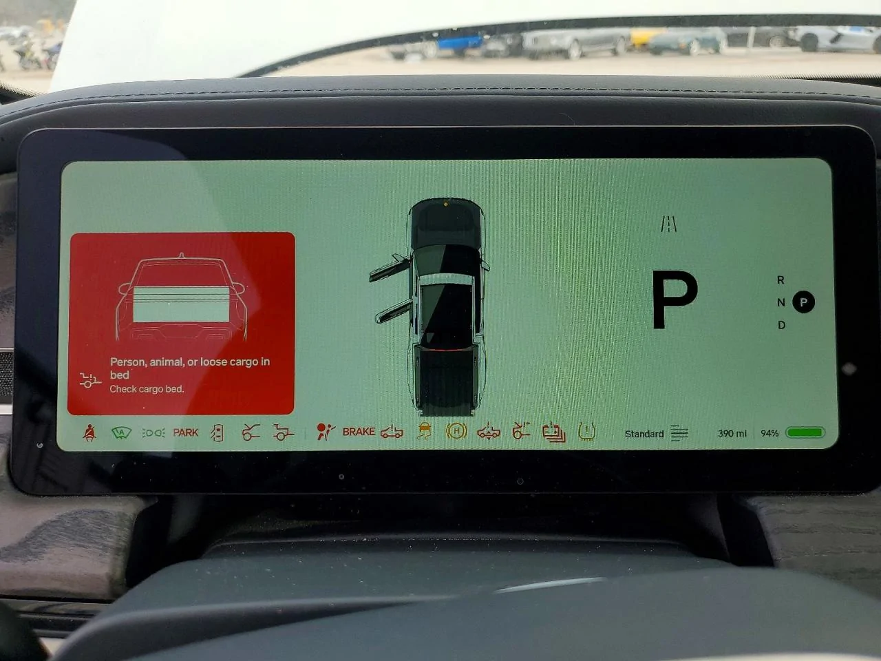

This is the picture from the auction listing. Again, I'll know more once I receive the vehicle tomorrow. It could be that the airbag didn't really deploy, because it's not fully visible on the other photo. I'm just guessing that it did bc the center console is dead. It could be that it has other issues, but I'm keeping my fingers crossed.
Rivian R1T R1S How to tow a Salvage R1T 78321685_Image_9
I'm assuming that the white paper looking thing next to the seat is the airbag, but it's hard to tell.
