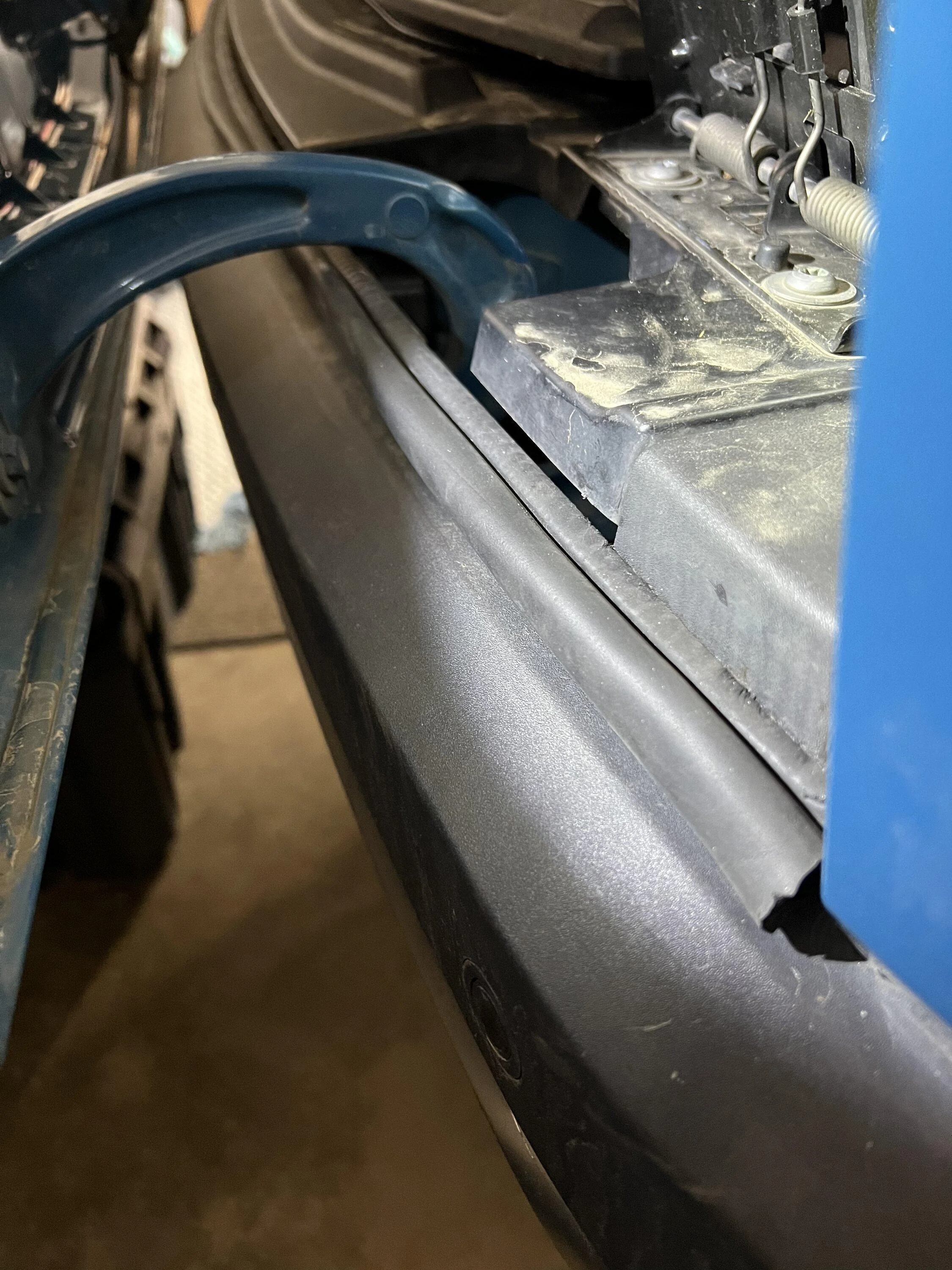

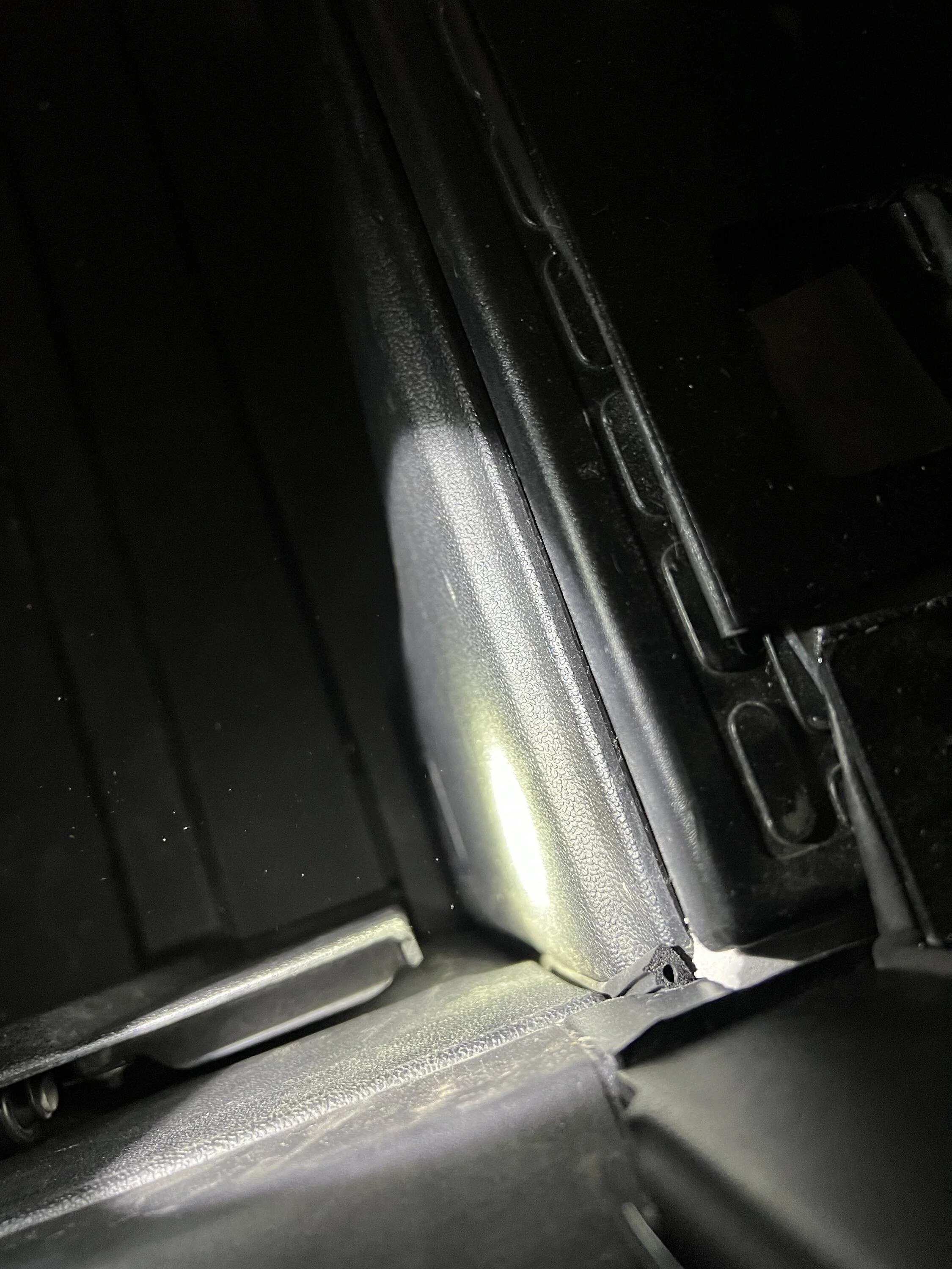

Hey all, So with my shell on I finally wanted to tackle the issue of dust/snow coming in around the tailgate (previously under the tonneau cover).
Parts + Tools
Standard auto/marine seal 5/16”X19/32” at Lowes - $12
0.59”x0.9” Rubber U Channel Bulb trim seal 5’ - Amazon $13
Scissors

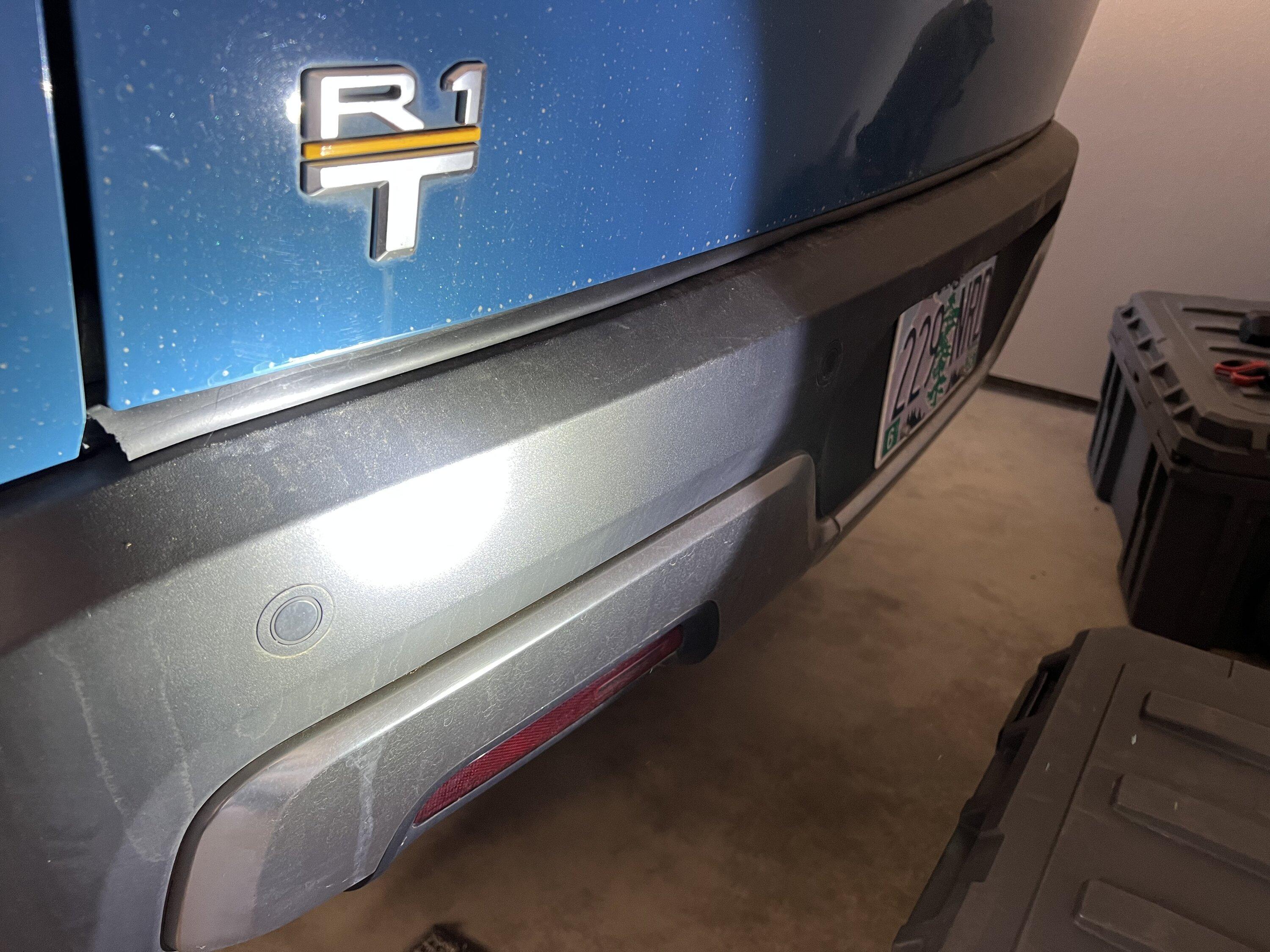

I used the U Channel attaching It to the trim of the truck below the bottom of the tailgate. I had to cut about 3-4” off.

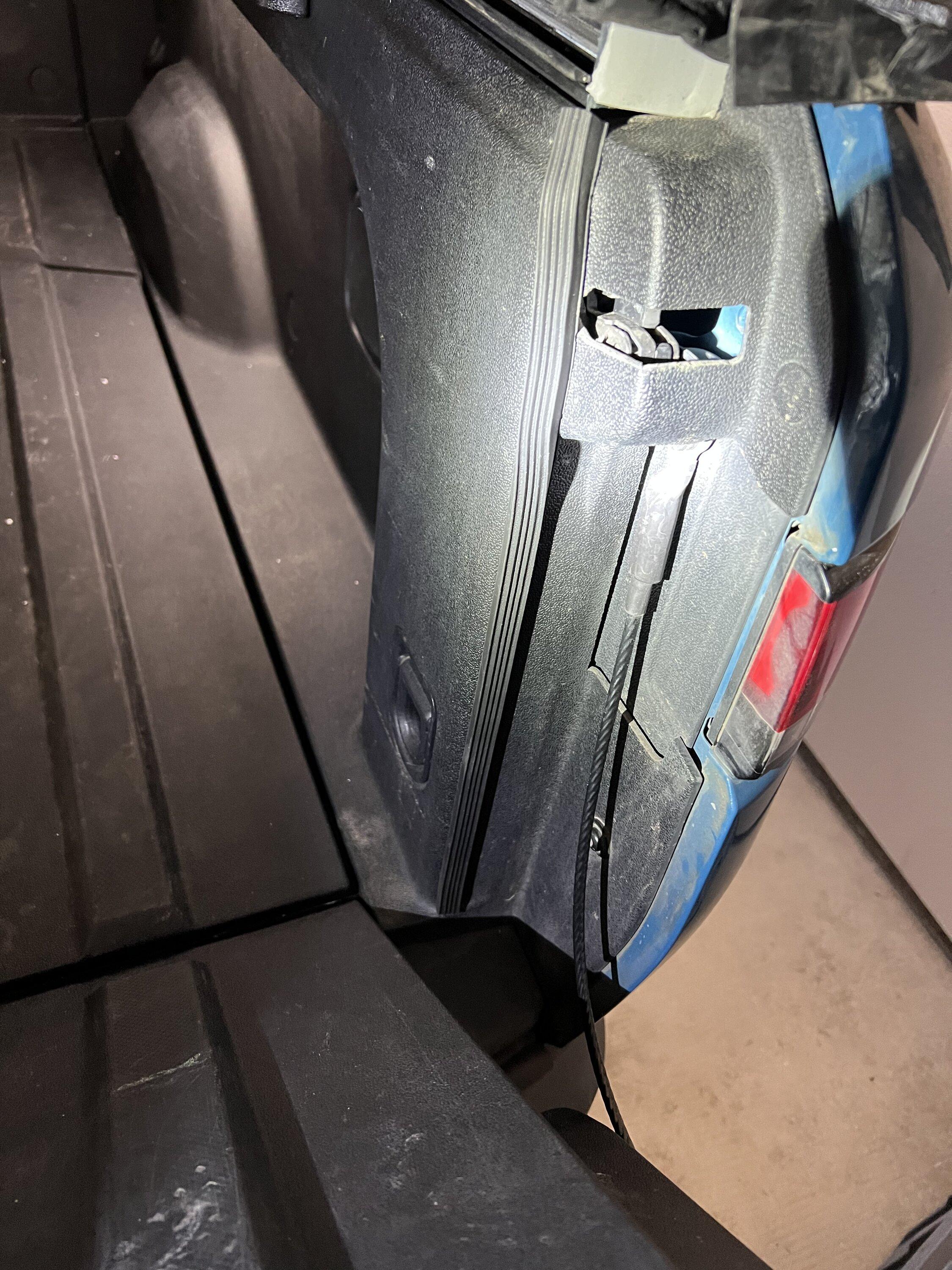

I used the the 5/16” between the sides attaching it along the seam on either side. (Not sure how well this will hold up but I will carry extra to cut to size if needed for now)
Next up I need to seal the area below the spare tire compartment door outside of the seal. The 5/16” didn’t really appear to work so will think about that area if the dust is still an issue.
3 Month Update: Still getting dust in my bed, some of it may be coming around my camper doors but I don’t think my tailgate is sealed either. Will update if I figure out a better/improved approach.

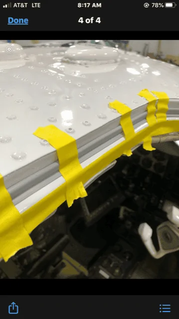

A correct seal design will be a P shape and will attach in the channel of the tailgate lip , unseen.
I mfg two types of this Rain seal for two different door sizes , grey silicone aerospace.
I will attach and post pics after installing
here is a pic of the seal , this is used on aircraft with inflatable door seals , when aircraft is static / not inflated ,this keeps water from entering cockpit door .
stay tuned
