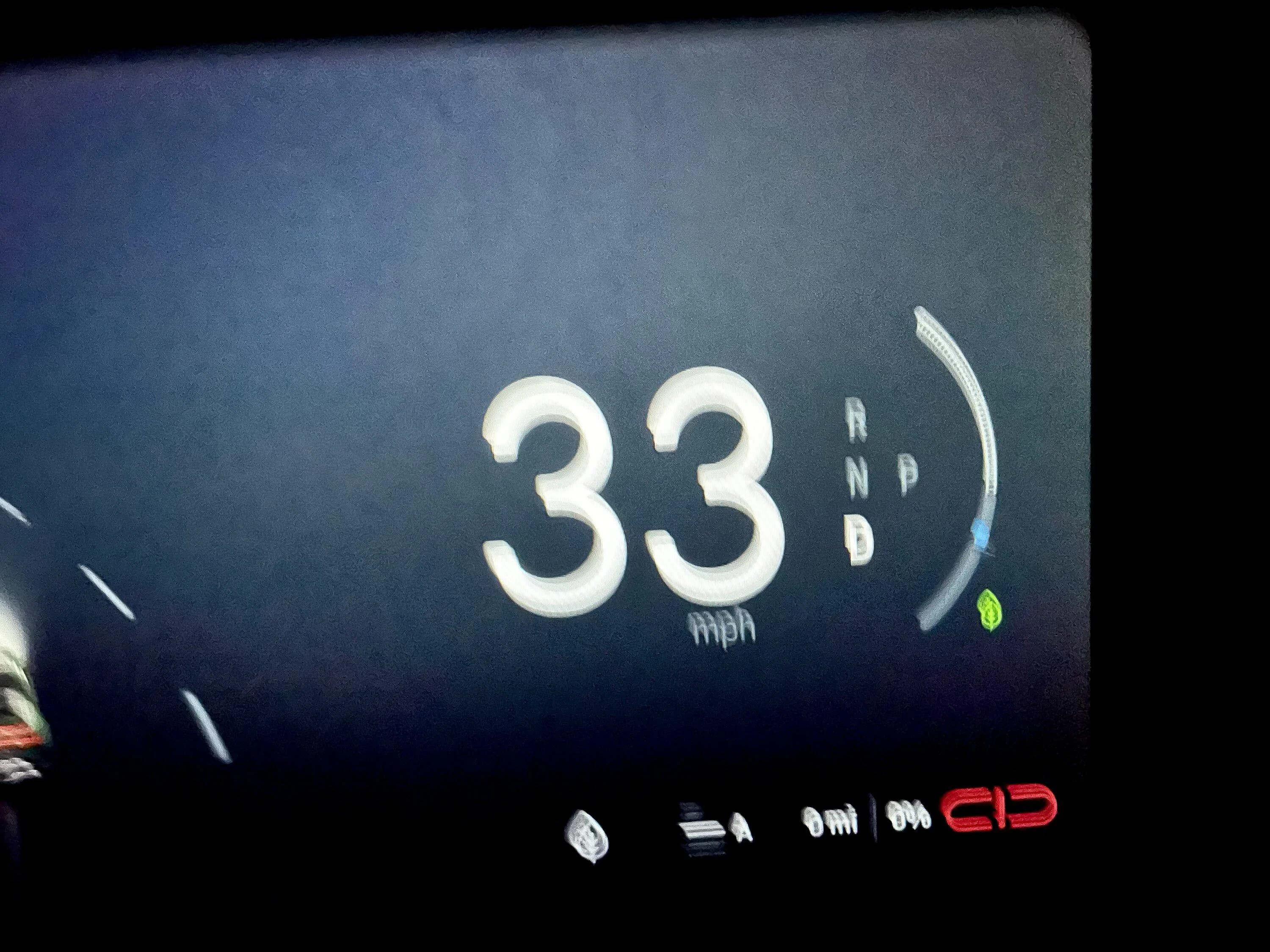

and I was doing about 72
Rivian R1T R1S Got down to zero range remaining. Is there a “buffer” reserve after 0 miles of range? IMG_20230414_000307
You're knowingly getting that close to zero (yes, 10 is close to zero) and you're keeping your speed that high?
It's all about air resistance, y'all. I went 70 in a 70 for most of my trip today, through a mountain pass, and gained 3 miles from the original estimate.
SPEEDING KILLS (your efficiency)
