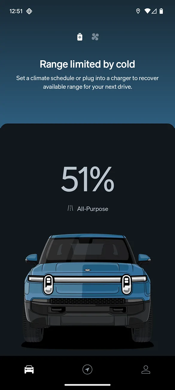

Has anyone gotten a notification yet with the new update that preemptively warned about range impacted by cold weather?
Nope and i’ve had it since thursday with 5 degree temps…lots of snow too.
Ditto. Including trip to the mountain this weekend.
It showed up for me today for the first time:
Rivian R1T R1S 2024.51.02 Update installing now Screenshot_20250210-125113
At lunch the battery was 32* so I tried manually starting climate conditioning and after 30 minutes the cabin was warm but the battery and motor temps did not budge. Given the text in the screen shot I didn't expect this to work but I don't drive on a regular schedule and wanted to try it.
I set a climate schedule for 3:30pm so we'll see how that goes. Currently unplugged.
My battery and motor temps actually went down from 32 to 26 between climate conditioning over lunch and my scheduled preconditioning for a 3:30pm departure. Im gonna charge up a bit and try to schedule preconditioning while plugged in the morning, but I don't expect it to work any better.
  • Improved thermal system behavior in cold weather.
Has anyone noticed any change since the hotfix? Maybe I need to try a hard reset. Maybe I'm reading into this line item too much?
