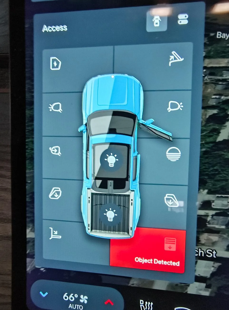

  3. The powered tonneau cover stopped working. Performing the tonneau reset procedure (press, press, press, hold) fixed it.

For your tonneau cover, perform the tonneau reset procedure. Click, click, click, hold. It should fully open and then close.
Good morning! I got the same error since the update. Tried the three-click and hold. (I do not have a key fob) using the tailgate button. Can hear the servo clicking but to nada. I rebooted the truck (press and hold the outer most steering wheel buttons for 15 seconds) and then repeated the 3-clicks and hold, and that cleared it! Though the cover made a lot of popping sounds as it opened and closed.
Also note: It's 3 very FAST clicks on the cover button, then a long hold.
