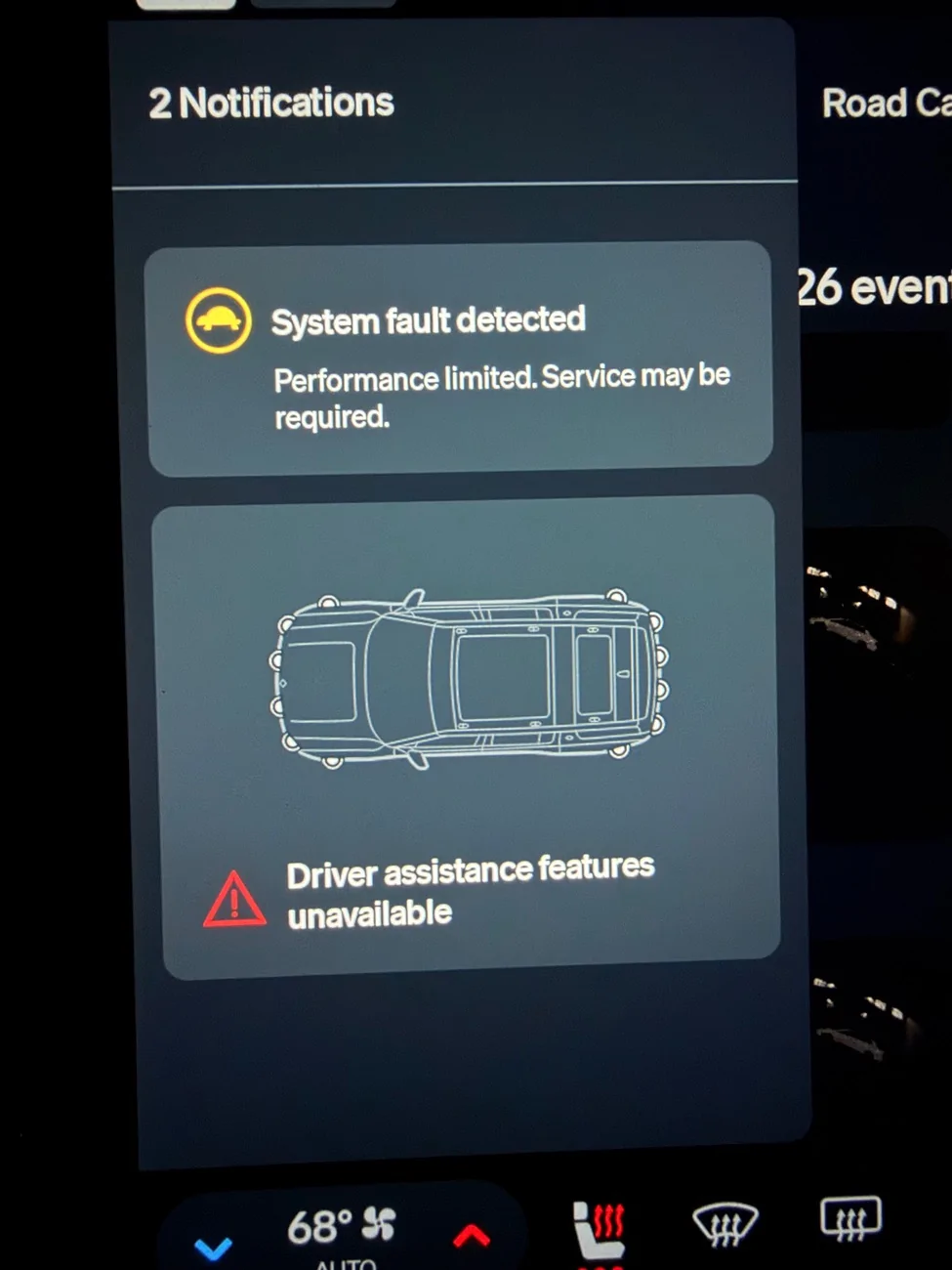

So that’s fun. 24 hours after installing the “patch” 2025.46.30
Rivian R1T R1S 2025.46 Update (Release Notes). OTA pushing out now! IMG_1676
Hard reset fixed it… hopefully for good. Anyone else experiencing this?
Of course hard to know if this is independently random or a side effect of the update.
I would have tended to just drive it and see if it resets next day without the manual reboot.
I would’ve as well. But it was in turtle mode… with the drivers safety system off
Hopefully it’s a one off. But submitted service request with the diagnostic timestamp.
