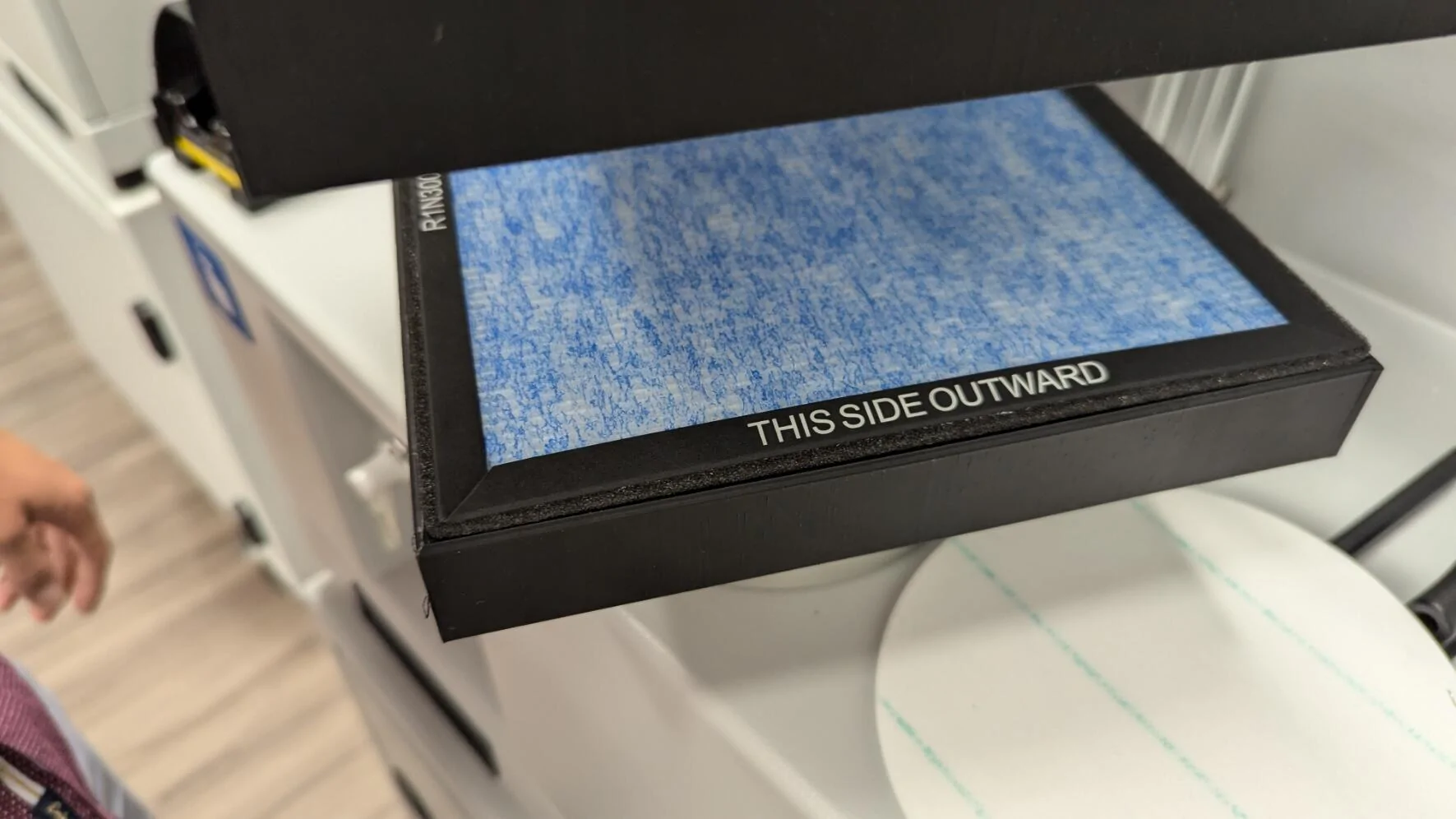

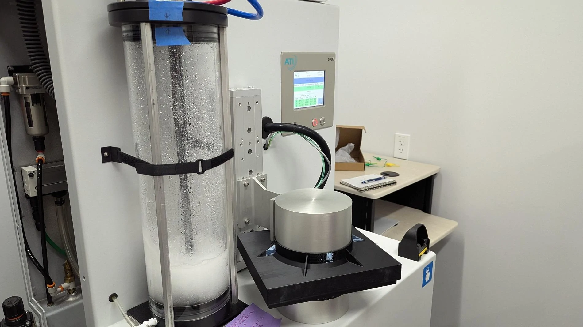

The equipment: I have access to ATI’s 100X Automated Filter Tester which is certified and compliant with NIOSH 42 CFR Part 84, ISO 23328, GB 2626, JICOSH/JMOL, GB 19083, GB/T 32610, YY0469, YY 0469, EN 12941/12942, EN 143/EN 149, ASTM F3502-21, ASTM F2100-23, and our company is in the process of certifying for ISO 17025 compliance.
The 100XS we used tests at the Count Median Diameter (CMD) of 0.075 μm ± 0.02, with a Geometric Standard Deviation (GSD) of ≤ 1.86, with typical concentrations between 15 and 25 mg/m3. Our challenge aerosol of choice was Salt (NaCl) solution with a flow accuracy to ± 0.4% of reading, plus ± 0.2% full scale. Aerosol detection specifications are as follows: Dynamic Range 0.1 μg/m³ to >200 mg/m³, accurate to ± 1% of reading; Penetration 0.0005%; Efficiency 99.9995%. Our unit and all the reagents, components, and supporting equipment comply to the most recent published and ratified standards and certifications as validated by third party lab testing for: CE, RoHS, FCC, and CSA.
Generally, this test equipment is provisioned for use with Flat sheet Filter media, Filtering Face pieces, Medical Device filters, and PAPR filters of all types and geometries including HEPA and ULPA grade and electret media. Typical industry use case of this equipment is to test and quality control validate filter media, cartridges, and industrial hygiene applications.
We used our standard automatic [filter media holder] chuck outfitted with a custom adapter that was designed to fit the geometric size of Rivian’s designated cabin filter cartridge location. To note: the orientation of measurement is relatively oriented orthogonal to the mounting of Rivian’s air collection, but would maintain the same fluid path, nonetheless. Also to note: the test fixture was developed to seal along the topmost boundary edges of the filters, which should mimic the intended sealing surfaces of Rivian’s air intake design.

Relevant images of test setup here:
Rivian R1T R1S Rivian Cabin Filter Performance (OEM vs Aftermarket) Engineering Analysis - Impartial 3rd Party Review 1729707438058-h0
Rivian R1T R1S Rivian Cabin Filter Performance (OEM vs Aftermarket) Engineering Analysis - Impartial 3rd Party Review 1729707450658-iu

The following is based on the testing and test setup using an ATI 100XS configured Automated Filter Leak Tester and input and expertise of our Applications and Field Engineering team.

  • Rivian OEM (Mann) air filter does not appear to have been engineered to seal on all 4 sides of its perimeter (you can see this based on the ā€˜fuzzy’ gasket manufactured into the edge of the filter housing). It’s also very concerning, and notable to our AE that the outer edge is not rigid. Best practice when developing filters is to have a hard boundary edge that can seal against a mating surface.
    This could be overcome with appropriate gasketing on the cartridge (or installation provision) of the air handling equipment. As far as we could tell, no such provision is made. We could be wrong, but in our opinion, Rivian’s OE filter, when installed properly, is likely to leak. And as can be ascertained from the data, likely leaks more over time.

  • The better performing filters fit compliantly (read: more snugly/ tightly installed) into the test fixture (and the Rivian Filter Cartridge/Tray).
  • It’s possible that a ā€˜looser’ test fixture may result in a better OE performance filter, as it may have prevented some distortion on the outward edge of the Mann filter. It’s very difficult to tell, as I don’t have the exact geometry Rivian was using and didn’t tear the Cabin Filter Cartridge/Tray out of the truck to get more accurate geometry. The test fixture was developed by measuring all the filters themselves and determining a best-practice path forward to incorporating it into our test setup.
