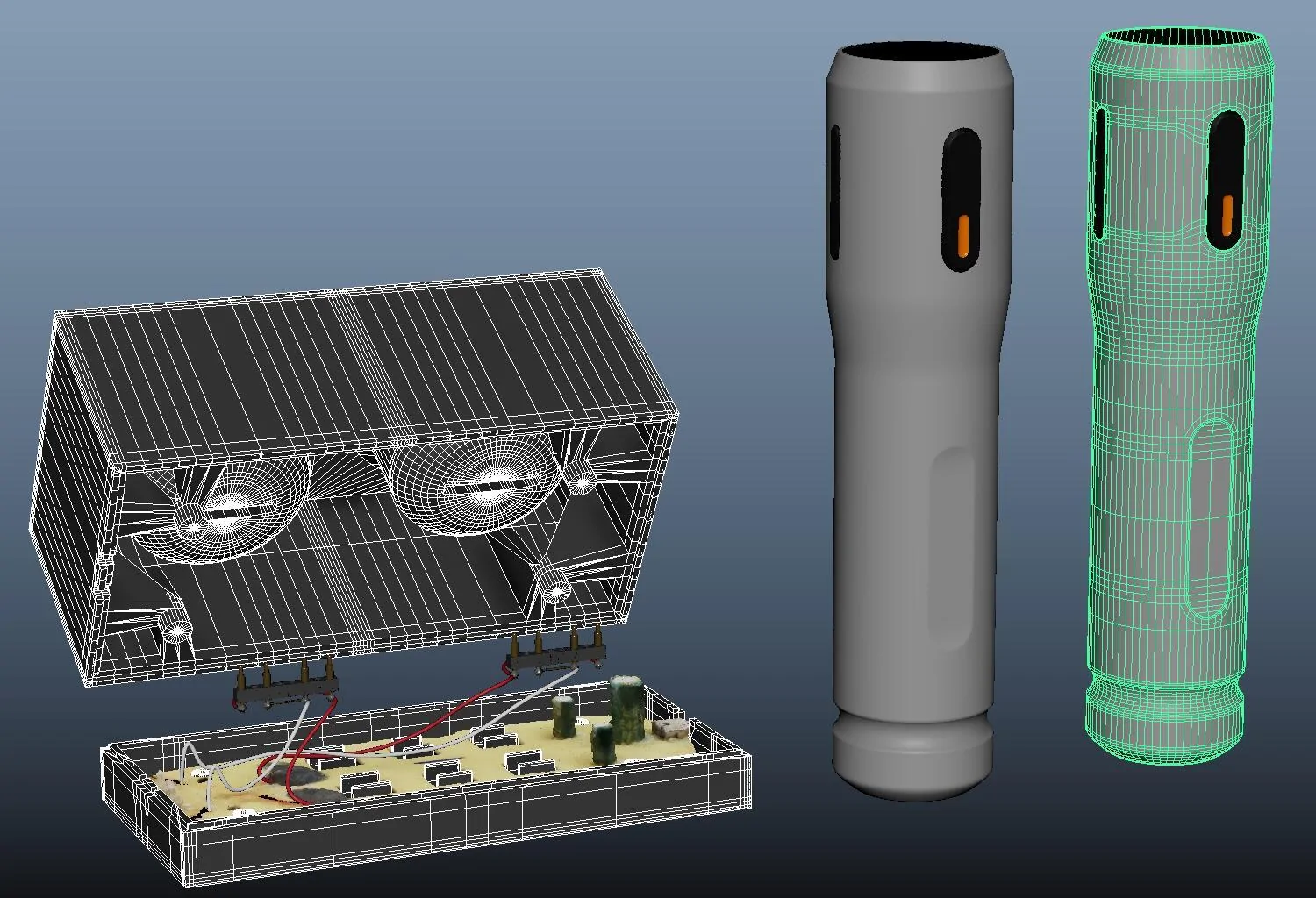

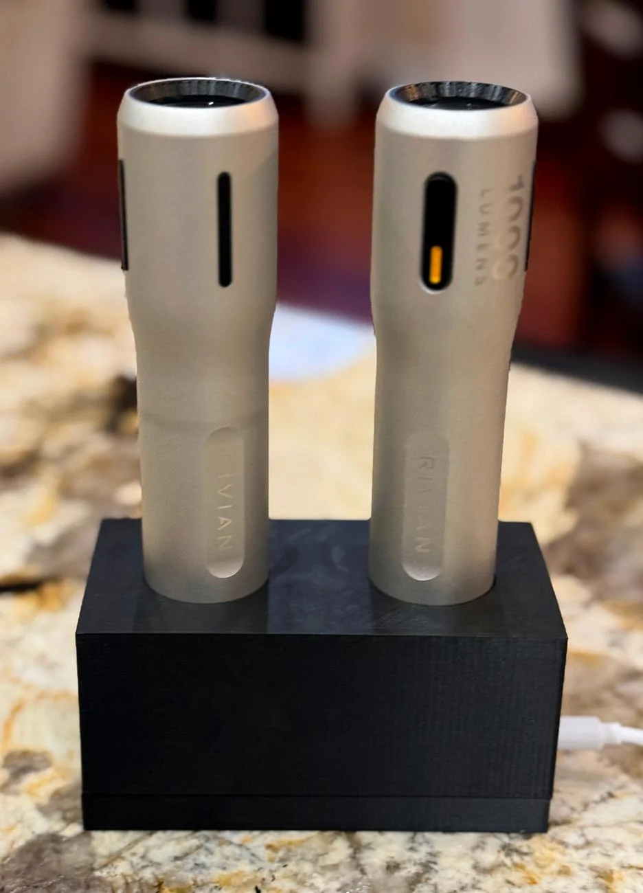

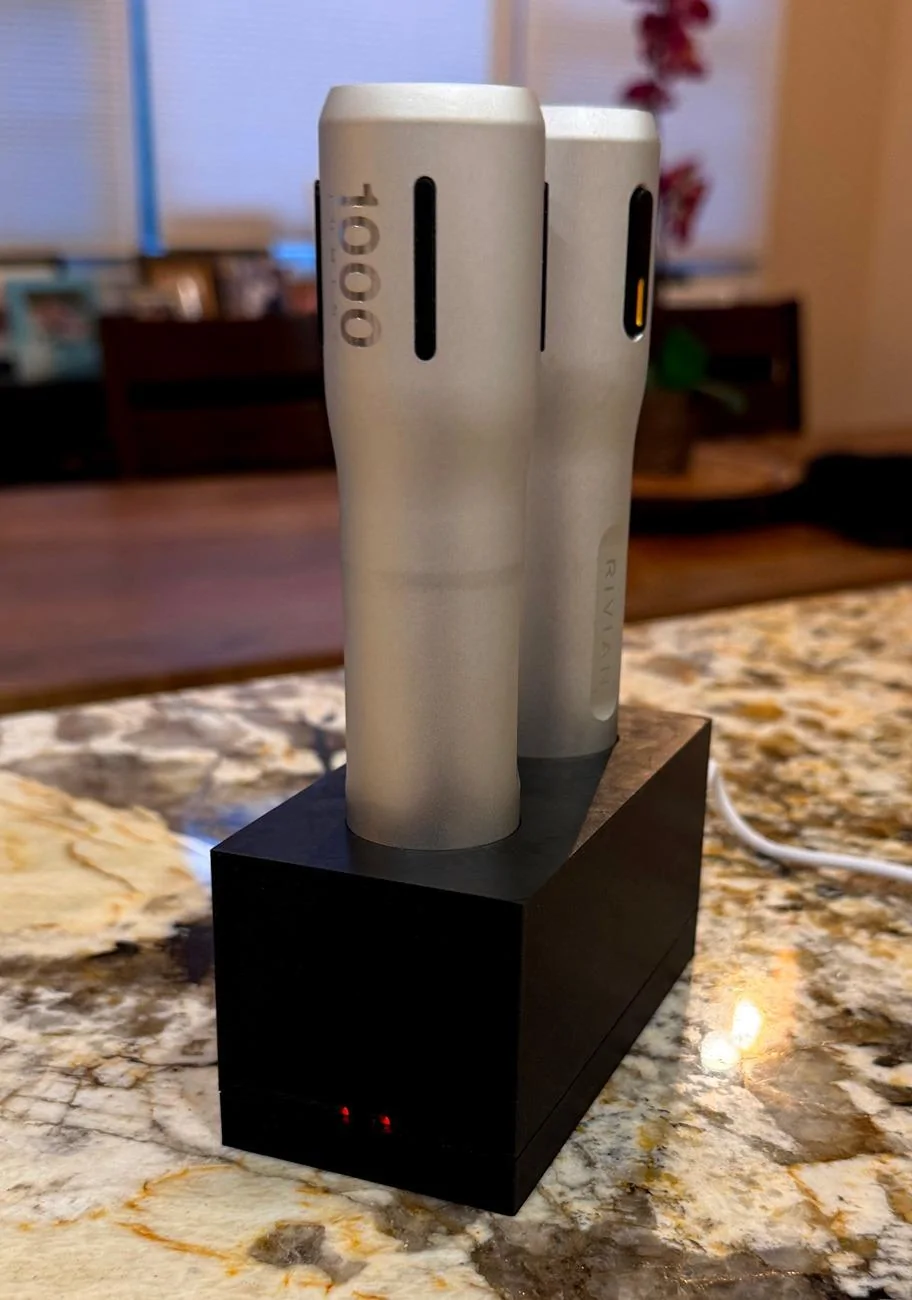

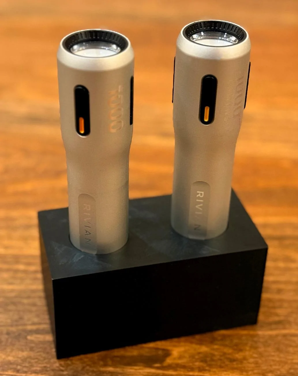

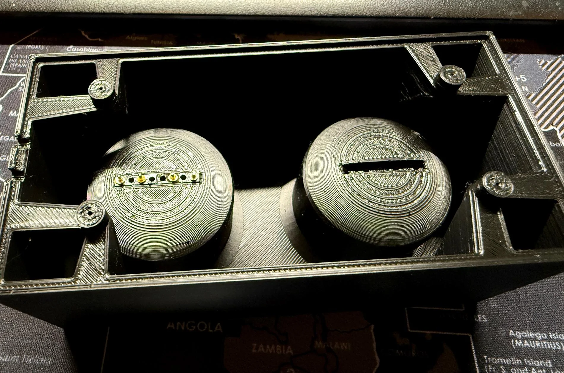

I got tired of looking for a solution and asking site sponsors, so I made my own Dual Rivian Torch charger for less than $20 in parts and some 3D design and print.
STL files are available here:
https://www.printables.com/model/1090018-rivian-dual-torch-dekstop-charger
Rivian R1T R1S DIY Rivian Torch (flashlight) Dual Desktop Charger parts

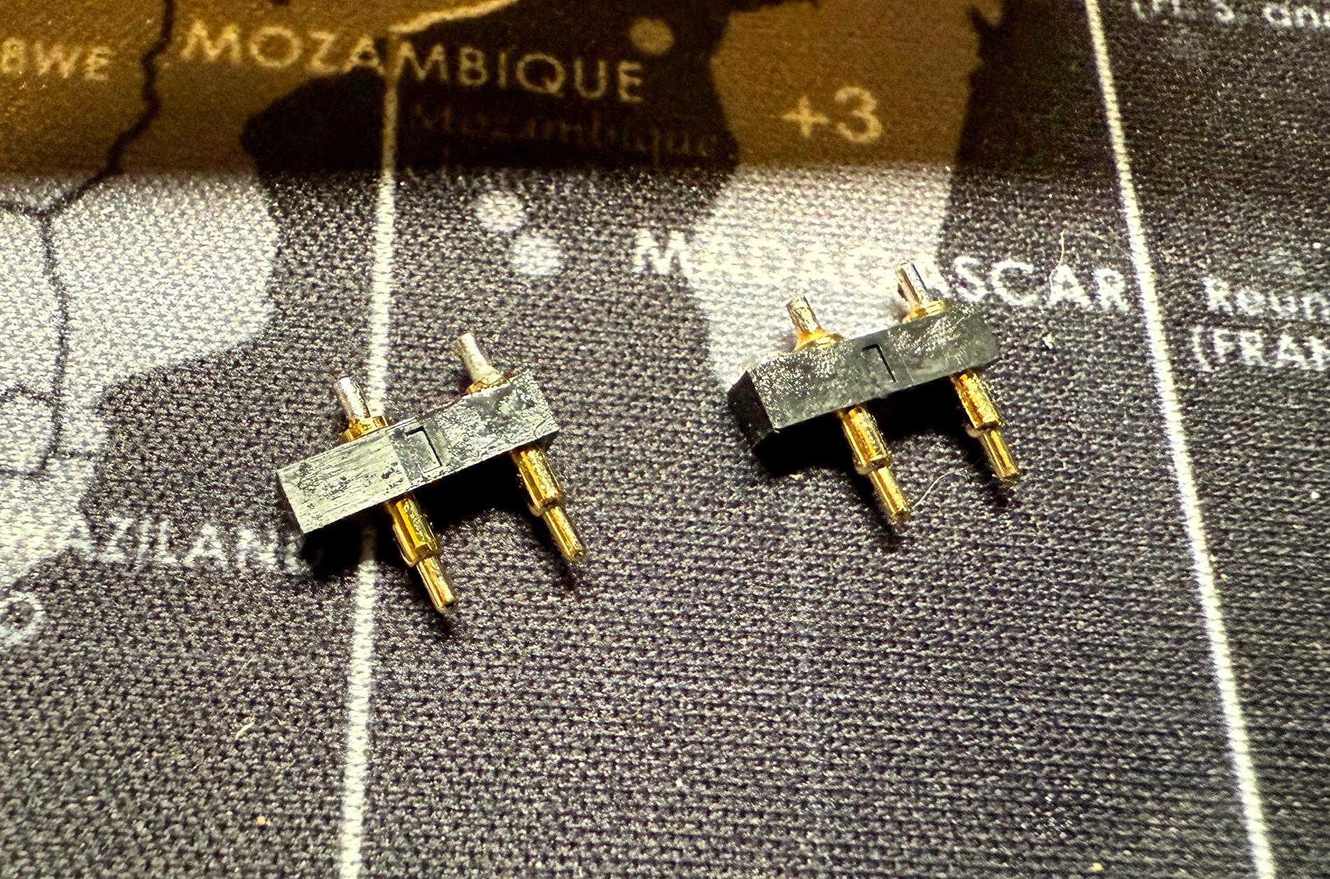

I 3D scanned and modeled the torch and the circuit board from the battery charger. I then built the charger around them.
Rivian R1T R1S DIY Rivian Torch (flashlight) Dual Desktop Charger 1732982578358-sj
After a couple of 3D test prints, the final prints took 9 hours.

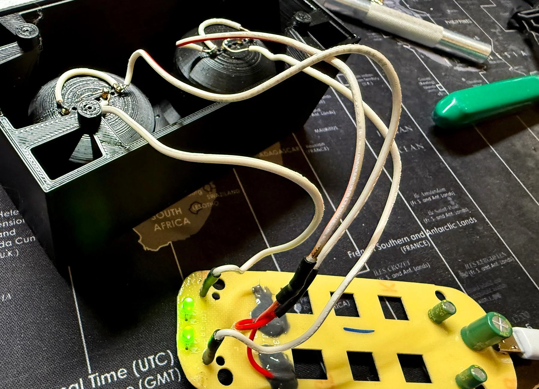

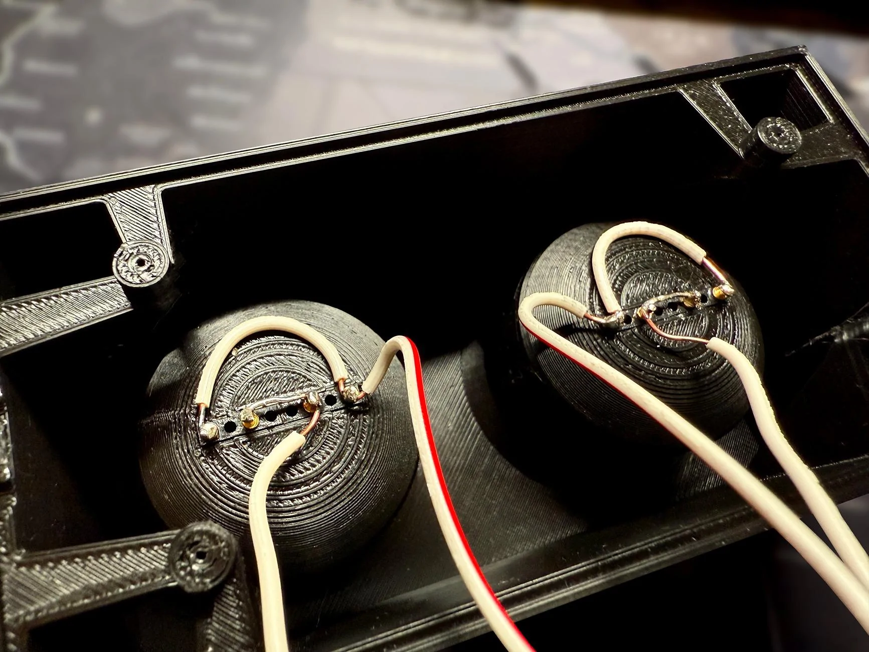

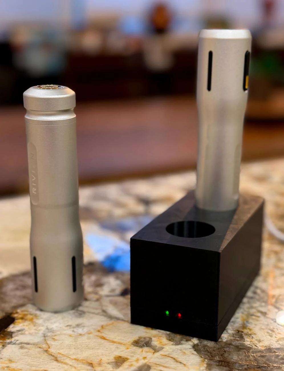

Final assembly.

That turned out great. Nice job!

So the ring terminal on the flashlight, are just direct connection to the battery for charging? I have a usb to 18650 battery charger chip I wonder if I can use that instead.
Should work. The battery is in a plastic enclosure and the outside contacts connect directly to the battery.
