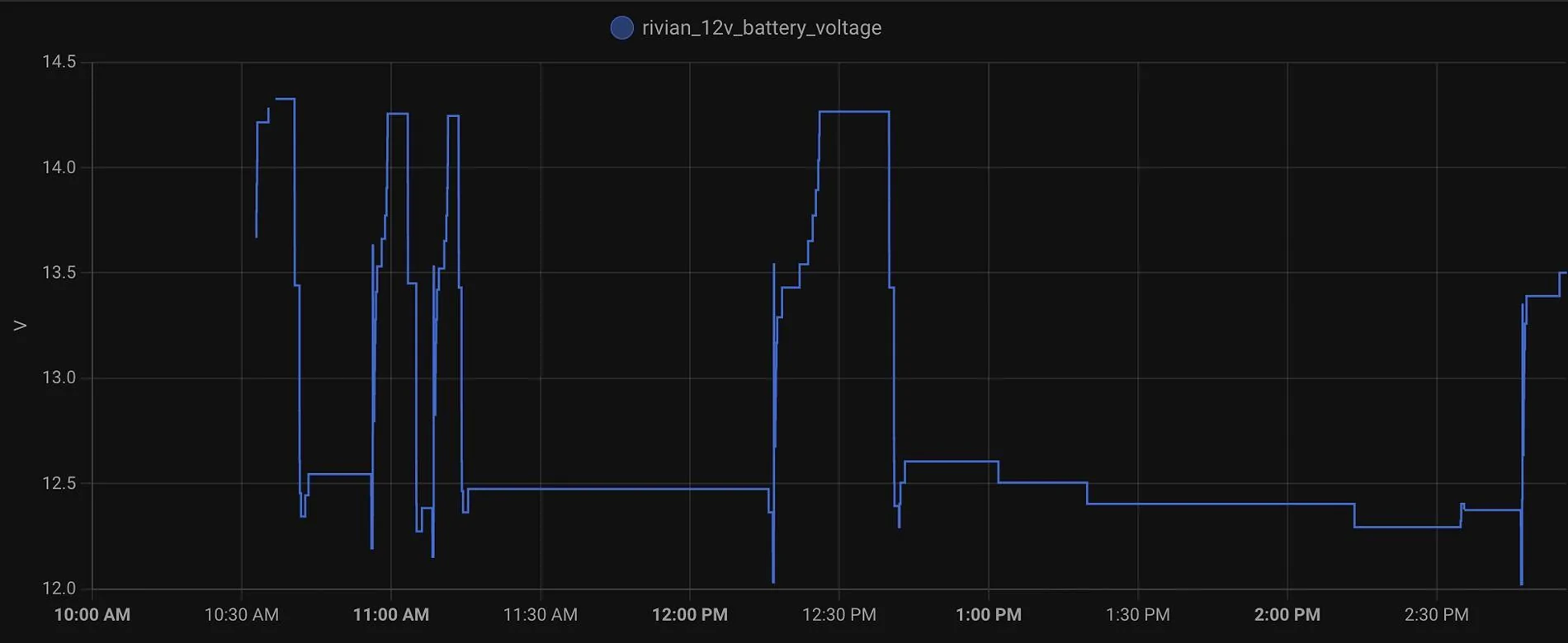

Here is the voltage of 12V and thresholds when charging is kicking in:
Amazing! What I'm seeing there is that sometimes does 12.5, sometimes 12.6/12.7v... Interesting... :)
